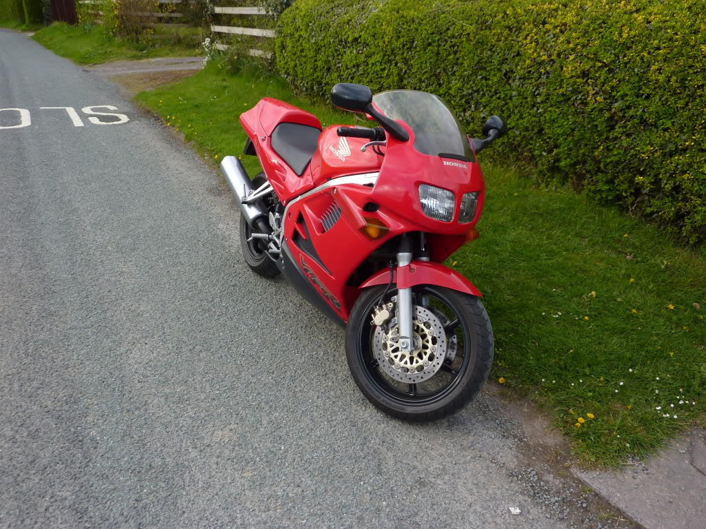

Here it is just after I bought it last year...
https://www.bikechatforums.com/files/p1000130.jpg
It's a '96 VFR750, at the time of that photo it had just shy of 25,000 miles on the clock, now it's a trip in to town short of 30k. It is a very tidy looking machine, but don't let that fool you, it does have history. There's dinks in the frame from where the foot pegs have hit when it's been dropped on both sides and if you look again at the photo, you'll see that the tank has a slightly orange tinge compared to the rest of the bike, the right hand bit of the fairing leading back from the indicator has also been resprayed. From other bits of touched up paint on the metalwork, it's obvious that it's also been reasonably well looked after. It's a very good machine for it's age. Even 'interesting' with the performance modifications done to it by the first owner.

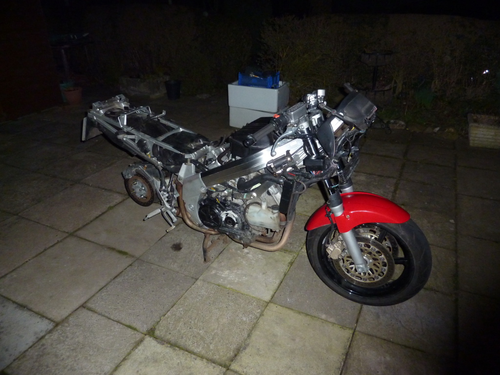

This evening, it looks like this...
https://www.bikechatforums.com/files/p10003851.jpg
Almost as stripped as I want it, the front mudguard still has to come off but I need a smaller 8mm socket to undo the brake link pipe bolt, the one I have is too large to fit into the space available. The exhaust clamp was seized solid so I got some oil on it, got the blow torch on it and managed to free one of the bolts which was just enough to get the pipe off. The other bolt will be dealt with in due time, both will be replaced.
Stripping the bikes down like this isn't just for cleaning and touching up paint, it's also a good way to check for any faults. An especially good thing to do on bikes with fairings as those plastics can hide a multitude of sins. Regular strip downs also save you money in the long run as you deal with problems before they really become a problem and will certainly make your bike last far longer than it might otherwise do... That's how my formerly badly abused GT550 got to 172k miles. It's only when I got lazy and let it rot that it died.
