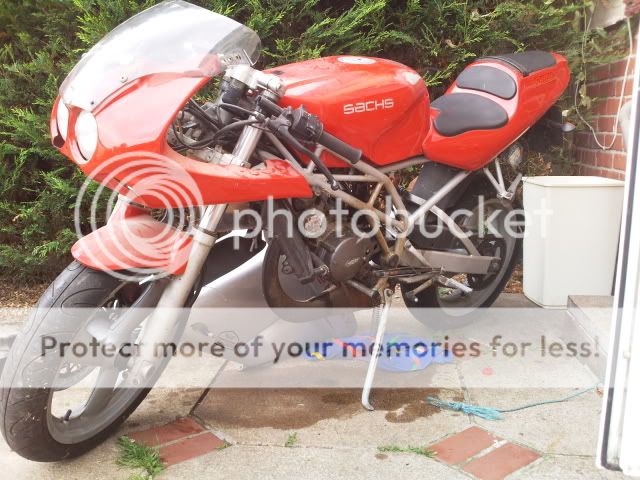

I got this for free of a family member, It doesn't run currently but there is a couple of weeks till my CBT training to sort that.
It's a little tatty too thanks to a leaking shed.

Critisism (SP)? Razz

Is petrol getting as far as the sparkplug?
With a bike like that (rare as buggery, no parts to speak of) I'd be tempted to get it going, and then sell it for as much as you can get. While owning a rare bike is deeply cool, owning a rare bike with no available parts is just hassle in the extreme, in my opinion.
Also, what happened to the fairing at the bottom? It looks like it's been twisted outward, or something.

The fairing was attacked by the heat from the exhaust as some point, and it's just bent inward. I'm buying a fairing kit for it from Egay so that's not a problem.
