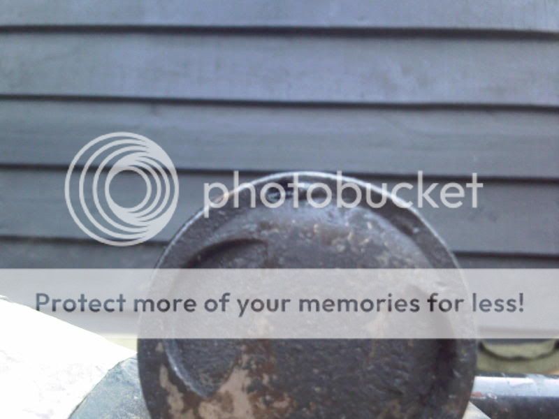

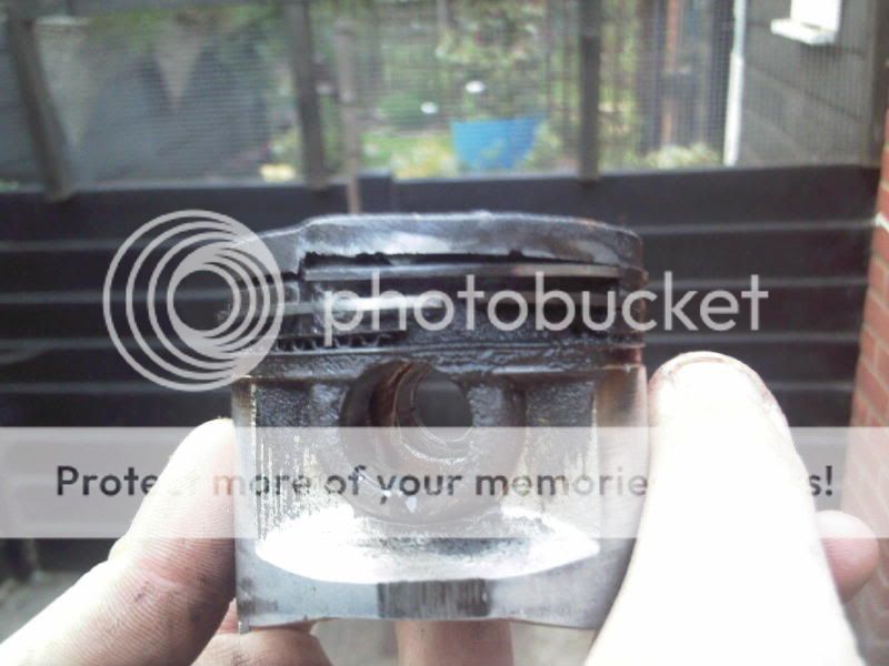

either way there was a hole in the piston as if somebody had taken an oxy-acetaline torch to it XD just happened that there was no oil in it. as promised here some pics, see if anyone can identify why it has no compression Very Happy

I think it was because the number plate was damaged, i can get one for £5.99 so will replace it. I'll take pics tonight and post them up asap. does anyone have a rough idea why the piston has been damaged like this? the bore is fine, if a little oily. could this have resulted from the previous owner not running the new top end in properly?

Are you sure the barrel isnt damaged or scored at all?
If not your lucky very lucky i'd even put the lottery on lol, Could of been caused by detonation or over heating, your bike has points ignition doesnt it? might need adjusting to get it running again.

LOL bog roll is great for cleaning up oil, I've yet to check the barrel out but when i gave it a quick look it seemed fine, if not then its time to big bore it Twisted Evil

Already seen that one lol, I'd been reading up on things before I saw it and that article just made it clear about the CBX550 piston having a domed top.
Turns out that after a quick hone the barrel was fine, had one very light mark that we couldnt get out. £41 later and i had it all back together, nicked the red bike tank cos it had petrol and it fired up after a few kicks Thumbs Up anyone want an '89 CG125 then? going for a good price Wink
