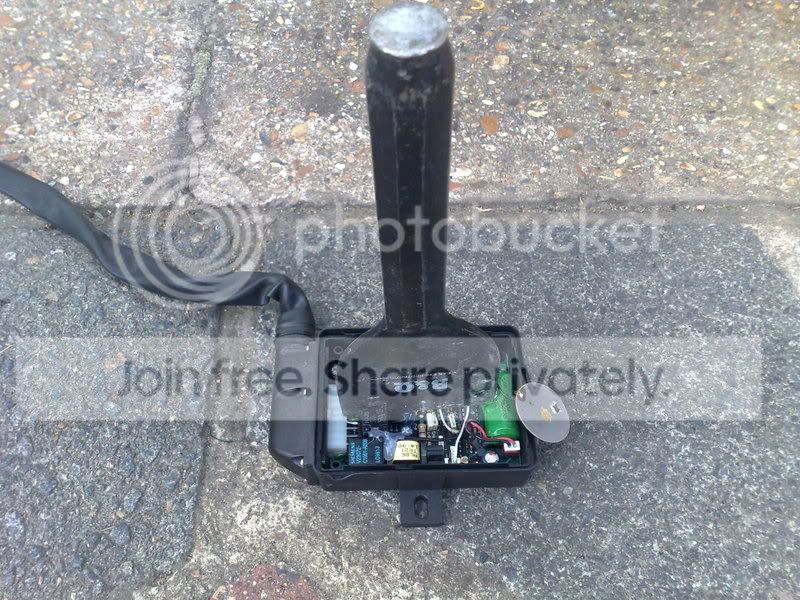

I don't know about Datatool but a Spyball comes out easily enough. Just remember to pearce it's black hart.
https://img.photobucket.com/albums/v295/chris-red/18102008036.jpg
LOL, was that for fun or just to shut the damn thing up !
