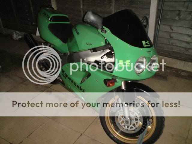

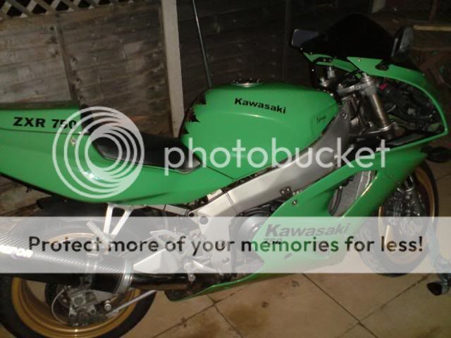

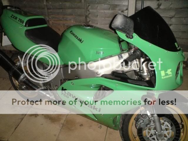

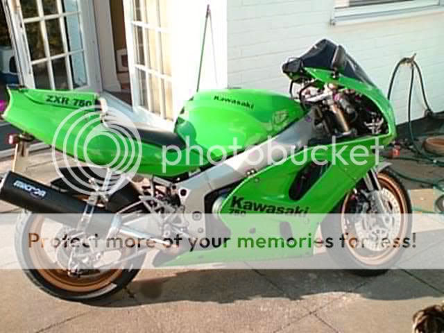

hi, ive been looking at this forum for a while and thought id make a post. ive been riding for 5 years now, on harleys for the last 3, but had to get rid ude to finances! so after 8 months without a bike, i got the urge again and decided to go out and get a kwacker zxr750l3. i had a j model as my first bike so i knew what i was expecting but this is quick!!! Very Happy its had a respray but i think its tasteful ( i love green kwacks, there faster you know!), micron can, decent tyres, new pads and discs, braided hoses, and all the mots and service history. paid £900 for it. is that a good price, its on an N plate with 23800 miles.
just needs a good clean up under the fairings, the last owner loved wd40 so is everywhere!
only queries ive got are it doesnt like to start when its warm, it fires first time from cold and runs perfect when going but if i stop for 5 mins and try and restart it just spins and doesnt fire. it takes a few attempts with the throttle open to get it going. could it be down to the fuel tank vent or is it more likely to be the carbs? it has only done 400 miles in the last two years so im thinking it might be crap in the carbs, but im not the most technical person going!
anyway, heres a few pics just to show it off, its actually a darker green than in the pics, the flash made it look lighter!
