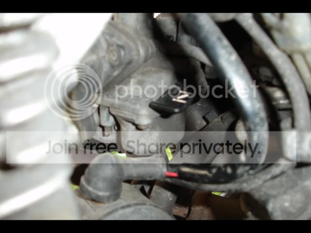

Right, well here's a picture of it, if it helps in any way...
As said before, at 9pm, it idles very low, any bit of throttle and it just cuts out.
When its in the middle, it starts with abit of throttle. When riding, if you open the throttle fully it does blurb and struggle a tiny bit.
at 6pm (all the way down) it starts easily, and revs freely on full throttle.
Any ideas?

Same as the CG;
Full choke for starting
Partial choke for warming up
No choke for normal riding.
Needed to be clearing snow off of the bike before I needed anything other than no choke though.

That carb looks like the same as my pit bike. Up is on, the middle is half and down is off. You should only use full choke for a few minutes then swap to half choke and ride off. After about 5 mins, turn it off and don't use sudden large throttle openings untill it's fully warmed up or else it will just bog down and cut out.
I have to do this every day on my 400. You shouldn't need to use full choke unless it's really cold or the bike has been stood for a while.

I think whats confusing here is that what you are describing above with the choke in the 'off' position is what should happen when it is in the 'on' position.
If the choke is fully on does it rev freely? Because it shouldn't. Smile

the chokes on these sort of carbs are basicly just a big flap, imagine trying to rev your bike with a hand over the carb and you will get what the choke does.
At nine o'clock the choke will be pretty much verticel with a second flap or hole in the plate, at six o'clock the flap will be pretty much horizontal.
