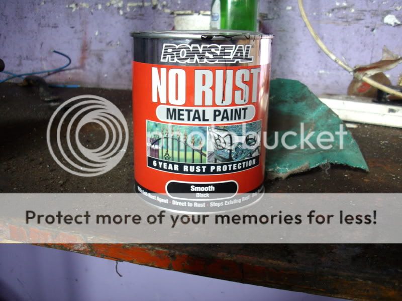

Or the cheapy way like what iam using on the GP100 rebuild.
https://i31.photobucket.com/albums/c357/satelliteone/Suzuki%20GP100/IMGP1685.jpg
