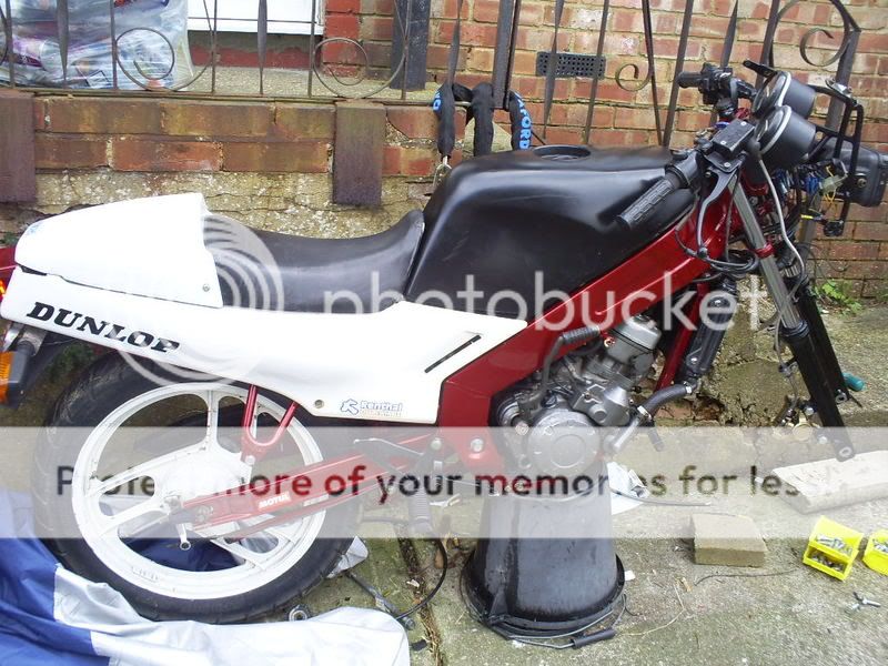

https://i4.photobucket.com/albums/y119/lotrs/TZR125/S5032628.jpg
worked for me, surprisingly sturdy lol
