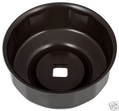

After struggling to remove a few oil filters I will now only ever use a socket cup filter remover tool, get the right size one for your filter and stick it on a 10" breaker bar Laughing works everytime.
Ebay example
https://i12.ebayimg.com/03/i/000/f8/c4/2fa3_1.JPG
