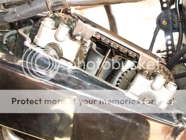

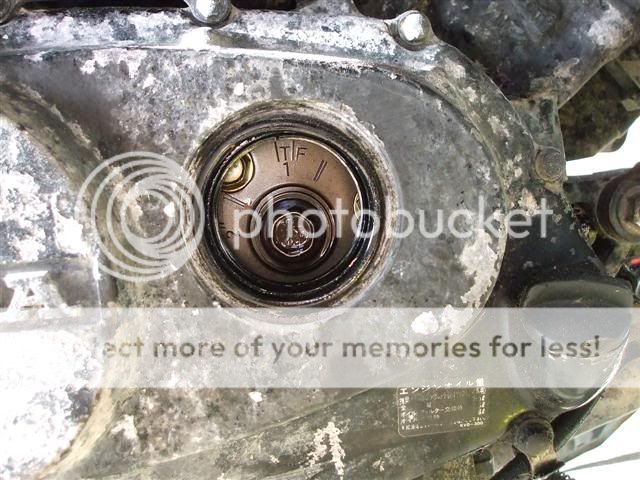

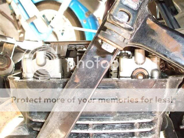

checking the timing
https://i58.photobucket.com/albums/g257/hmmmnz/DSCF1933Small.jpg
https://i58.photobucket.com/albums/g257/hmmmnz/DSCF1934Small.jpg
https://i58.photobucket.com/albums/g257/hmmmnz/DSCF1936Small.jpg
as she is at the moment

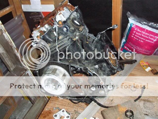

the spares
https://i58.photobucket.com/albums/g257/hmmmnz/DSCF1929Small.jpg
https://i58.photobucket.com/albums/g257/hmmmnz/DSCF1930Small.jpg

just checked cams again, and all is good there,
