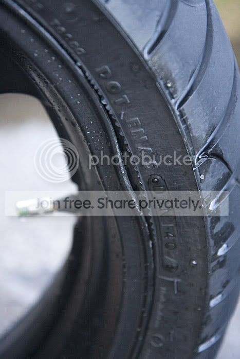

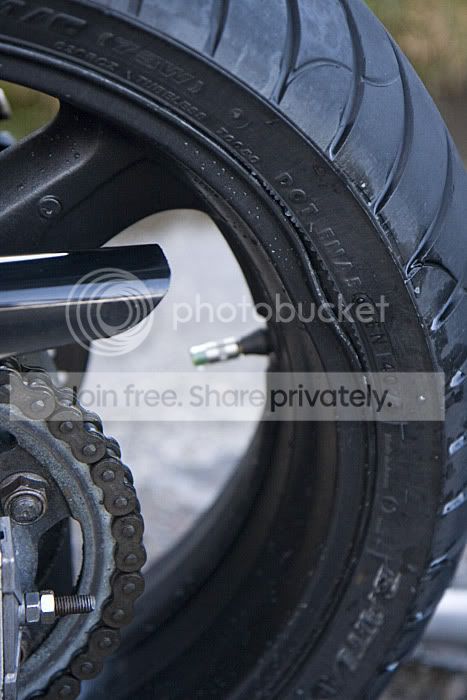

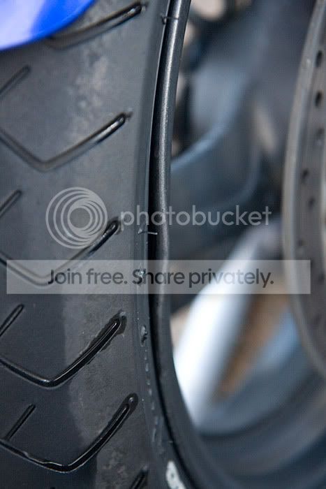

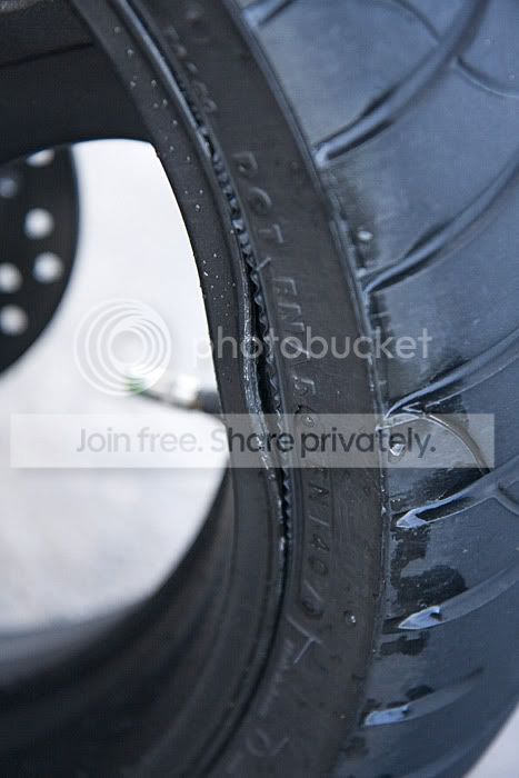

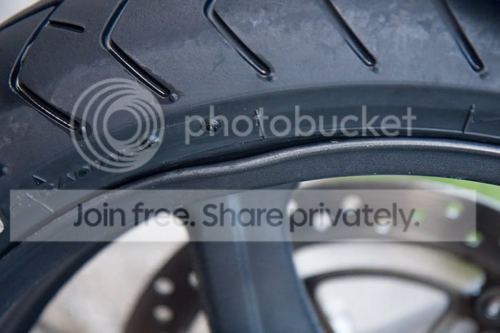

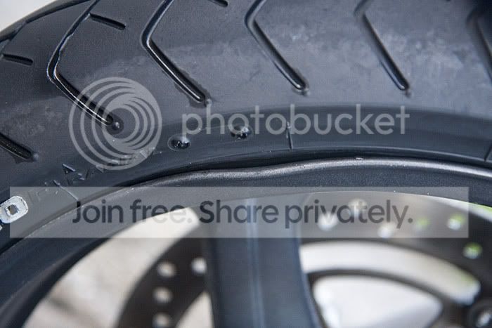

Hi, whilst cleaning the bike today I came across a big ding in each wheel. Don't ask me how they got there, because I really do not know. I did wonder why my rear tyre pressure was going down fast, with no punctures.
So my question is... what would you do in this situation? Can the dings be hammered back with a block of wood and hammer? Can they be professionally repaired? Or, do I just have to scour ebay for a new set of wheels?
If I were to repair them by hammering them out will this cause any safety issues? Will the wheels be weak from there on in?

theyre both an MOT failure.
i would personally just smack it with a hammer.
however... you're lying if you were riding the bike when that happened, and you didnt notice. would take quite a hefty smash to do that.
might want to consider new tyres too.

PostPosted: 23:04 - 08 Mar 2009    Post subject: Reply with quote
I'd make a former then either press or hammer it back into shape. I don't think there's much stretch there so it should go back to shape quite well.

Just a pattern from MDF or similar to go inside the rim to support it from the back when you try to straighten the rim.
You could always have somewhere like Maidstone Motoliner straighten them, if you don't fancy tackling the job yourself.

fair enough, so maybe just a block of wood the width of the inside of the rim to support it so that I don't bent the rim in too much.
I looked into maidstone motoliner but It'd probably be cheaper to get a second hand set of wheels instead.

I've been speaking to my tutors in college today (doing bike mechanics) and they pointed out that not only do the rims have dings but there's also flat spots on the "floor" of the rim so to speak which means the tyres aren't seating properly in those areas meaning air leakage.
Basically, I think the dings could be repaired but I don't think the flat spots can be. New set of wheels I think Sad

There are specialist repairers for that kind of buckle in the wheels if you req it, try MCN Classifieds.
I had one on my VR800 and I just hammered it out with a Estwing Hammer and a block of wood.
It was really easy to put back into shape,"soft alloy"
Worked ok for me.
