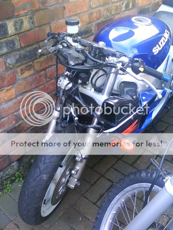

Well guys, i think its time i rebuild the final thing that nearly took my life, hell its been 11 months, i've gone through all the blood and sweat an a few tears haha, but i've finally got funds, a bit of time and a meet to get to.
I'll post more recent pictures soon but i intend to do a lot of photos to keep your attention lmao.
As it stands now
https://i126.photobucket.com/albums/p97/IXILONEWOLFIXI/DSC00026.jpg
The forks are so badly bent that they had to be removed an turned around, The rim has 3 seperate flat spots also.
First job, Rebuild the forks I bought from a 1998 model, possible update tomorrow.

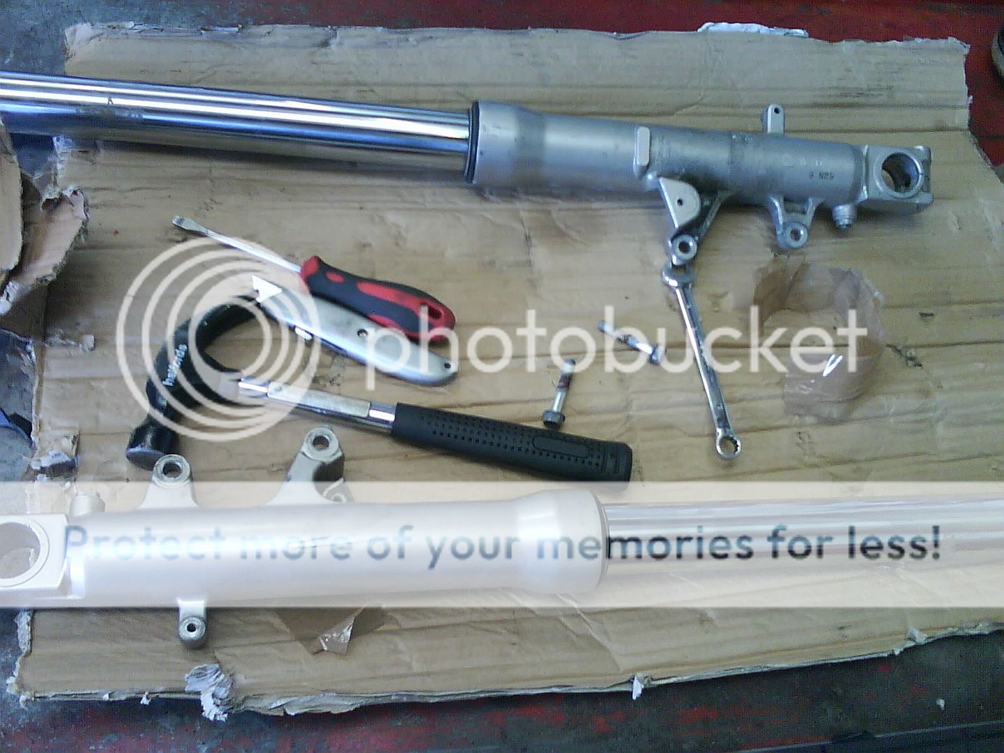

Anyway, i set the forks out on my bench to strip them but couldnt find the tool in time so i tried anyway and only got the old fluid out by undoing the bolt that holds all the damping unit together.
On the bench.
https://i126.photobucket.com/albums/p97/IXILONEWOLFIXI/DSC02434.jpg
Found a tool i could used, was scared i was going to srtip it lol.
https://i126.photobucket.com/albums/p97/IXILONEWOLFIXI/DSC02435.jpg

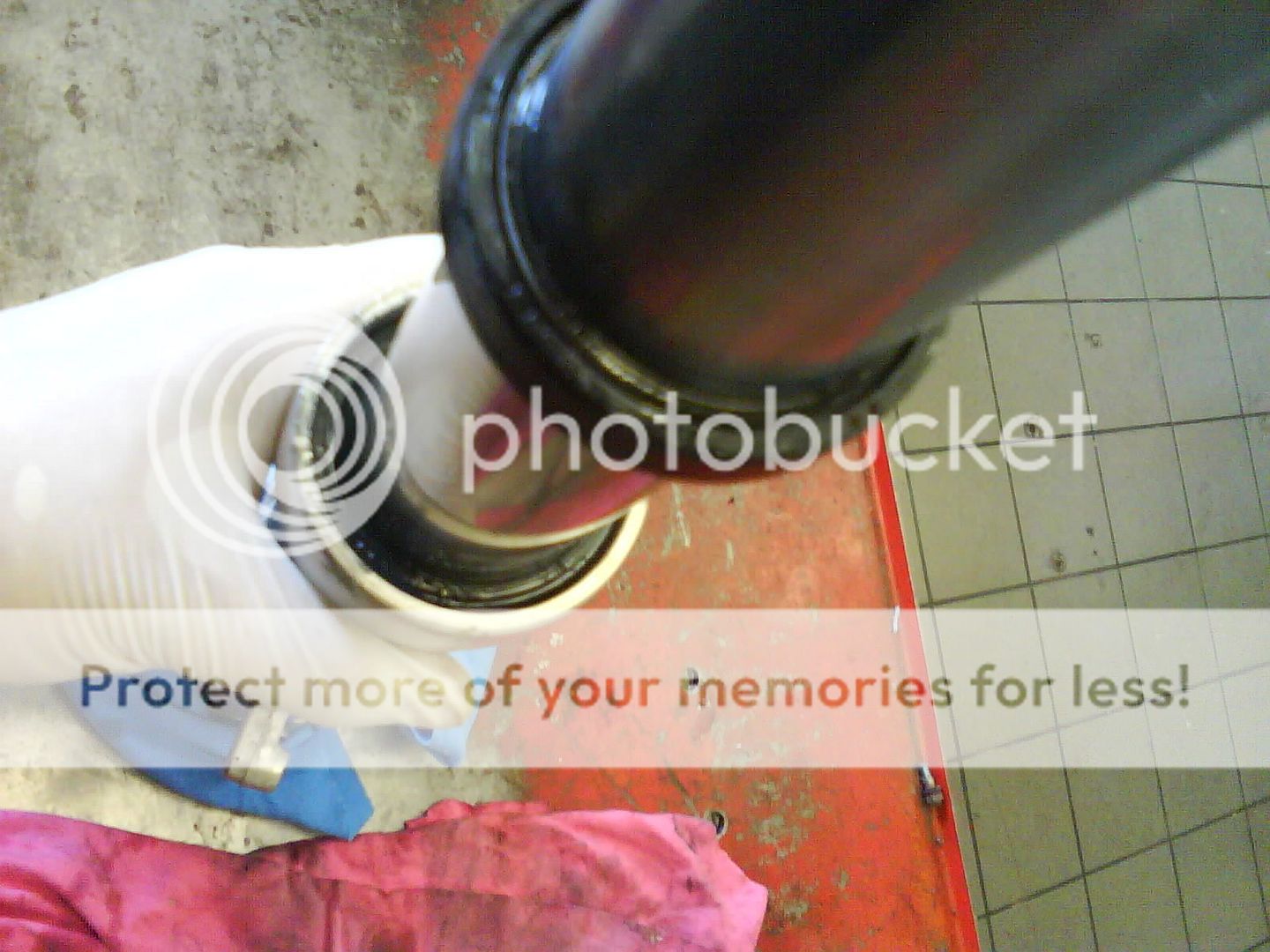

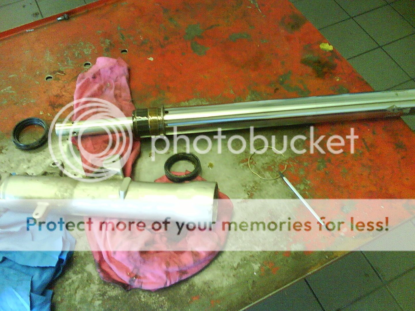

Well one fork seal done! Laughing Just need to put fluid in it and do the other one!
Pull this pin here...
https://i126.photobucket.com/albums/p97/IXILONEWOLFIXI/DSC02436.jpg
Then pull really hard with a motion similair to that of a dent puller...
https://i126.photobucket.com/albums/p97/IXILONEWOLFIXI/DSC02437.jpg
After i got the thing apart i got the last bit of oil out and then took the old seal off and put the new one one with a bit of lube so i didnt damage it.
I put the old seal over the top of it and tapped it down with a little hammer sliding it along the fork leg so not to damage it.
https://i126.photobucket.com/albums/p97/IXILONEWOLFIXI/DSC02438.jpg
The new seal slid into place but i needed it to go further down but the old seal got stuck-ish so i took it out and chopped the old one in half an then tapped it in again and then put the nap ring back in place. I then air wrenched the bolt that holds the damper assembly and forks together again.
I should of gotten more pics tbh so i will get more when i do the 2nd leg for future refference.

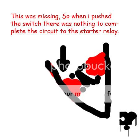

My bike wouldnt start, so after panicing about a starter solenoid that was perfectly fine and a tip over sensor that didnt exist, i looked at the start button that i originally thought was the source of the problem, I was correct!
Heres a little drawing.
https://i126.photobucket.com/albums/p97/IXILONEWOLFIXI/Switchdia.jpg
So how did i fix the problem? Well, i found another switch gear from scrap and took it apart and hey presto! there was a little brass top hat in there like mine, but it was too big, i had to put it in a vice and file it down. Easy you say? oh no it wasnt lol, the top hat i'm talking about was smaller than the end of a kids crayola crayon, about 1/5 the size of a 5p coin? Not too sure.
I filed it down and glued it into the press part of the button and fitted the spring that acts as part of the circuit and it fired up like a good girl.
