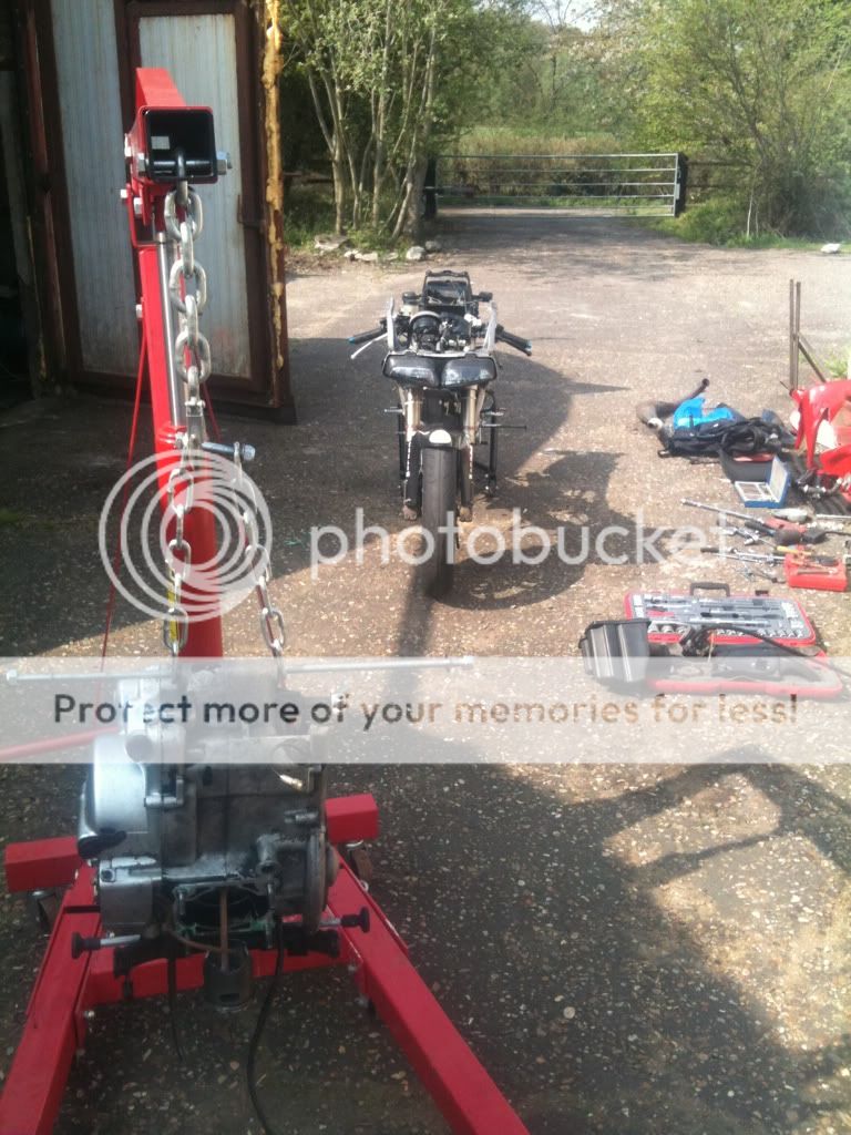

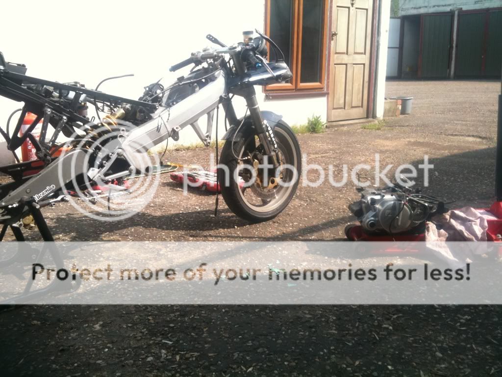

so my consisted of getting the train to london to get the parts. coming home. riding to the lock up., removing the engine, flushing the engine out. replacing the head, dialing in the piston for the right squish, building it back up, refitting the engine and riding it home again. all that in about 11 hours including travel.

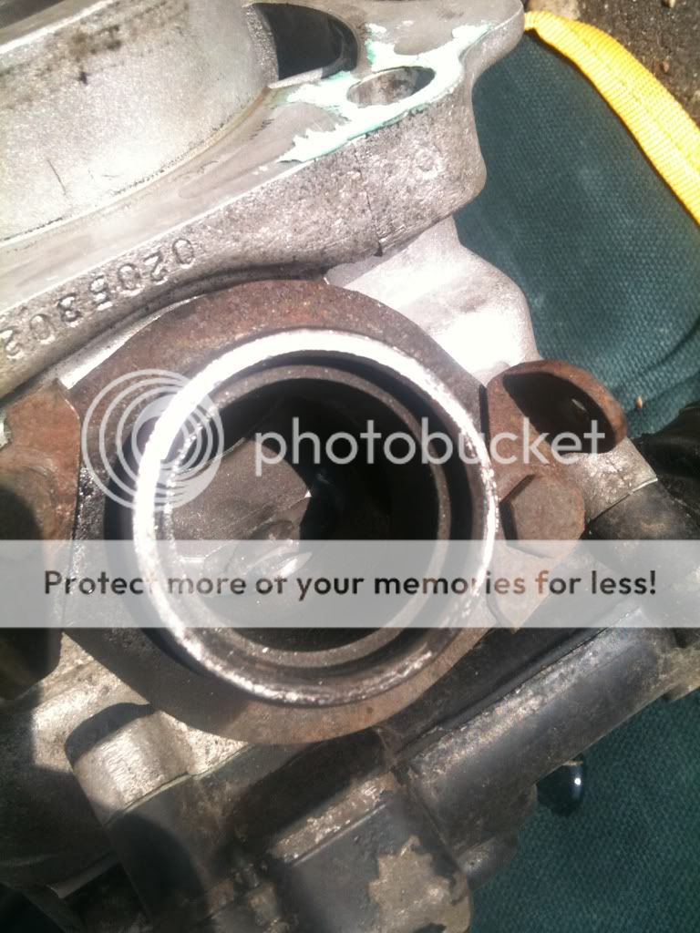

looking down the exhaust port and you can see the PV in two parts
https://i1112.photobucket.com/albums/k493/steven_191/8103f6ef.jpg
