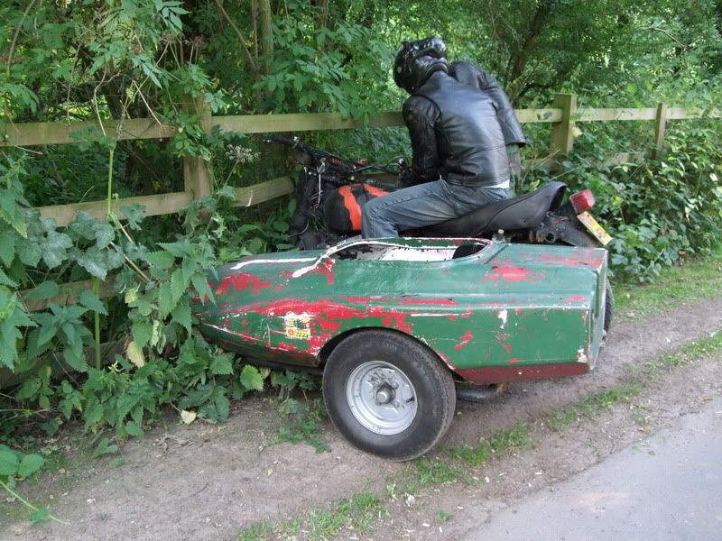

PostPosted: 17:03 - 20 Mar 2009    Post subject: Reply with quote
virus wrote:
Sidecars are great fun once your used to them,
N.B. Virus has crashed every sidecar he's ridden through a fence.
This is not a picture of Virus crashing a sidecar through a fence, it's just a tribute.
https://i245.photobucket.com/albums/gg50/RatBikerNotts/DSCF3414.jpg
virus
Joined: 17 Aug 2006
PostPosted: 17:05 - 20 Mar 2009    Post subject: Reply with quote
Scott, why do you think i stick to the actual sidecar now rather than riding it? Laughing
I was tempted to ask mouse for another go at the freezeup, but a snow covered hill is not the place to learn. Laughing
