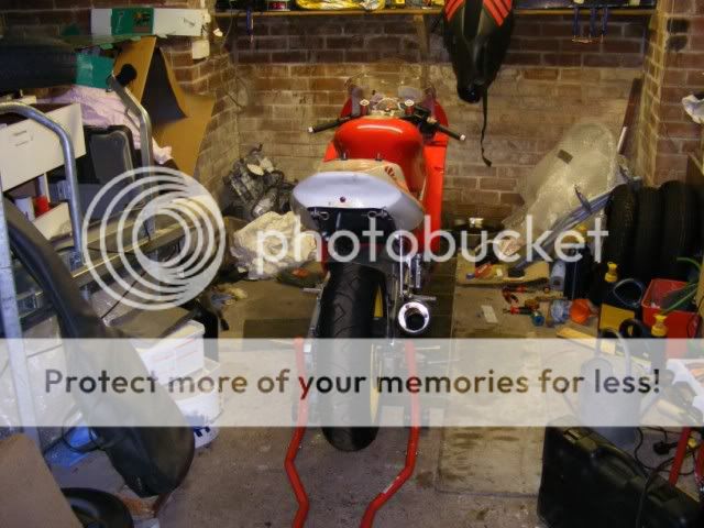

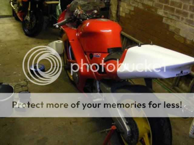

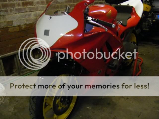

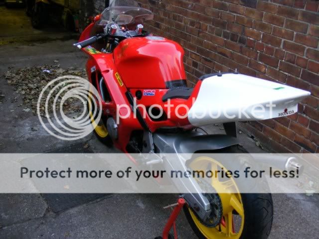

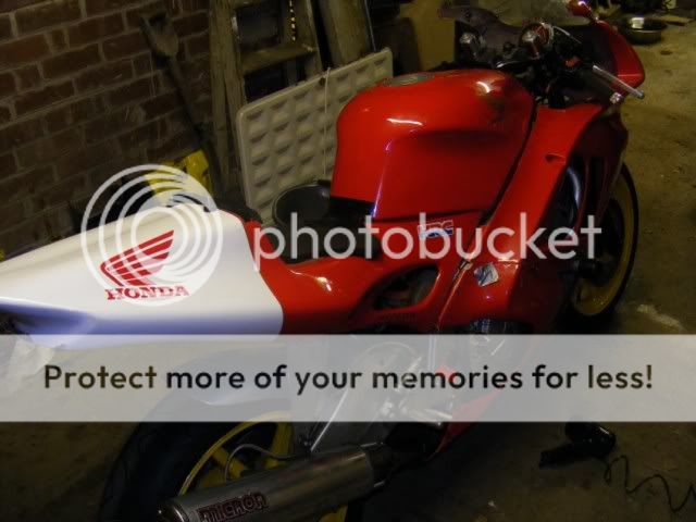

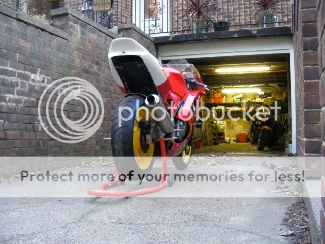

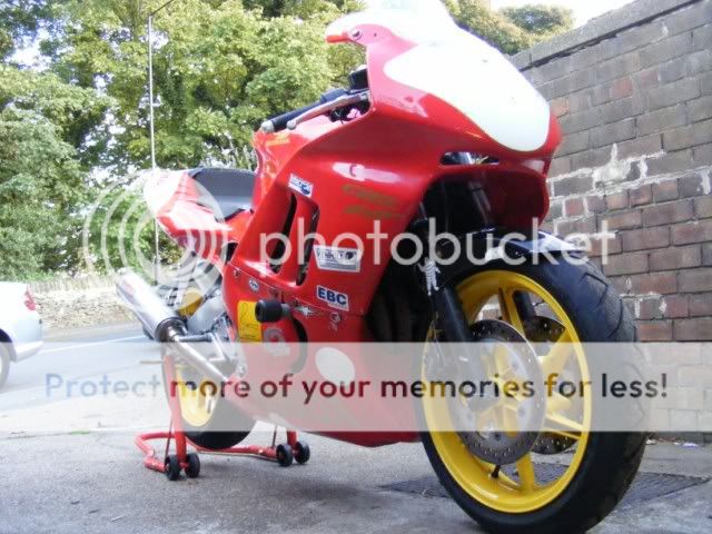

Bought myself a 91 CBR 600 Track bike off eBay at the weekend and picked it up on Monday. I bought it with a view to tarting it up and getting it out on track to test it some time this winter so it can be in tip-top condition for next summer.
This thread won't be some awesome turbo/custom frame/mirror finish paintjob project, more of a maintenance one.
Apparently it had been a race bike (EVERYTHING is lock wired) and it allegedly makes over 100bhp at the rear wheel. I'll believe this when I see it with my own eyes, and when it's sorted and I have a towbar on the new car I'll be taking it to the local bike shop to be dyno'd.
Pictures of it how I bought it:
https://i47.photobucket.com/albums/f186/markjackson13/DSCF0473640x480.jpg
https://i47.photobucket.com/albums/f186/markjackson13/DSCF0474640x480.jpg
https://i47.photobucket.com/albums/f186/markjackson13/DSCF0475640x480.jpg
https://i47.photobucket.com/albums/f186/markjackson13/DSCF0477640x480.jpg

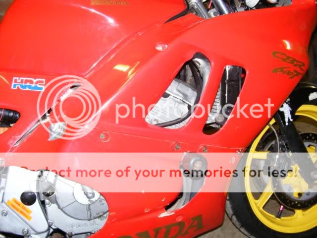

Overall on the outside it was in better condition than was expecting. The paintwork is fantastic for a track bike.

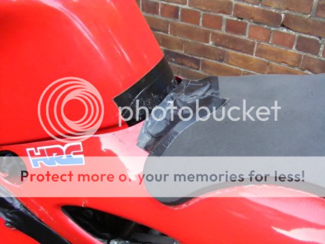

There's a fair amount of duck tape on some panels which I assume will be cracked fairings which can be repaired:
https://i47.photobucket.com/albums/f186/markjackson13/DSCF0478640x480.jpg

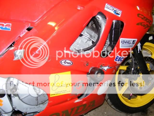

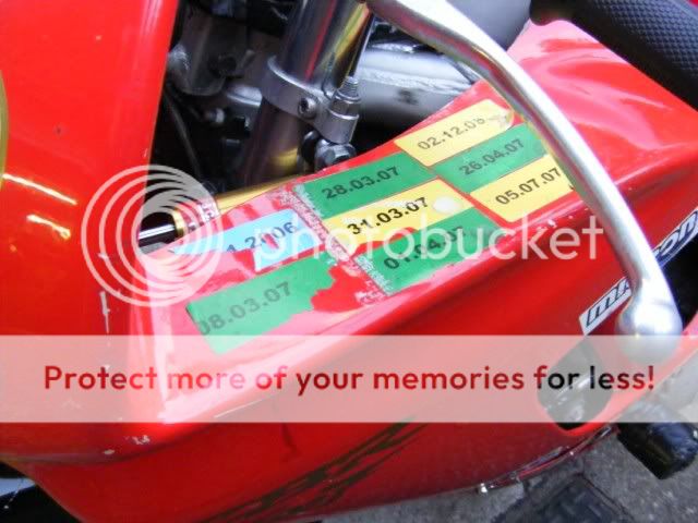

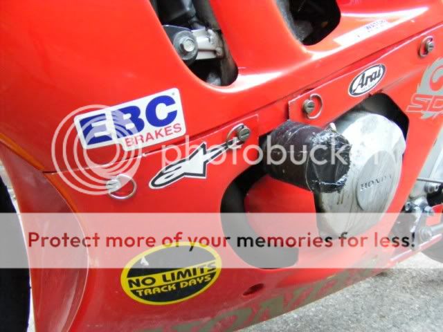

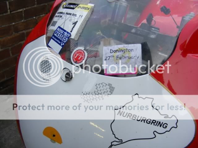

Loads of crappy looking stickers to come off:
https://i47.photobucket.com/albums/f186/markjackson13/DSCF0479640x480.jpg
https://i47.photobucket.com/albums/f186/markjackson13/DSCF0480640x480.jpg

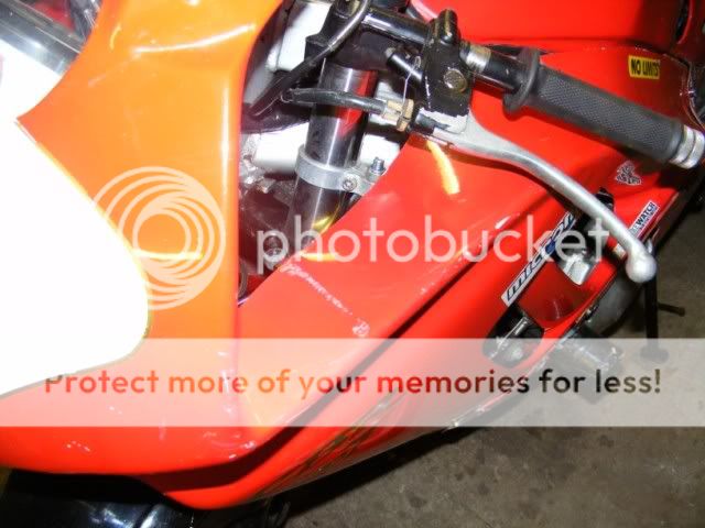

It's been down at some point, but nothing major:
https://i47.photobucket.com/albums/f186/markjackson13/DSCF0481640x480.jpg

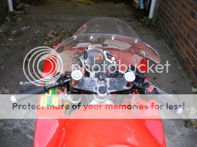

I may re-paint or powder coat the top yoke as it looks a bit shabby:
https://i47.photobucket.com/albums/f186/markjackson13/DSCF0488640x480.jpg

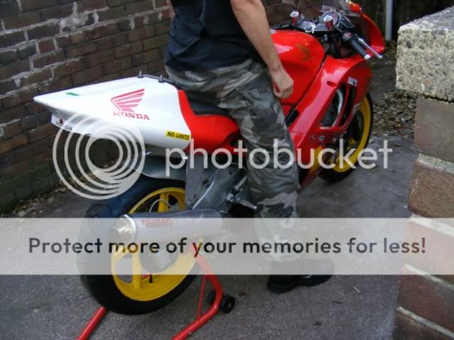

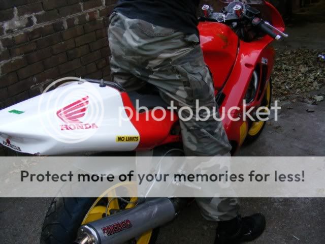

I definitely need to do something with the seat height as my bum just clears the seat when it's on a paddock stand Laughing:
https://i47.photobucket.com/albums/f186/markjackson13/DSCF0491640x480.jpg
Even worse with both wheels on the floor:
https://i47.photobucket.com/albums/f186/markjackson13/DSCF0492640x480.jpg

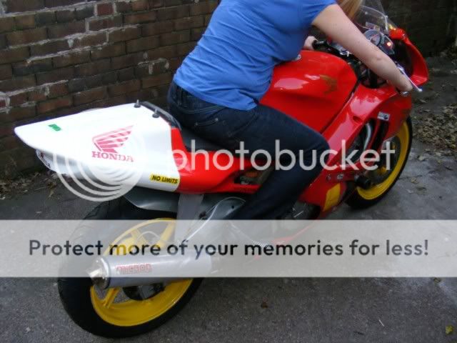

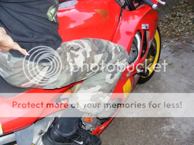

Legs of a 6'1" bloke + high race rear sets = pain:
https://i47.photobucket.com/albums/f186/markjackson13/DSCF0494640x480.jpg
Good for titchy 5'4" girlfriends though:
https://i47.photobucket.com/albums/f186/markjackson13/DSCF0496640x480.jpg

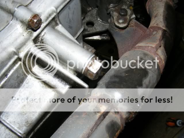

After taking the 'before' pictures I figured I'd take the lower fairing off to have a gander at the fairings. Earlier, when I had a feel at the bottom of the belly pan, I got some oil on my hands, which I had hoped was off the chain or something. Unfortunately when the belly pan was off I found what I had been expecting...
https://i47.photobucket.com/albums/f186/markjackson13/DSCF0497640x480.jpg
Doh!

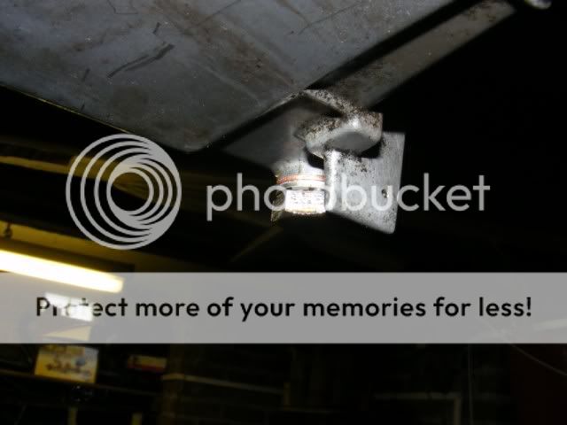

The bloke I bought it off had very kindly changed the oil before I picked it up, unfortunately...
https://i47.photobucket.com/albums/f186/markjackson13/DSCF0500640x480.jpg
...looks like he over-tightened the sump plug. Not to worry, I'll be pulling it off and getting it helicoil'd.

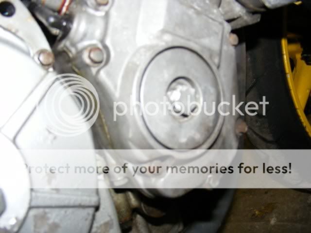

Ignition rotor center cap is a bit chewed up, but they cost nothing.
https://i47.photobucket.com/albums/f186/markjackson13/DSCF0502640x480.jpg
Hopefully this means it's been off a lot and the valve clearances have been done frequently.

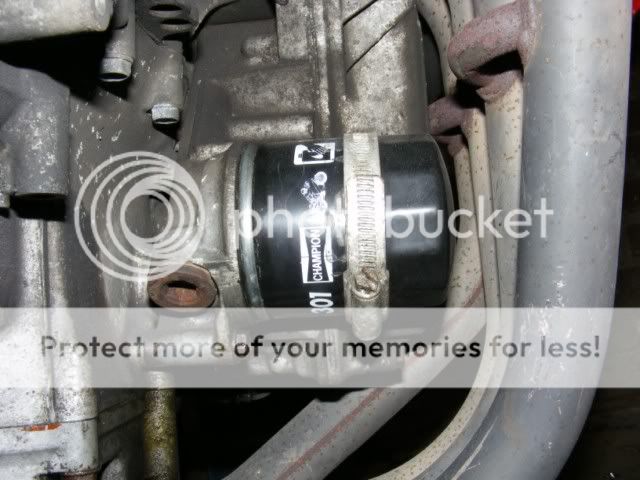

Oil filter has a big jubilee clip around it, but I'm not sure why. Maybe makes it easier to get the filter off?

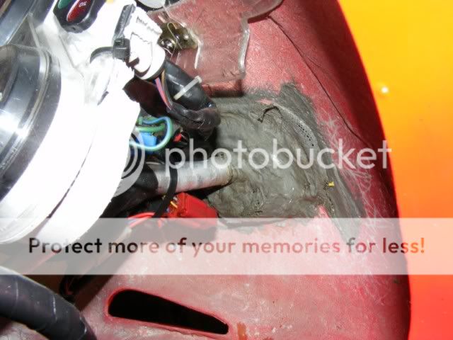

Finally, the fairing stay seems to be glued to the back of the nose cone:
https://i47.photobucket.com/albums/f186/markjackson13/DSCF0509640x480.jpg
Not sure why this was done, maybe the nose cone wobbled at speed. Might be a bugger to get off though Neutral

I reckon the jubilee clip is there so that it's possible to lock wire the oil filter.
garth
Joined: 15 Dec 2004
PostPosted: 19:07 - 10 Sep 2009    Post subject: Reply with quote
The jubilee clip is for lockwiring, same as my monster.

Yep, figured that when I was looking at it earlier Thumbs Up

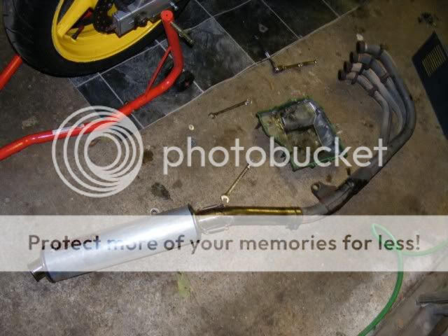

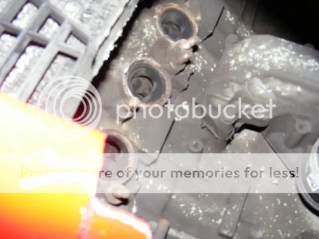

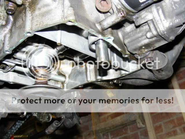

Some more progress today. Got the sump off Very Happy I tried to do it without taking the exhaust pipes off but the oil strainer wouldn't let me slide it out so they had to come off too:
Pipes and sump off:
https://i47.photobucket.com/albums/f186/markjackson13/DSCF0511640x480.jpg
Looking a bit grubby behind the downpipes, will give that a good scrub before the pipes go back on:
https://i47.photobucket.com/albums/f186/markjackson13/DSCF0512640x480.jpg
The troublesome strainer:
https://i47.photobucket.com/albums/f186/markjackson13/DSCF0513640x480.jpg
Another view of the downpipes. They'll get a good going over with wire wool and autosol while theyre off Thumbs Up:
https://i47.photobucket.com/albums/f186/markjackson13/DSCF0514640x480.jpg
Sump will be going to my local bike shop tomorrow morning to get the sump thread helicoiled. The thread on both the plug and sump looked fine on inspection, but when the sump plug is in there there's a lot of freeplay, and when I pulled it out there was a small amount of swarf so it must have stripped the thread.

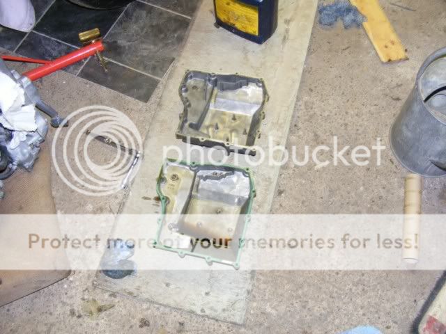

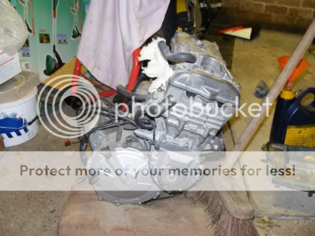

With the sump still not fixed, still needing a rotor cap and genny cover, I decided to just buy another engine rather than buying seperate spares:
https://i47.photobucket.com/albums/f186/markjackson13/DSCF0583640x480.jpg
It was a newer FV engine which came with a deeper sump (top one):
https://i47.photobucket.com/albums/f186/markjackson13/DSCF0584640x480.jpg
Had to use the strainer from the new engine so it could sit at the bottom of the sump.

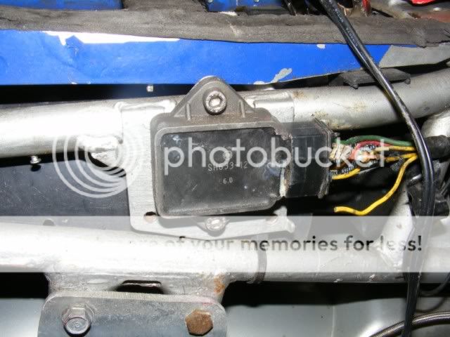

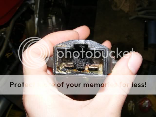

With the engine now finally oil tight I go to start the engine. Thumb the starter motor and I get that horrible popping/clicking sound of something electrical breaking:
https://i47.photobucket.com/albums/f186/markjackson13/DSCF0585640x480.jpg
You can see one the the spade connectors had completely blown off, and the other yellow wire was pretty badly burnt.
The battery was 99% flat and had made the reg/rec go pop. Rolling Eyes
You can see how it had blown the middle top pin straight out and left a massive hole:
https://i47.photobucket.com/albums/f186/markjackson13/DSCF0599640x480.jpg
10 minutes of soldering, and an ebay trip (for a new reg/rec) later:

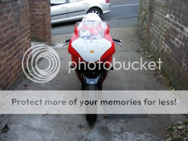

After having the garage look like a bomb site for the past month I decided to fit all the fairings back on. Looks exactly like it did when I got it, except I now have a damn sight more knowledge about how the bike works Laughing
https://i47.photobucket.com/albums/f186/markjackson13/DSCF0604640x480.jpg

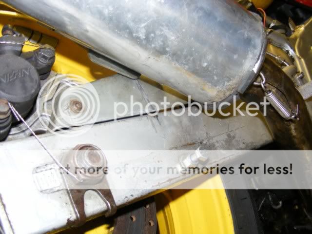

Next on the list, either bend the exhaust hanger bracket, or add some spacers to stop the exhaust touching the hugger and swing arm:

De-stickered it tonight. Pictures don't look half as good as what it does in the flesh. The red paint looks a lot better when it isn't cluttered with stickers.
