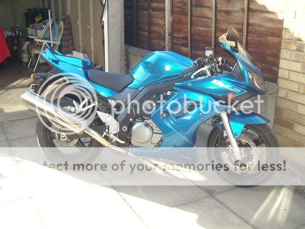

So, introduction time...here's Wilma not long after I bought her...
https://i3.photobucket.com/albums/y60/amnesia_stokerockscene/WIlmaNew.jpg

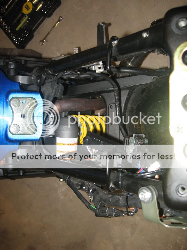

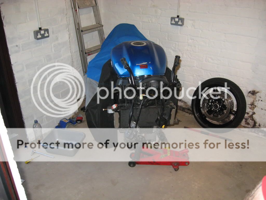

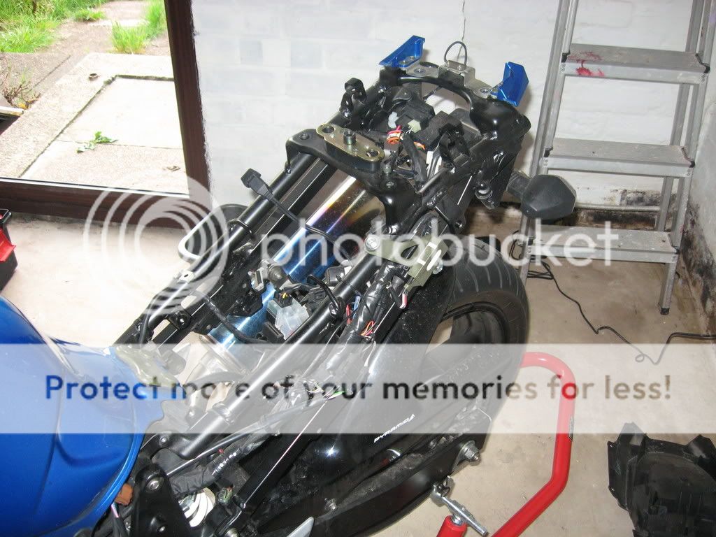

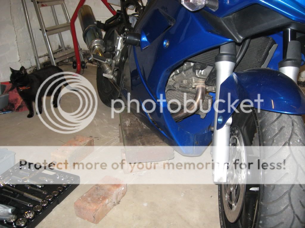

With a room full of 'new' shiny bits, I set about Wilma to replace the rear shock.
I did this first because I have had the back of the bike apart before, so it was familiar teritory.
So up on a paddock stand and off with the plastics...
https://i3.photobucket.com/albums/y60/amnesia_stokerockscene/WIlma%20Frankenbike/IMG_0704.jpg
I took a lot of photographs during this job, to things like cable routings - vital if you are doing something for the first time I think. Thumbs Up
We improvised a bike lift to get the weight off the swing arm. I think you will agree that it is very professional. Wink
https://i3.photobucket.com/albums/y60/amnesia_stokerockscene/WIlma%20Frankenbike/IMG_0706.jpg

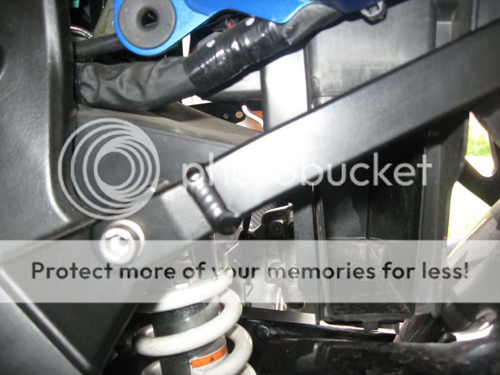

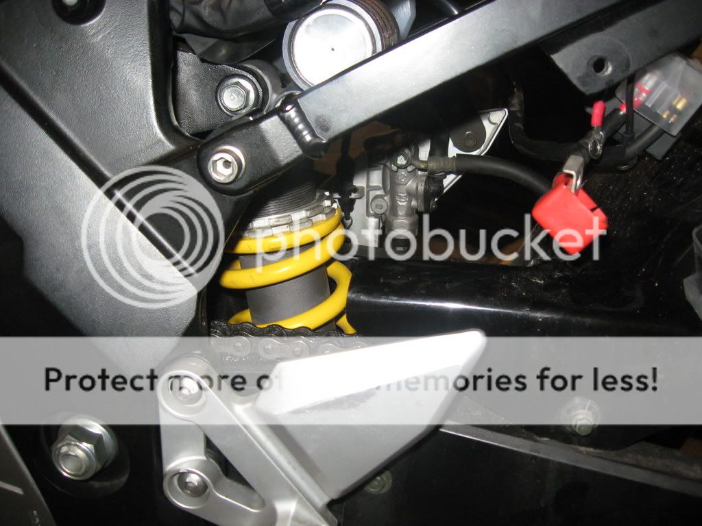

The GSXR shock re-uses the SV's own upper bolt, but needs a GSXR bolt for the lower mounting (the SV shock is threaded, where the GSXR shock has a clearance hole)
It also requires a bit of hacking to the battery box and raising the battery up. This caused the battery to clash with the underside of the seat - something that my research hadn't shown up.
I fashioned some blocks out of GPO3 (polyester delmat) to raise the battery, and replaced the standard battery with a smaller but equally rated gel unit. £50 I hadn't planned to spend but its only money after all Embarassed Rolling Eyes
Old shock...
https://i3.photobucket.com/albums/y60/amnesia_stokerockscene/WIlma%20Frankenbike/IMG_0701.jpg
New shock...
https://i3.photobucket.com/albums/y60/amnesia_stokerockscene/WIlma%20Frankenbike/IMG_0709.jpg
https://i3.photobucket.com/albums/y60/amnesia_stokerockscene/WIlma%20Frankenbike/IMG_0708.jpg
I rebuilt the back end of the bike and took it for a quick ride just to check that nothing was going to fall off - without changing the settings it was delivered with.
I would probably have got a better response from a piece of scaffolding pole!
I got home and checked the settings. All were two clicks from hardest. Laughing With the settings softened, the rear improved dramatically.

It started with the correct selection of tools...
https://i3.photobucket.com/albums/y60/amnesia_stokerockscene/WIlma%20Frankenbike/IMG_0747.jpg
Two hours in an poor Wilma looked like this...
https://i3.photobucket.com/albums/y60/amnesia_stokerockscene/WIlma%20Frankenbike/IMG_0751.jpg
https://i3.photobucket.com/albums/y60/amnesia_stokerockscene/WIlma%20Frankenbike/IMG_0748.jpg
https://i3.photobucket.com/albums/y60/amnesia_stokerockscene/WIlma%20Frankenbike/IMG_0750.jpg
25/7 I'm a God-damn Rock Star

The observant amongst you might have noticed that the front end was supported with a stand located in the bottom yoke.
Since this was being replaced I was left with a slight problem - how do I support the bike while I replace the head bearings and fit the new yokes?
The choices...
Arrow Sky hooks - a good solution, but not easy to find locally
Arrow Hold it with one hand, fit the bearings and yokes with the other - a good solution, but we were out of spinach so a bit of a non starter
Arrow set on a brace of umpa-lumpa's on minimum wage to hold the bike up - another interesting solution, but I ain't apying them lazy orange bastards for anything!
Arrow trolley jack - under the engine, jobs a good 'un.
https://i3.photobucket.com/albums/y60/amnesia_stokerockscene/WIlma%20Frankenbike/IMG_0765.jpg
New bearings going in...
