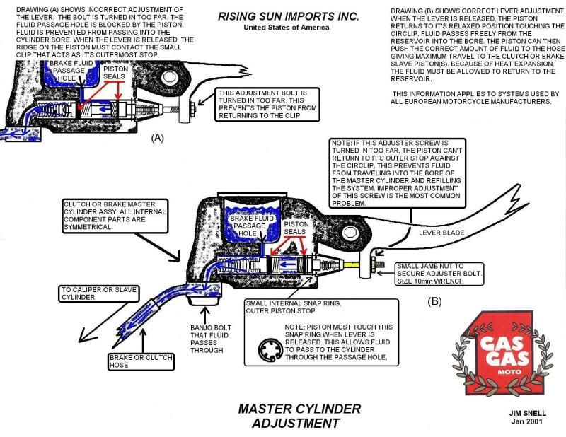

Any idea where I can find a diagram of what's inside a master cylinder/resevoir arrangement?
I'm trying to get my head around it but don't exactly understand what's there... I know there's obviously a hydraulic piston, but is there any valves or other such gadgetry?
Yamaha SZR660 Caution to the wind, the throttle pinned!
loply
Joined: 24 Mar 2004
PostPosted: 11:07 - 20 Apr 2009    Post subject: Reply with quote
Should the piston in the M/C return to an "open" position by itself, using some kind of spring?
Just when I had the M/C off, I blew some compressed air through it, and I reached in with a screwdriver and pressed the piston to see if it was seized... It moved freely until it stopped (at the end of its travel), but then it stayed there... As far as I know it still hasn't moved, what will make it return, hydraulic pressure? Is it not going to be blocking the filling process now?

There is normally a spring inside the master cylinder to return the piston. Normally a tapered coil spring.
Down side is that I suspect Brembo won't sell a rebuild kit and expect you to buy a new master cylinder (Aprilia show them on the parts list but not with any part number, just as part of the master cylinder).

Got it solved folks.
The aftermarket brake lever I fitted was not quite identical to the original, meaning the piston was constantly pushed in a tad, and fluid couldnt return.
Filed the armature thing down a millimeter or two and it worked.
