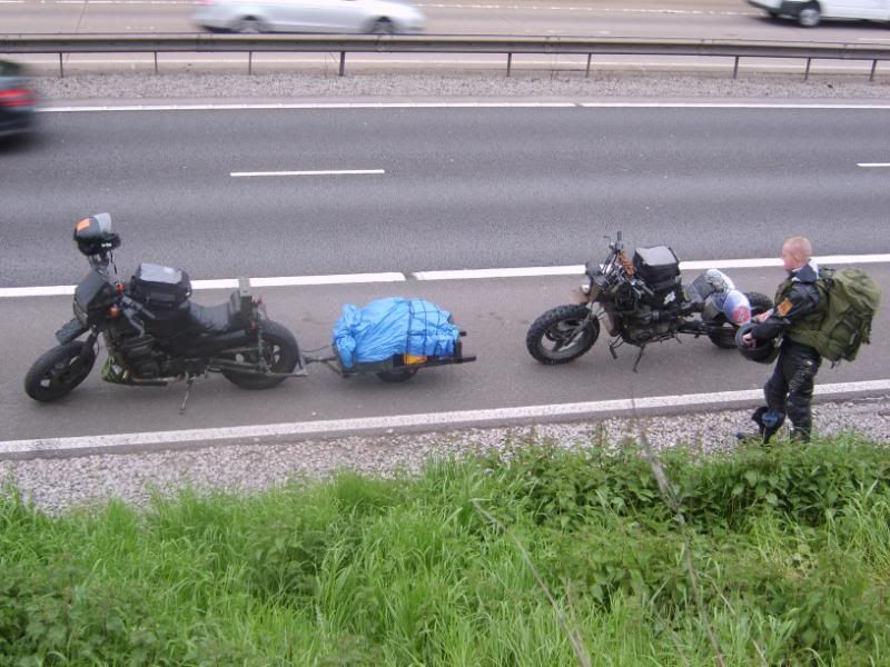

Well after single seating my GPZ I decided I need more space for camping kit, however I didnt want to make it a full 2 seater again as I like the minimal look, so my mind went onto trailers, I did a bit of research then got started.
Now the law states that:
* The towing motorcycle must exceed 125 cc engine capacity.
* The trailer has an overall width not exceeding 1.00m
* The distance between the rear axle of the motorcycle and the rearmost part of the trailer must not exceed 2.5m.
* The Motorcycle must be clearly and indelibly marked with it’s kerbside weight.
* The Trailer must be clearly and indelibly marked with it's unladen weight.
* The Maximum towed weight, including the trailer and it’s load must not exceed 150 Kg (330 lb) or two thirds of the motorcycles kerbside weight, whichever is the least.
* The UK speed limit is 60 mph on Motorways and dual carriageways and 50 mph on all other roads unless a lesser limit is in force.
So with that in mind (and a welder borrowed from my mate) I got started on my first welding project, ive never used arc before so this should be a good test.
My plan is for a 50cm wide (to match the flashbang crate in the pictures) 3ft long single wheel trailer, with no real body on it, just a chassis for me to strap my camping kit to, using a universal joint from a steering column/drive shaft as a hitch.
Here is the progress from day 1.

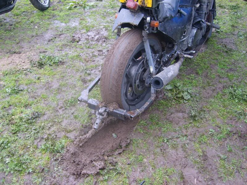

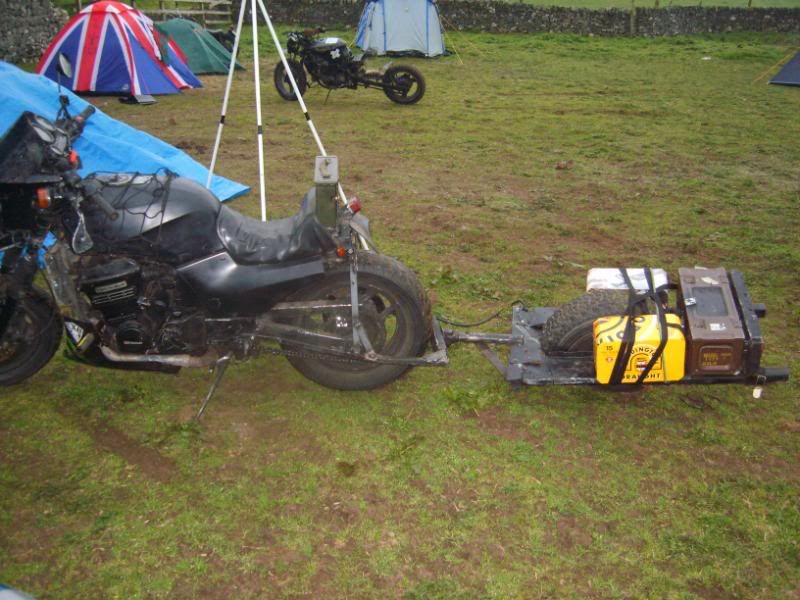

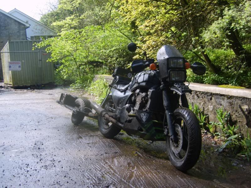

So I completed the trailer, 2 DAYS before rat and survival, then took it for a test run, this resulted in me being thrown off the bike and the rear sub frame i made for the hitch bending and in one place breaking (on the metal not a weld though, so that gave me confidence in my welding)
so 1 day before rat and survival I chopped off the hitch tube, realigned it with the wheel to try and get it to pull straight, and then fabricated a new rear hitch sub frame.
Here is the results:
https://i251.photobucket.com/albums/gg307/virusjohn/rat%20and%20survival%2009/S8000083.jpg
https://i251.photobucket.com/albums/gg307/virusjohn/rat%20and%20survival%2009/S8000087.jpg
https://i251.photobucket.com/albums/gg307/virusjohn/rat%20and%20survival%2009/S8000112.jpg
It was a bit of a muddy field at R+S
https://i251.photobucket.com/albums/gg307/virusjohn/rat%20and%20survival%2009/S8000159.jpg
Unloaded, it tows pretty well, obviously Its a pain to reverse, U turns are harder because the prop joint locks over quite soon but it pulls well and is only noticeable on very bad roads. Loaded up its not too bad but the wobbles set in a lot quicker and b road hooning just isn't possible.
All in all, I'm glad Its done, current plans are to replace the bearing in the prop joint, brace the hitch sub frame a bit more and give it all a bit more paint, then its back to the corner of the garden until the next rally/touring/massive beer run.
