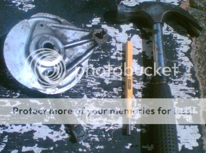

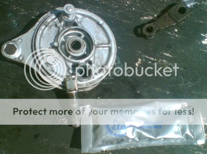

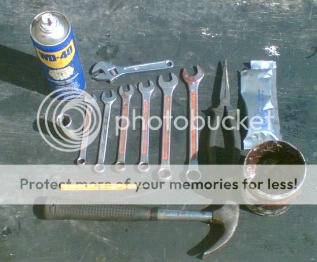

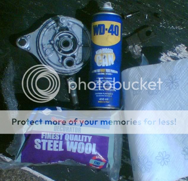

10,12,13,14,17 & 19mm combination spanners; Small adjustable spanner; drift; hammer; pliers; 17mm deep socket.
I also used copper grease, molybdenum disulphide grease; WD40; wire wool and kitchen towel.

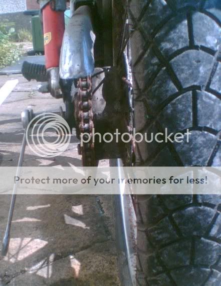

Place the bike on the centrestand, if you don't have one, either use a paddock stand or find some way of propping the rear wheel off the ground in a stable fashion.

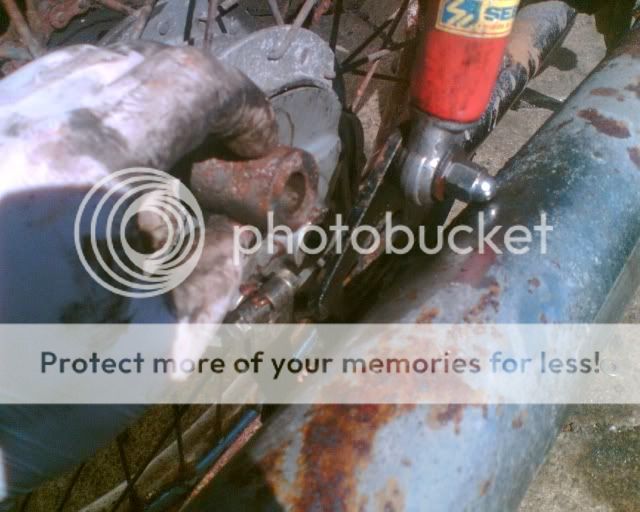

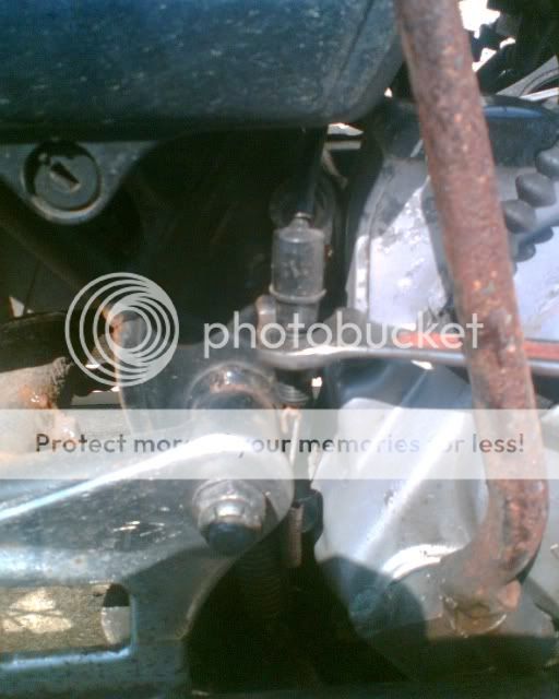

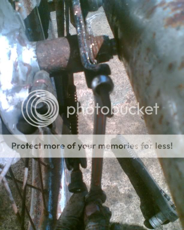

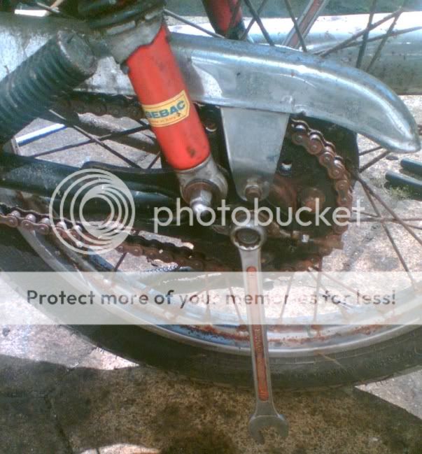

First undo the nut on the end of the brake control rod (the bit that joins the pedal to the brake itself). This is sometimes a cable rather than a rod. Take it all the way off and put it somewhere safe, it's a special type that would have to be replaced from a dealers if you loose it.
Notice use of the closed end of the spanner. Only use the open end if the closed end won't fit.

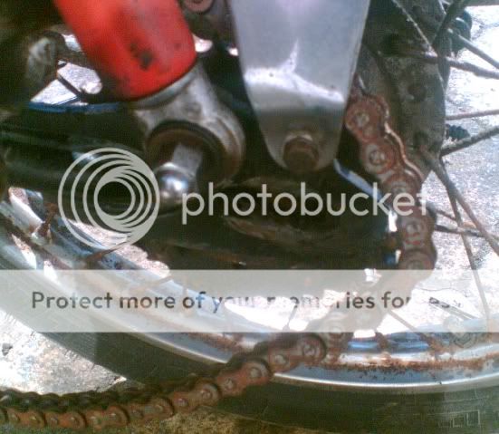

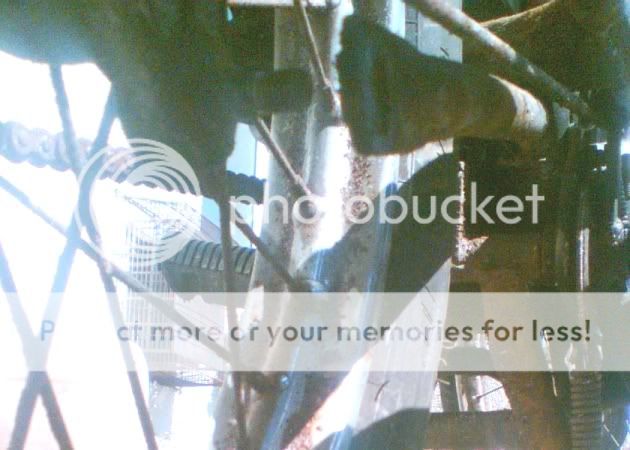

Now remove the nut that holds the torque arm to the brake drum. The torque arm is the piece of metal tube or bar that stops the brake drum from rotating with the wheel. Some bikes have a peg or slider that engages with a notch or peg on the swingarm instead of a torque arm.
Most torque arm bolts have a split pin through the end to stop them coming undone (I forgot one once and nearly lost a toe when I put the brakes on!). So, straighten and remove the split pin using a pair of pliers then undo the nut.

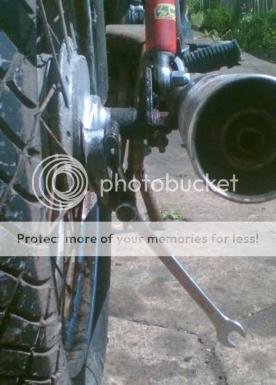

You should now be able to pull the torque arm free of the brake drum.

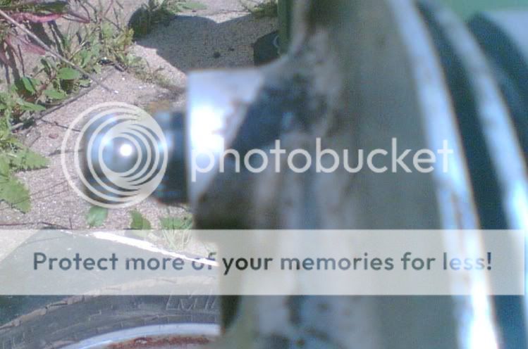

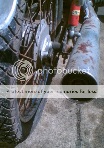

Now undo the big rear wheel nut. This will be done up pretty tightly. You may need to use a second spanner on the other end of the wheel spindle to stop the whole thing rotating.
https://i48.photobucket.com/albums/f216/stinkwheel/drumbrake/Image006.jpg
You should now be able to pull the wheel spindle out. Before doing so, make sure the bike is going to be stable on its stand with the wheel removed.

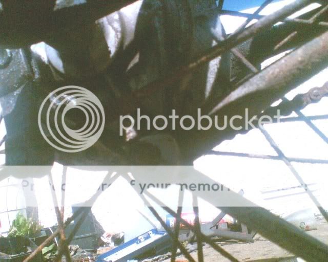

Take careful note of where any wheel spacers, washers and adjusters that were threaded on the wheel spindle are located and put them to one side. An H100 has one spacer between the brake drum and the swingarm, this is the time to remove it.
By rolling the wheel forwards slightly, you ought to be able to unhook the chain from the sprocket.
https://i48.photobucket.com/albums/f216/stinkwheel/drumbrake/Image008.jpg

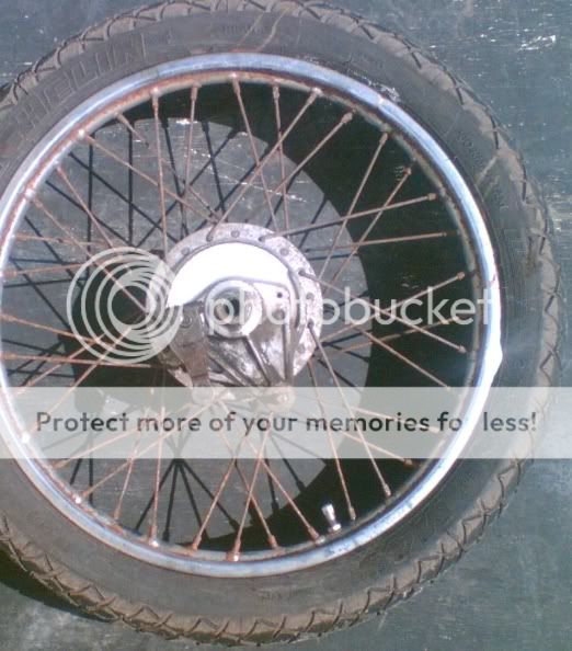

Rotating the brake drum itself will allow you to slide the brake control rod free.
https://i48.photobucket.com/albums/f216/stinkwheel/drumbrake/Image009.jpg
With a little wiggling, you now ought to be able to pull the wheel back and free from the bike.
https://i48.photobucket.com/albums/f216/stinkwheel/drumbrake/Image010.jpg

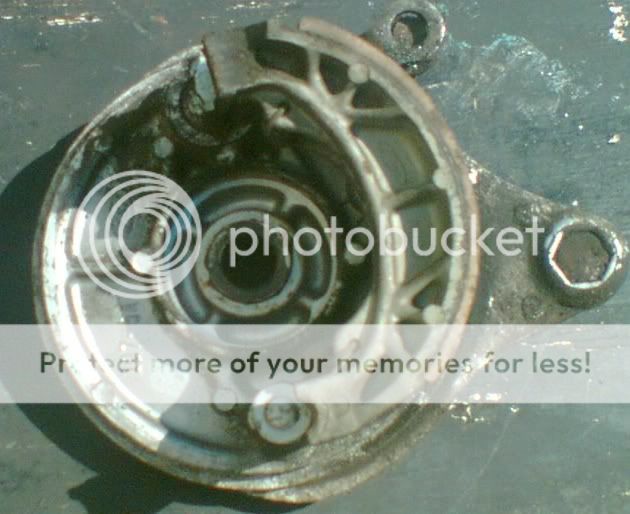

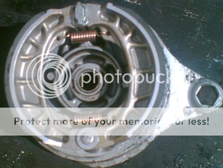

The whole brake calliper should lift out of the wheel. You sometimes need to wiggle the brake arm a bit if the pads are gripping the inside.
https://i48.photobucket.com/albums/f216/stinkwheel/drumbrake/Image011.jpg

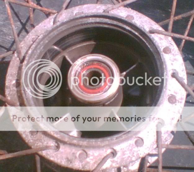

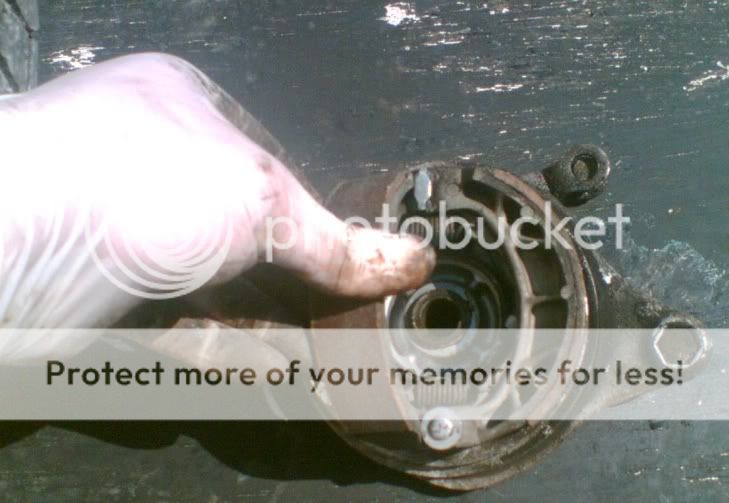

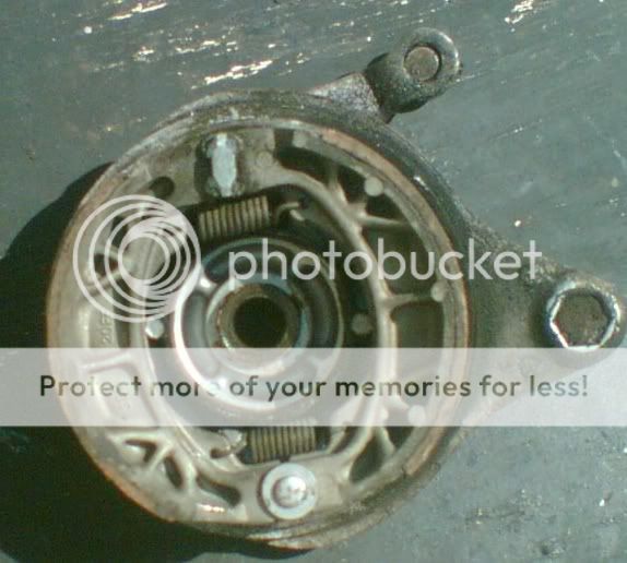

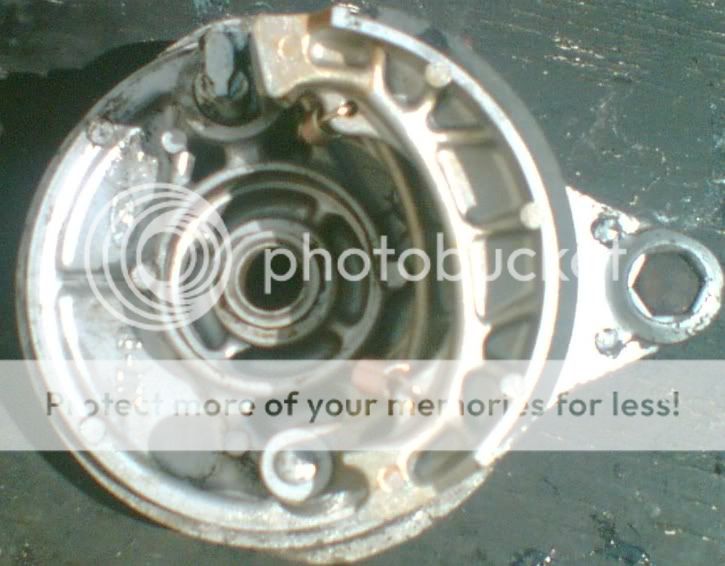

Now is also a good time to inspect the brake lining inside the wheel hub. It should be shiny, free from corrosion and without any deep scores. Light corrosion can be removed by rubbing with emery paper. More serious corrosion or scoring is a job for an engineer.
https://i48.photobucket.com/albums/f216/stinkwheel/drumbrake/Image015.jpg

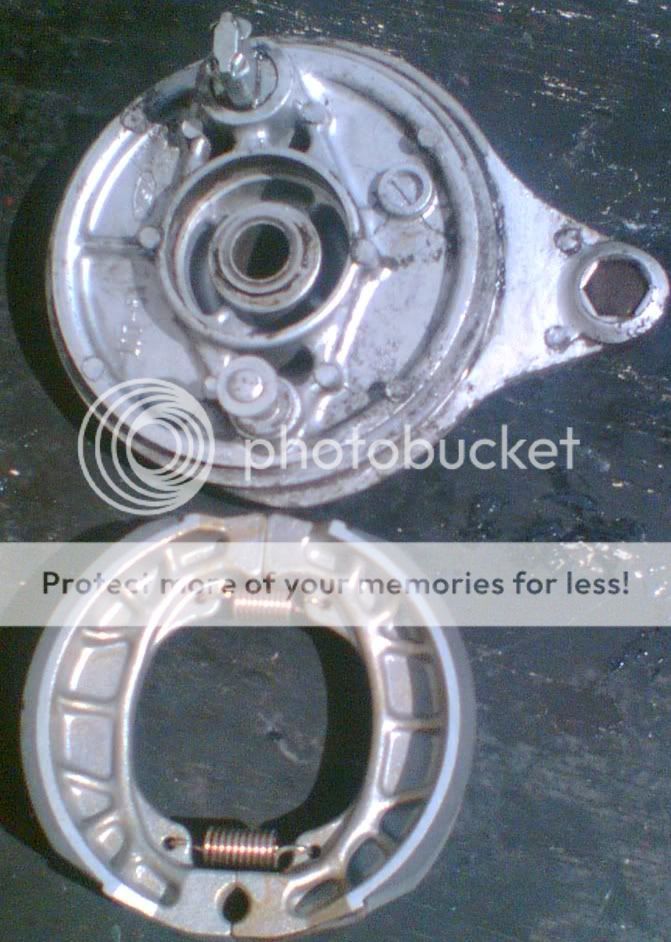

It's not tricky to remove the old brake shoes, simply lift one of the shoes (being careful not to trap a finger in there):
https://i48.photobucket.com/albums/f216/stinkwheel/drumbrake/Image012.jpg
Fold it over on top of the other one:
https://i48.photobucket.com/albums/f216/stinkwheel/drumbrake/Image013.jpg
And lift them off:
https://i48.photobucket.com/albums/f216/stinkwheel/drumbrake/Image014.jpg

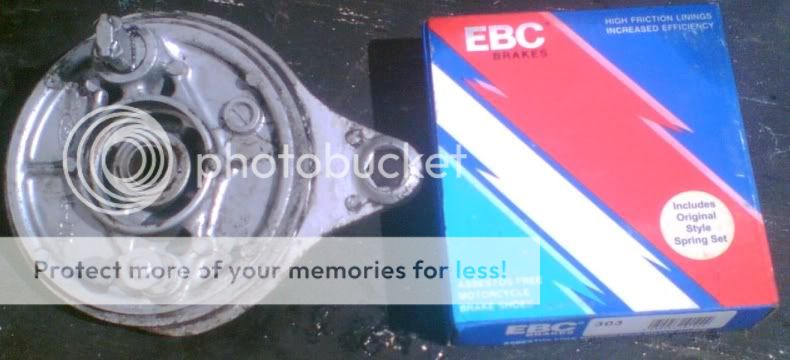

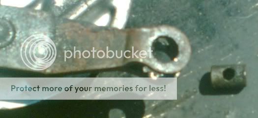

Before throwing them away, check your new shoes come with springs. Some do, some don't so you might have to save those.
Now is also a good time to remove the trunnion from the brake arm (see picture) and put is somewhere safe.

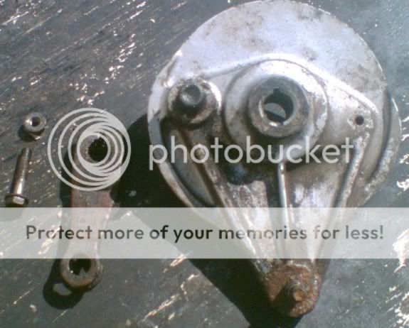

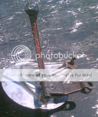

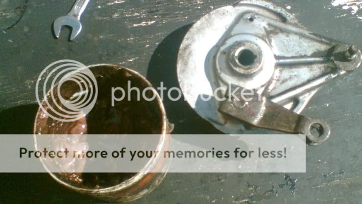

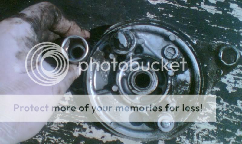

First undo the brake arm pinch bolt.
https://i48.photobucket.com/albums/f216/stinkwheel/drumbrake/Image017.jpg
Lift the brake arm off its shaft. You may need to gently prise the ends apart with an old screwdriver in order to remove it.
https://i48.photobucket.com/albums/f216/stinkwheel/drumbrake/Image018.jpg

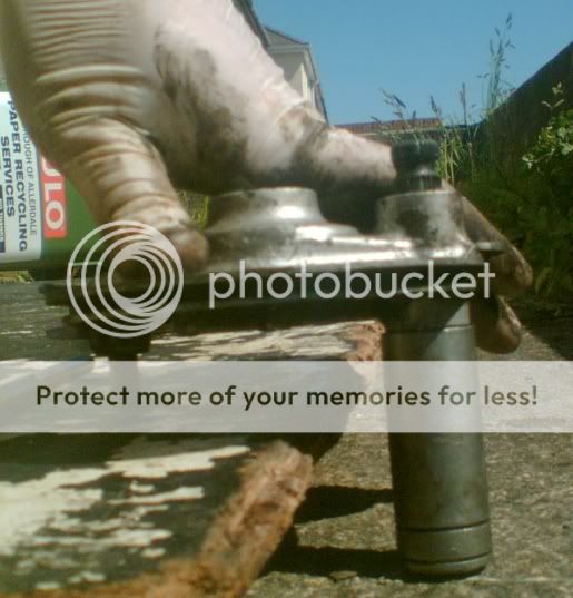

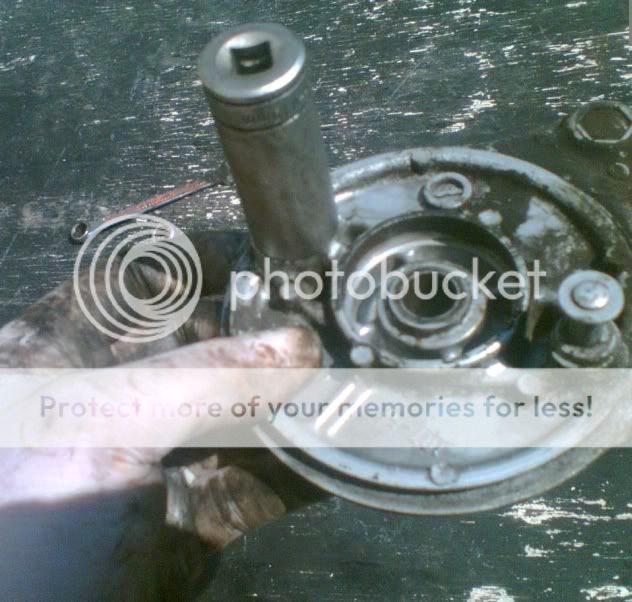

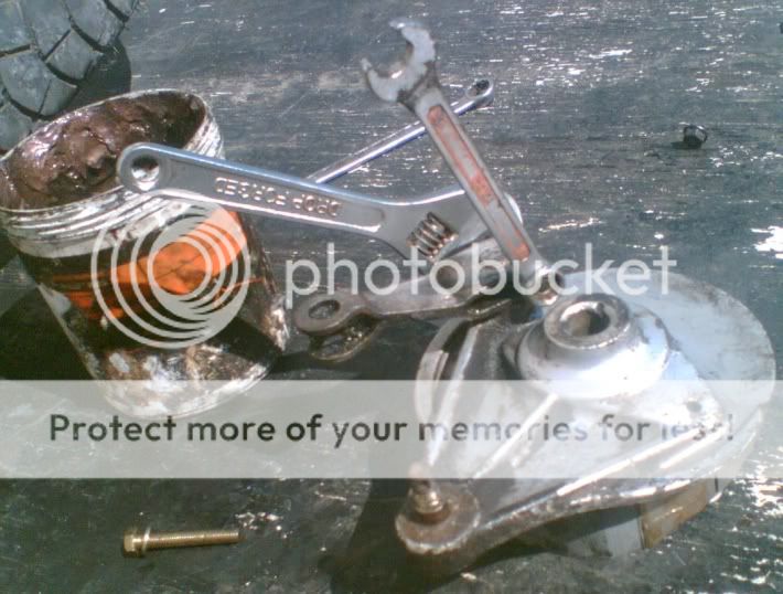

Now find a piece of tube that fits over the inside part of that shaft and butts against the alloy casting. In my case, a 17mm deep socket fits the bill nicely.
https://i48.photobucket.com/albums/f216/stinkwheel/drumbrake/Image019.jpg
https://i48.photobucket.com/albums/f216/stinkwheel/drumbrake/Image020.jpg
The tube is to allow the shaft to be driven out of the alloy casting from outside to in. In an ideal world, it would pull out by hand, but if it did that, you wouldn't need to be stripping it.
https://i48.photobucket.com/albums/f216/stinkwheel/drumbrake/Image021.jpg

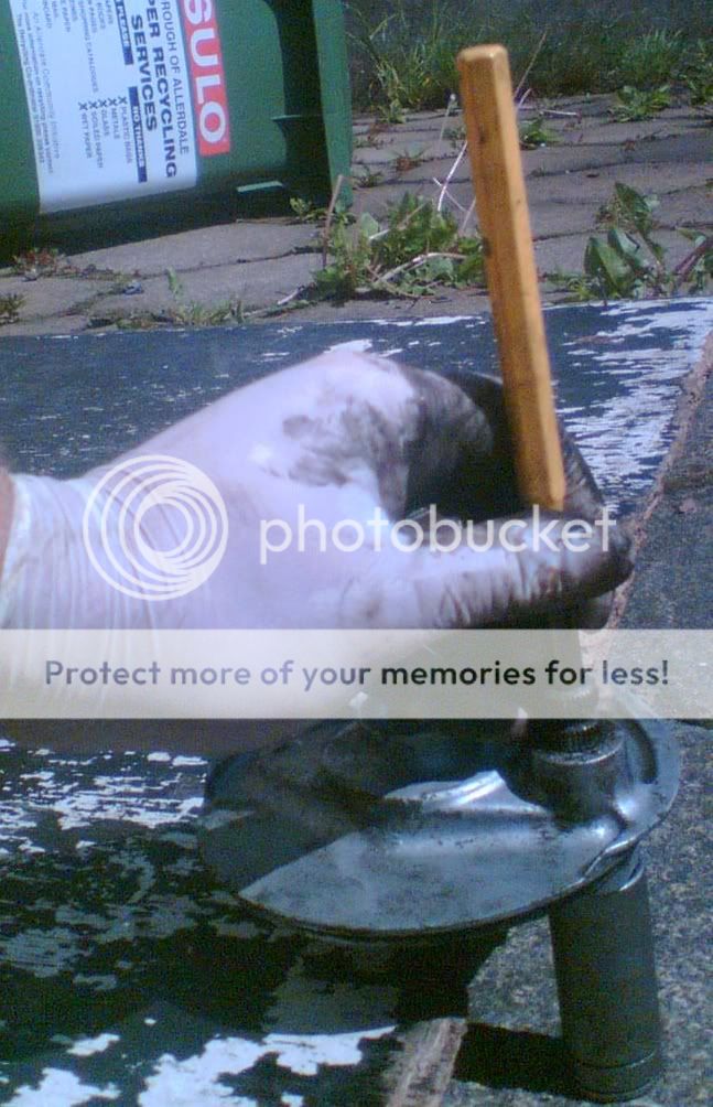

Don't use excessive force to drive the shaft out or you'll crack the alloy. If it's well stuck, apply some penetrating oil and leave it to sit for a while. I'm using a drift here, an old bolt or a socket extension bar would work as well. Take care not to damage the end of the shaft by battering away at it or the brake arm won't fit back on.
https://i48.photobucket.com/albums/f216/stinkwheel/drumbrake/Image022.jpg
A couple of sharp taps ought to have it out, otherwise back to the penetrating oil. Failing that, heating the area up with a blowlamp works wonders.
https://i48.photobucket.com/albums/f216/stinkwheel/drumbrake/Image023.jpg
Now give the whole lot a clean up. WD40 and kitchen roll does a good job. Aerosol brake cleaner also works nicely. Clean any corrosion off the shaft and the hole it sits in using wire wool.

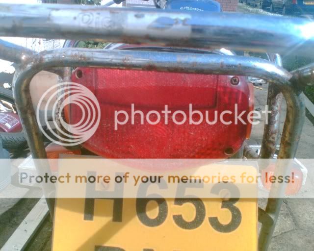

Finally, check the brake light is coming on but not staying on.
https://i48.photobucket.com/albums/f216/stinkwheel/drumbrake/Image036.jpg
If it isn't working properly, you may need to adjust the distance the brake light switch is from the lever.
https://i48.photobucket.com/albums/f216/stinkwheel/drumbrake/Image037.jpg

just 1 little thing I would change (from personal experience) I normally take the brake rod off first and put allthe bits back onto it , trunion spring etc
spent a weekend looking for that trunion once after pulling the shoe assembly out without realising it was a loose fit in the arm ! Laughing

Any clue what would cause pulsing in the rear drum brake?
Bikes; '06 Triumph Sprint ST 1050 (for sale) - '95 BMW R1100GS
PostPosted: 18:53 - 25 May 2009    Post subject: Reply with quote
Almosty certainly a warped/ovaled drum unfortunately.
You can sometimes have the drum skimmed back to round by an engineering firm but this doesn't always leave you with enough thickness of metal on the liner for the brakes to work.
In real life it is sometimes cheaper and easier to buy a good second hand wheel off a breakers.
There is a bodge I know of which involves gluing emery paper to an old pair of brake shoes, re-fitting them and the wheel then allowing the wheel to turn with the bike on the stand in first gear and very gradually tightening the brake adjuster. You keep going until the pulsing stops and it is making an even grinding noise all the way round. In theory, your drum is now round.
This only works for mildly ovalled drums and is a potential minefield for causing other problems and accidents. So if you try it, anything that goes wrong is your own fault, don't come crying to me.

Hi,
i must have been having one of my sensible days when i replaced the shoes on the gamma...(i dont have many of those nowadays)
i thought i had lost the weird shaped nut & the spring that goes on the control rod.
went out today to remove clutch lever (to fit on another bike) & found that the spring & nut were on the rod!
its not like me, i usually just take things apart in a random order, chucking stuff into large plastic ice cream tubs or if im in the shed-the corner of the floor.
THEN i look in the manual to see how i should have done it.
on a more serious note,
the wheels on this bike have been been powdercoated since it was last on the road.
i bought it off someone who had bought it from someone else in its current state-75% complete.
i have went over everything anyway, not knowing who done the work in the first place.
im presuming that whoever done it, removed tyres, rear brake etc but left the bearings in, then went & got them powdercoated.
i have replaced the bearings & theres new tyres on.
but the inside of the rear wheel, where the pads come into contact with the wheel, the coating looks like its coming away.
im presuming this is a result of the previous owner moving the bike about with the rear brake seized on?
as the part thats worn is exactly the size & shape of a brake shoe.
the brake is now working,with new pads.(well the wheel stops turning if i move the arm, i havnt actually road tested it yet, thats for next weekend when im hoping to put it all back together with a view to getting it mot'd)
but im now worried.
should the inside bit of the wheel (where the pads touch) even have been powdercoated?
should i do anything to this? like sand it down?
as surely the coating will come off, contaminating the pads?
or does that just sound stupid, lol
cheers,
GAZ
You mean they powder coated the brake lining in the hub!?
It should be bare, shiny metal.
Scrape and sand any paint or coating off here or your brakes won't work.

hi,
ypu, looks like the powdercoated everything.
even the bearings had a layer of coating. (which is why i changed them)
i was thinking about sanding it all off, but how to get it even all the way round?
might try nitromors & then sand it lightly.
thing is, brake actually works, lol
though i'm thinking they will deterioate as the pads will slip off the shiney part & only grip on the rough bit& the coating will wear off, contaminating the pads.
wheels look nice though.
