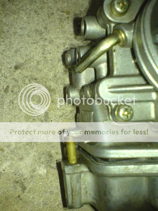

Although, one of the carbs (I think its the left one) Has a small brass tube missing on the edge of the float chamber that appears to connect the two halves of the carb together. I don't think its a major problem as it looks like it is from an overflow or something.
Anybody got any ideas what it is?
Pic please - then I can check on my spare LC carbs exactly what it does.
Its not like the pic that CHR15 posted, its actually embedded in the edge of the float bowl. Its only about 1-1.5cm long.
PostPosted: 11:54 - 28 May 2009    Post subject: Reply with quote
Sounds like the power jet fitting to me.
Does it look like this?
https://i15.photobucket.com/albums/a376/ms51ves3/DSC01039.jpg
If so, it's important. Your bike will run lean at the top end of the rev range without a tube between the two fittings pictured.

I was thinking power jet pip as well. The piping on one was missing on the TZR250 which might explain why it was down on performance.
Piccy would be useful. Could be someone has fitted later carbs.

It doesn't stick out of the float bowl, it is embedded in the side of it.
The carbs are definately 4L0 carbs because they have no vacuum connection.
