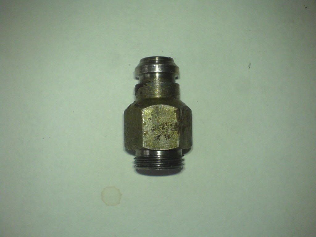

I had 3 tests to do.
The Control: Water
Test 1: ASDA's Smart Price Vinegar (13p per pint)
Test 2: ASDA's Smart Price Cola (17p per 2 litres)
As I only had two spare choke pieces, I did the water test on one, then the cola test on the same piece.
All tests were done for 14 minutes.
Before:
https://i15.photobucket.com/albums/a376/ms51ves3/DSC01067.jpg
After water:
https://i15.photobucket.com/albums/a376/ms51ves3/DSC01070.jpg
After cola:
https://i15.photobucket.com/albums/a376/ms51ves3/DSC01073.jpg
After vinegar:
https://i15.photobucket.com/albums/a376/ms51ves3/DSC01069.jpg

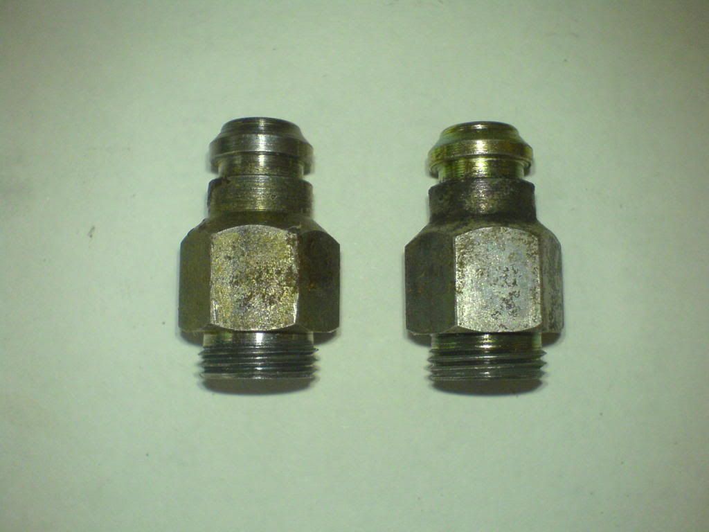

Vinegar on the left, cola on the right:
https://i15.photobucket.com/albums/a376/ms51ves3/DSC01074.jpg

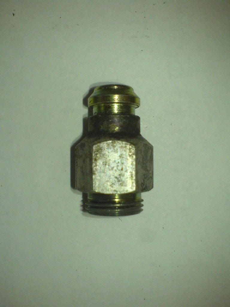

Water did very little.
Cola removed quite a bit of the corrosion and dirt, but not as much as vinegar. It was not as harsh as vinegar and underneath the dirt the cola sample was much shinier.
Vinegar removed nearly all the corrosion and dirt but attacked the metal quite a bit leaving it very dull. I put it back in with the cola after the tests and a lot of the dullness disappeared.
Personally I think cola at 8.5p per litre is a bargain degreaser/cleaner and you can drink it too Wink If you have really dirty items though, a bit of vinegar and some ultrasonic sound waves and it'll come up nicely
