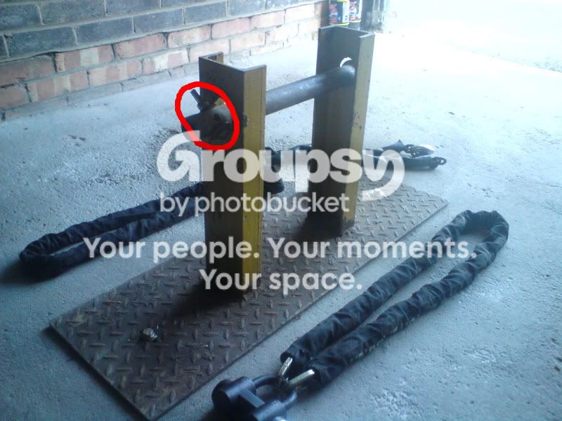

So it was time for some home DIY and this creation was born ....
https://img.photobucket.com/albums/v635/makaveli_rydah/My%20Bikes/DSC00062.jpg
It's a 1/2" thick metal floor plate anchored to the ground , attached to that (welded ) is 2 half girders with a 4" thick scaffold pole inserted between and bolted down . Also i've chewed the heads up on the bolts using an angle grinder so they CAN'T be removed - it's solid as a rock and alot more of a confidence boost .
https://img.photobucket.com/albums/v635/makaveli_rydah/My%20Bikes/DSC00064.jpg
https://img.photobucket.com/albums/v635/makaveli_rydah/My%20Bikes/DSC00065.jpg
https://img.photobucket.com/albums/v635/makaveli_rydah/My%20Bikes/DSC00067.jpg
https://img.photobucket.com/albums/v635/makaveli_rydah/My%20Bikes/DSC00066.jpg
I've also rigged a trip alarm to the garage door (150db) and have a grenade disc lock on the front wheels of both bikes .
What do you think ? Laughing

Nice bike but what chains are those?

Motrax something or another , non descript large chain that i've had for a while and an almax one , but it's not one of the realllly thick ones

Remember that your security is only as good as the weakest link, if you can excuse the terrible pun.

None of them look like Almax chains to me, someone could easy bolt crop all three of those chains in 5 mins.
Almax Immobiliser Series chains are so thick its impossible to get bolt cropper jaws around a link enough for them to bite.

well the sleeve says almax - it's about 8 years old or so and the chains do look a lot thicker in real life

Those chains look piss poor to me TBH. They look like random "heavy duty" chains that you buy from B&Q.
they'll probably crop them within a few seconds.
or they can take a portable grinder to those 2 x m10 bolts holding the checker plate to the floor, or to the m8 bolt that holds the shaft to the 2 girders (therefore freeing the chains)
Or a sledgehammer to the end of the horizontal rod to break off one of the m8 bolt.
And that oxford U shaped lock is really not worth using at all, all the outer shell is plastic and really really easy to snap.

I realise it isn't a total solution package , but as said above if they want it - they'll have it ! .
Also taking a grinder will make a lot of noise - as will the alarm on the door Wink
I've just tried to cover myself as best as possible

you can have all those chains and locks, but your main weakness in that setup is still that m8/10 bolt you have going through the bar, they could just crop that off and free all the chains, or use a spanner on it if you haven't mulletered the head off it.

more welding tbh,

The heads chewed up on it and i tried to get some cutters on that i had and they wouldn't go round as there isn't the clearance .
To be honest it's just a setup until i can get the floor dug up and get a Y anchor concreted in .
