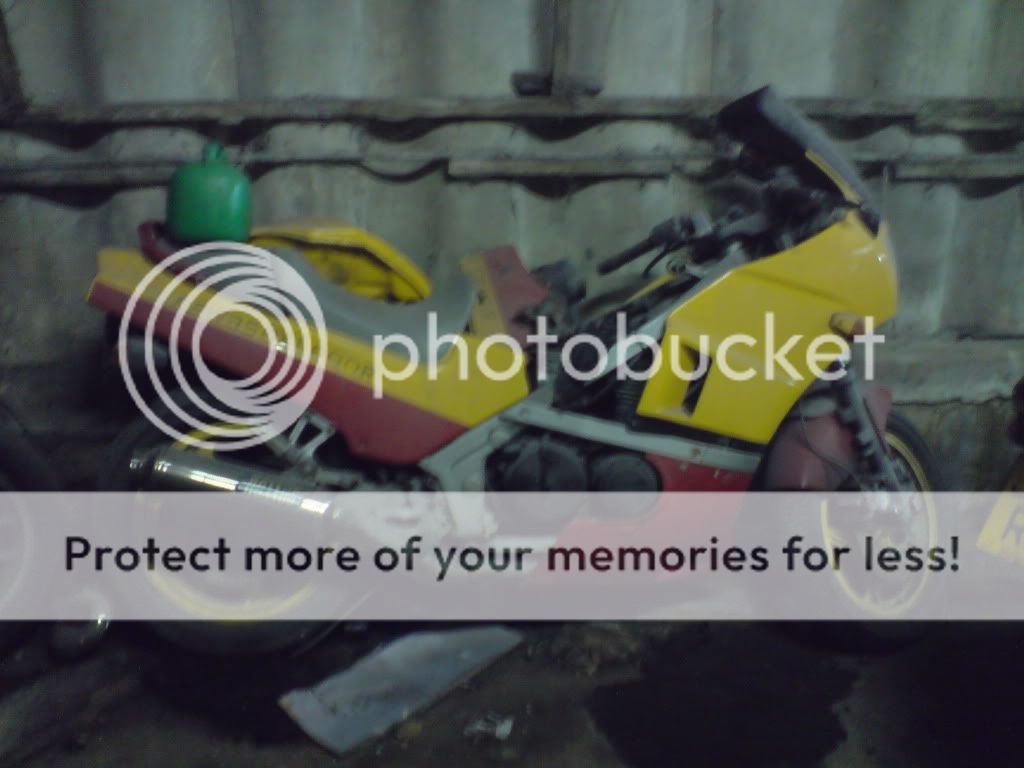

The reason im so intent on spraying it black and red is as follows.
https://i624.photobucket.com/albums/tt325/duncdmc/DSC00120.jpg?t=1248980688
Covered in dust but that's easy to fix.
Also has a nexxus 4-1... Any comments?
Will update in two weeks when i collect it Smile

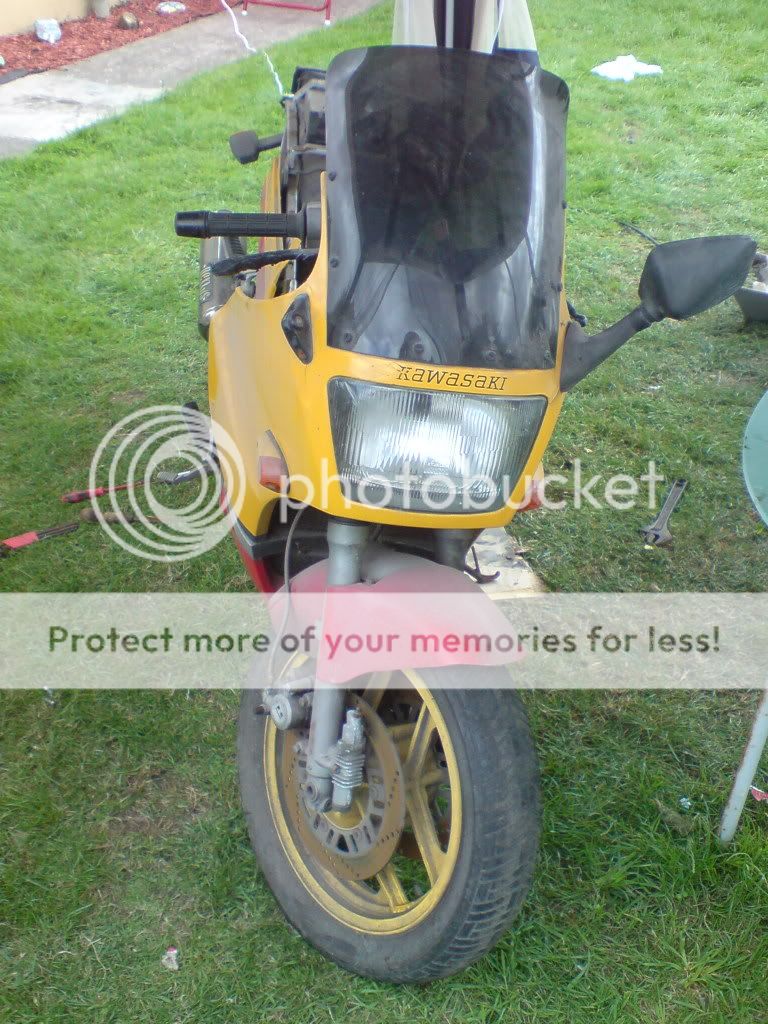

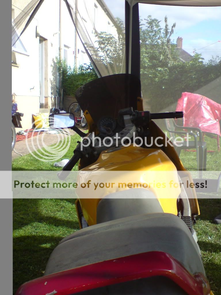

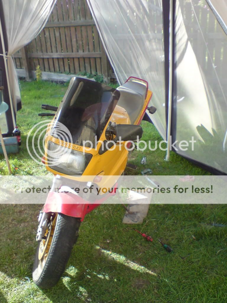

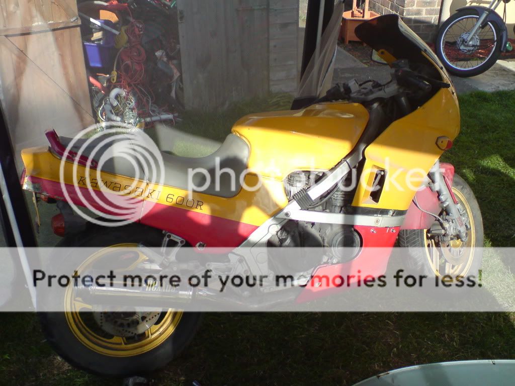

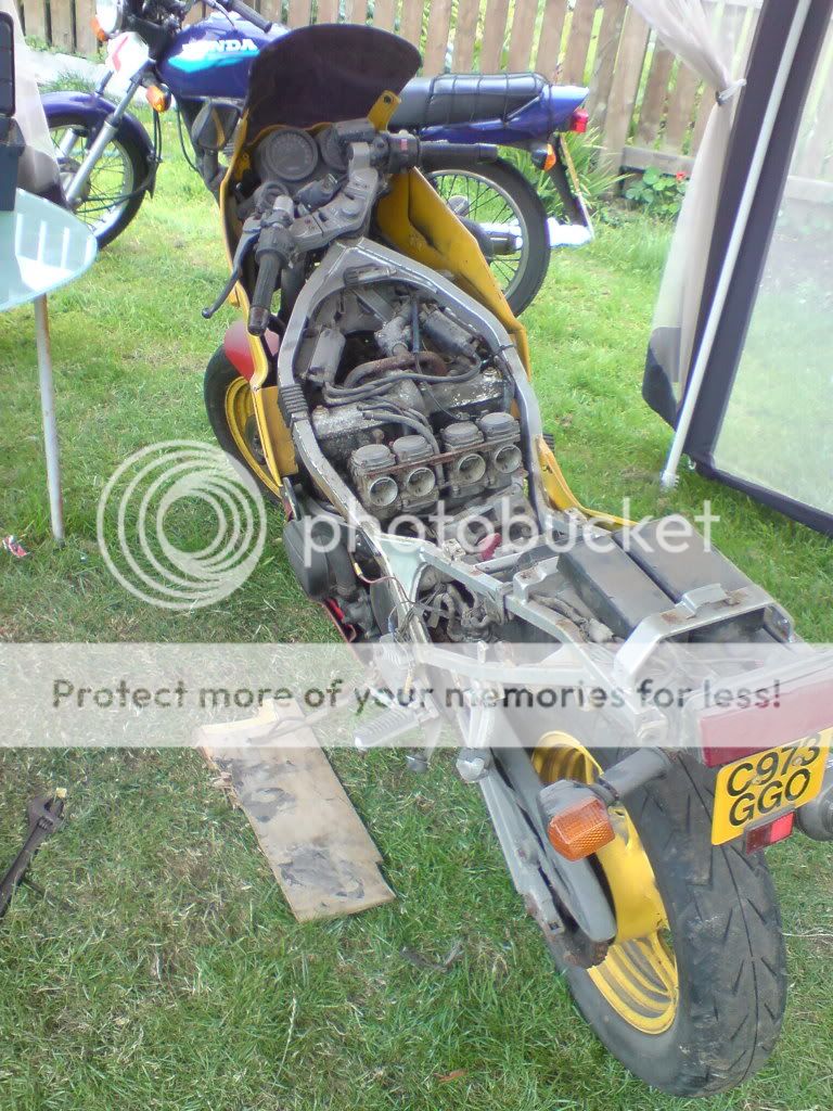

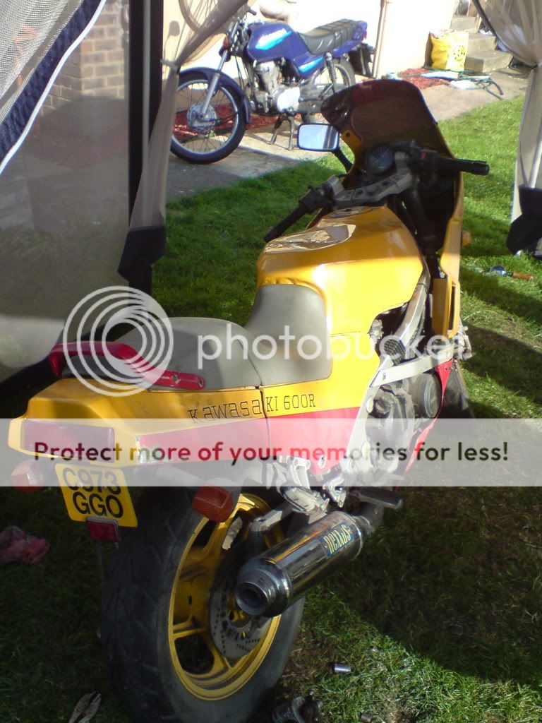

Heres some pics Mr. Green
https://i624.photobucket.com/albums/tt325/duncdmc/DSC00134.jpg?t=1249145632
https://i624.photobucket.com/albums/tt325/duncdmc/DSC00135.jpg?t=1249145653
https://i624.photobucket.com/albums/tt325/duncdmc/DSC00133.jpg?t=1249145692
https://i624.photobucket.com/albums/tt325/duncdmc/DSC00132.jpg?t=1249145762
https://i624.photobucket.com/albums/tt325/duncdmc/DSC00131.jpg?t=1249145839
https://i624.photobucket.com/albums/tt325/duncdmc/DSC00129.jpg?t=1249145866
https://i624.photobucket.com/albums/tt325/duncdmc/DSC00128.jpg?t=1249146001
https://i624.photobucket.com/albums/tt325/duncdmc/DSC00127.jpg?t=1249146026
The CG looking on in awe Laughing
Unfortunately, needs a complete engine rebuild, New tank, the calipers have siezed and more or less every bolt and screw is stuck.
Got them in the end though, so just got to get the engine rebuilt first...
Will update when i get the bloody plastics off.
Might just take off the indicators and mirror/screen and rip the thing off.
A new one is about £30 on ebay.
all the brackets are fudged anyways.
After the plastics come off the brakes are the first priority, as i can't move the bloody thing without a mate helping.
Oh yeah, front tyre is flat.
Plenty of trim left on both tyres, wheels are immaculate.
New brake disks and plastics, battery and tyre tube = about £150.
Still on budget, that's £250 getting it moving.
Engine shouldn't cost much to repair, £50 to buy the oil, oil filter, coolant, and carb cleaner.
Will update when i get the calipers off, then ask for help as i have no bloody idea what i'm doing Laughing
Edit: needs C&S kit Thumbs Up thats another £40?
Cheers
Dunc

PostPosted: 17:58 - 01 Aug 2009    Post subject: Reply with quote
Something tells me we mean different things when we say engine rebuild.
At the very least, taking the top end off and fitting new rings and lapping in the valves will cost you £100 in parts and tools.
If the engine is actually damaged, then the most likely cause is from running with no/low/filthy oil. In that case you'll be sorting the mains, big ends, little ends, piston rings, cams, and lapping the valves. New oil pump while you're at it.
If the engine is goosed then a replacement engine is the way forward.
Also, I recognise the tread pattern on that front tyre - metzeler laser something, extremely old. If it's as old and perished as it looks, you'll be wanting new tyres.
C&S kit should be around £80 for the cheapest.
Where's the airbox?
