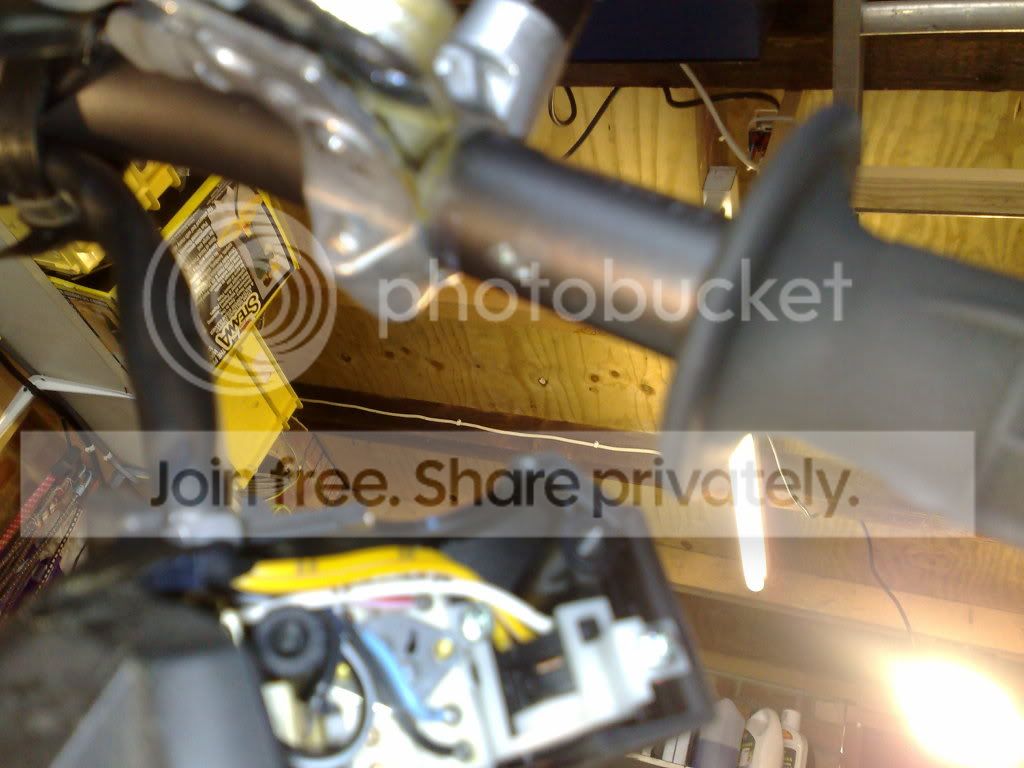

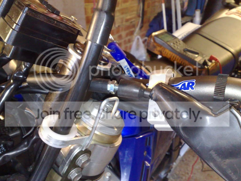

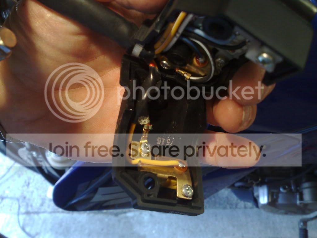

right guys, i found it. It was the a wire in the handle bar switch housing was touchting the handle bar which made the cable live (12v i tested it) and the 2 adjuster nuts where touching the little arm retainer thing where the clutch cable should sit, thus grounding the cable causing a short
pics to help explain my 12 hour ordeal diagnostics lol!
Thanks to everyone who helped. i would be stuck without you all.
see where the black insulator has melted..
https://i236.photobucket.com/albums/ff280/zetecy/18062009904.jpg
see the heat damage/contact to the handle bar

and where its shorting that adjuster nut VS the retainer arm thing(grounding)
https://i236.photobucket.com/albums/ff280/zetecy/18062009906.jpg

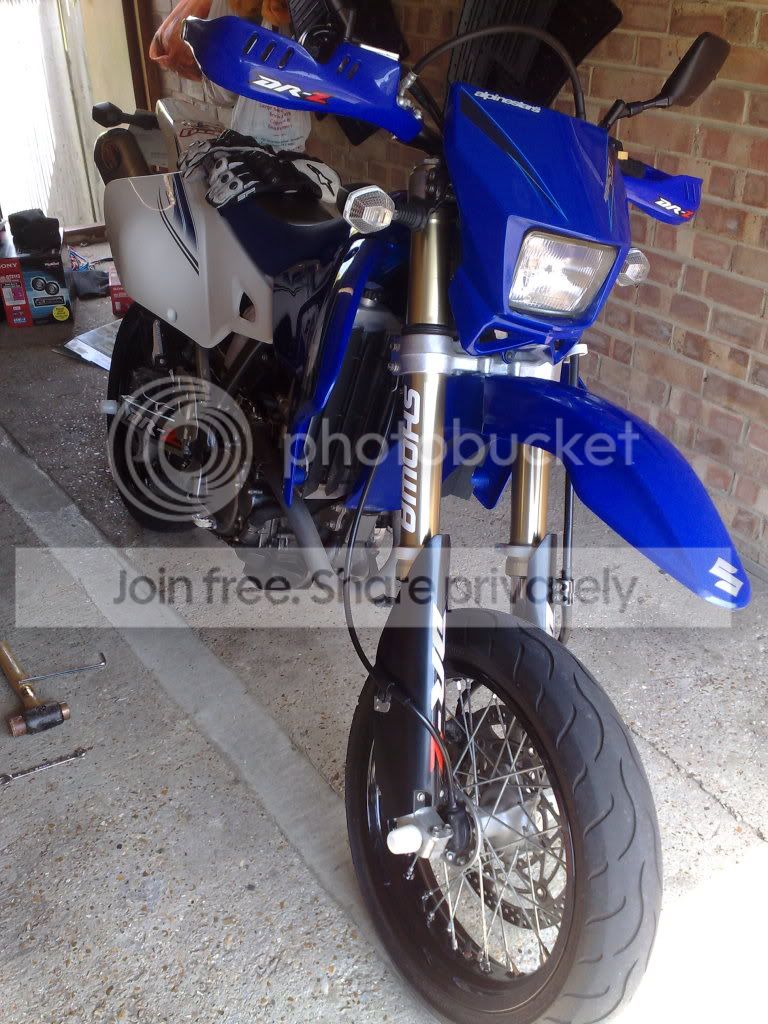

here she is all working!
https://i236.photobucket.com/albums/ff280/zetecy/11062009897.jpg
