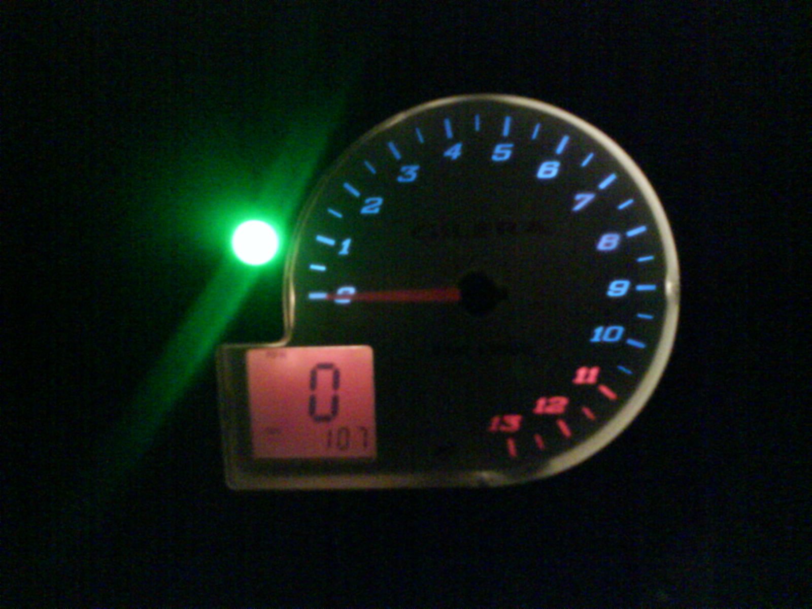

Hutchysrs50
Joined: 15 Sep 2008
PostPosted: 23:08 - 19 Jun 2009    Post subject: Reply with quote
tutton wrote:
Nothing you really need mate, just keep a regular check on the plug, oil (personally id only start by buying a 1litre bottle and buy more when needed)
check coolant, although wont be issues there being a new bike,
apart from that just remember to let it warm up to around 65ish degrees before giving it hard abuse. Before that will most likely cause some engine damage, i take it that its got a engine temp gauge or lcd?
sadly not!!
the clocks are very good tho
have how many miles till the next service when you first turn them on.
a clock (time)
mileage
trip
petrol gauge (how many miles you can do untill the petrol rurns out)
but cant see anything to do with temp.
Gilera SC 125 - Current
Hutchysrs50
Joined: 15 Sep 2008
PostPosted: 23:11 - 19 Jun 2009    Post subject: Reply with quote
i think they look stunning aswell.
https://www.bikechatforums.com/files/dsc00648_116.jpg
