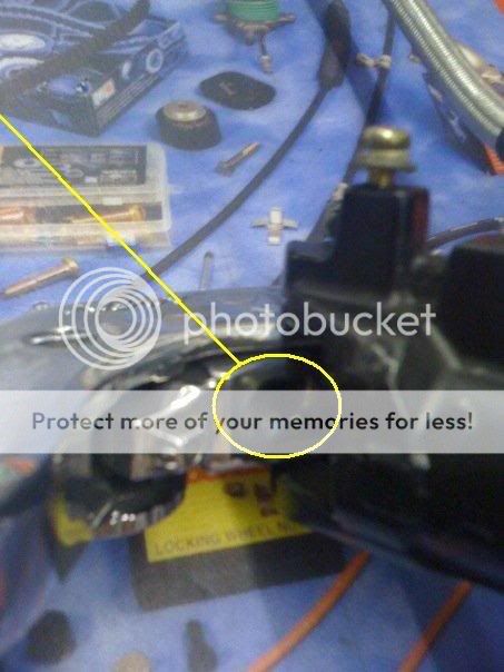

Right as some people will no im doing a master cylinder conversion as srad brakes are a bit poo.
Now so far iv'e bought , a K5 600 MC , a HEL adaptor , and a K5 lever.
But im missing the little rod that goes into the lever and pushes on the cup of the MC does any body know if my standard SRAD bolt will fit ???
https://i210.photobucket.com/albums/bb259/Squeaky_86_2007/gixermc1.jpg
It goes in that hole and pushes,

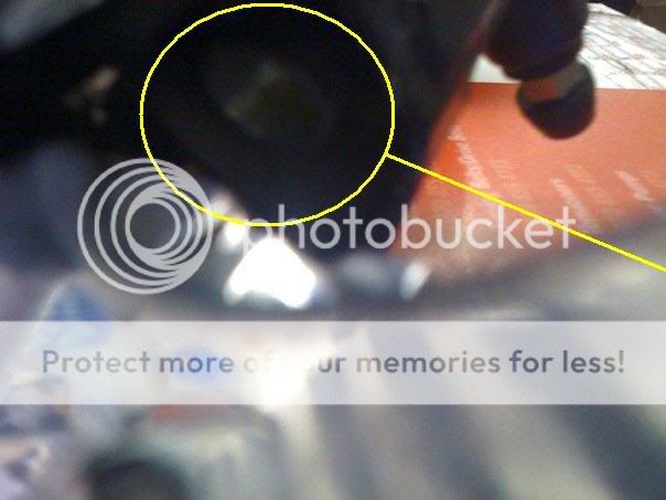

https://i210.photobucket.com/albums/bb259/Squeaky_86_2007/gixermc2.jpg
this bit in.

That is usually part of the brake lever itself, is that not the case on the GSXR?

Yes, it should be on the lever - it will push the piston into the MC.

There not on the K5 it seems.
