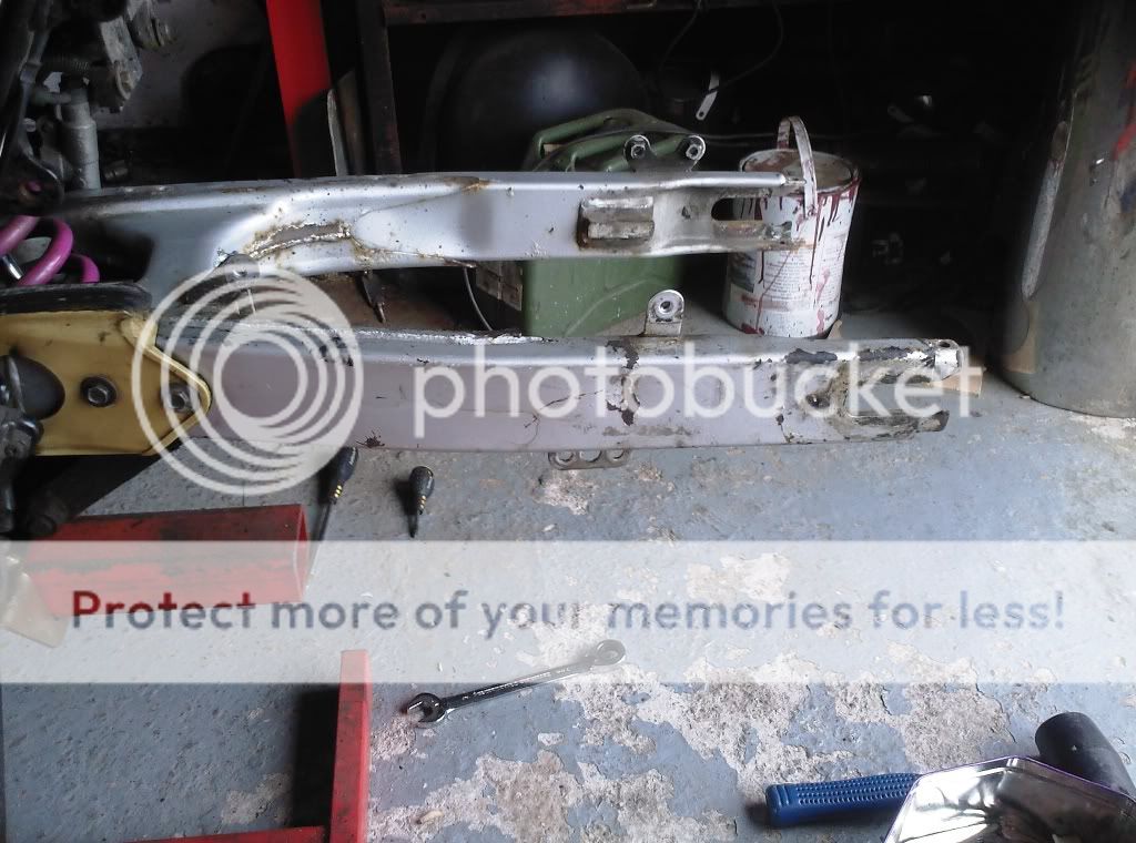

Got tired of looking at my manky rusty swingarm so decided to give her a good old restore today.
This is how it looked before i started

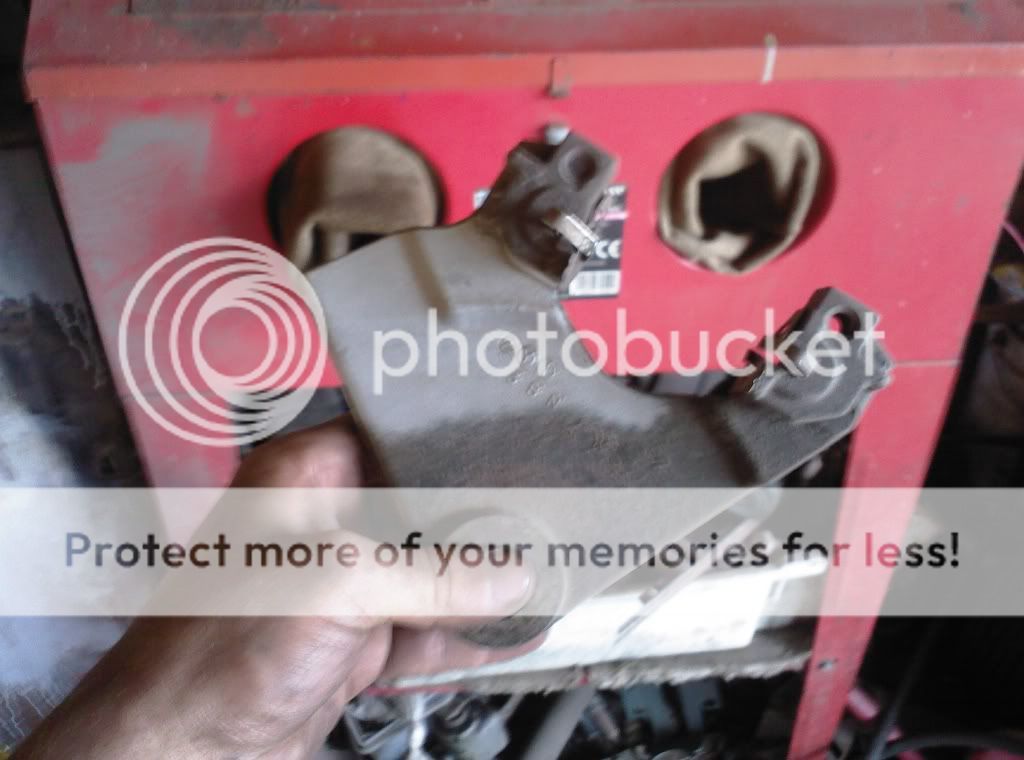

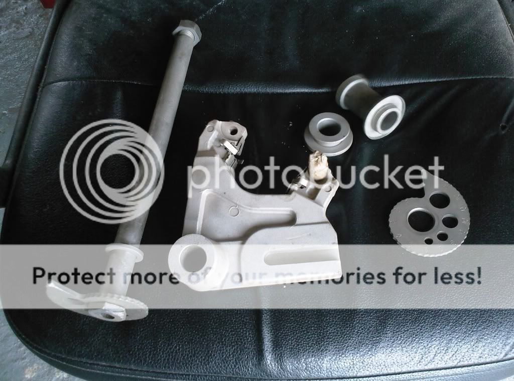

Then started sandblasting parts of my brake caliper and wheel adjusters and things.
https://i250.photobucket.com/albums/gg276/oJaXo/Photo051.jpg
https://i250.photobucket.com/albums/gg276/oJaXo/Photo052.jpg

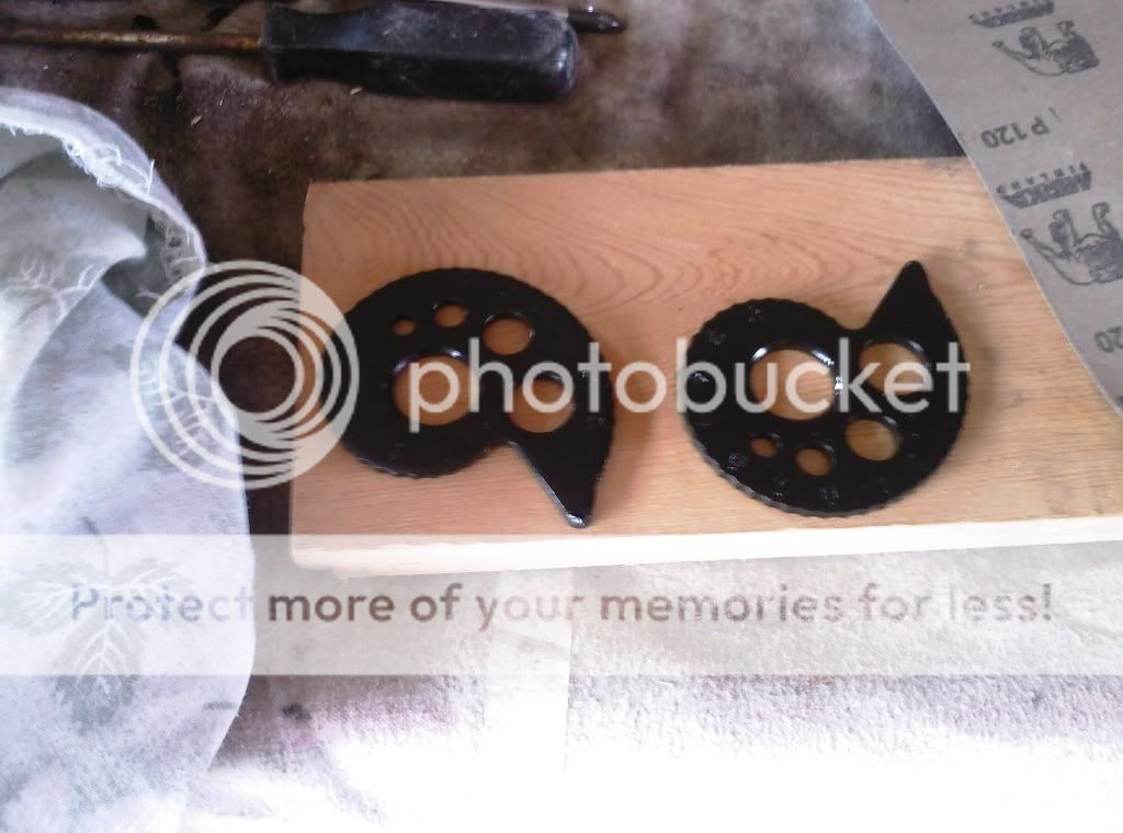

Bit of paint on the adjusters
https://i250.photobucket.com/albums/gg276/oJaXo/Photo054.jpg

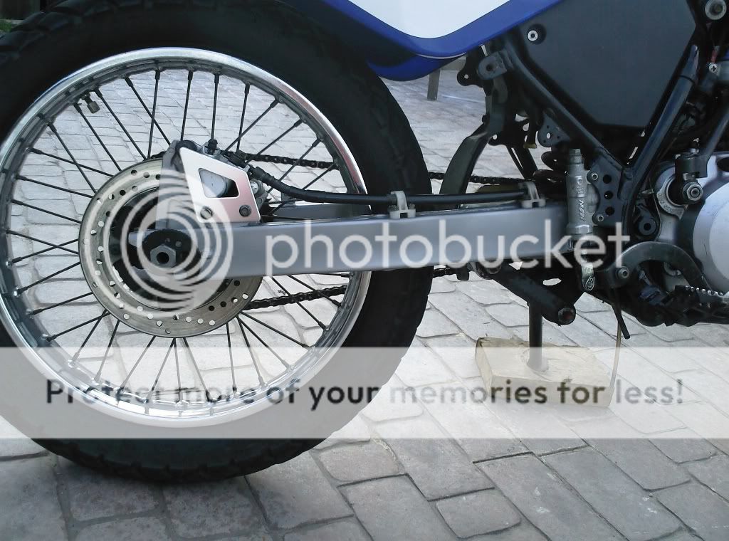

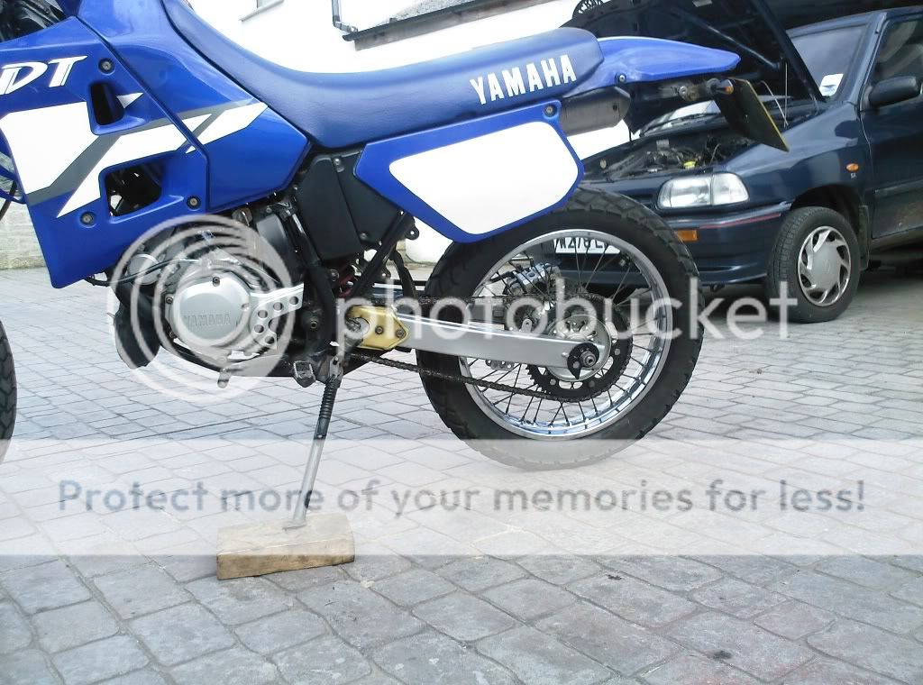

Put everything back on and im pretty damn happy with how it turned out Very Happy
https://i250.photobucket.com/albums/gg276/oJaXo/Photo055.jpg
https://i250.photobucket.com/albums/gg276/oJaXo/Photo056.jpg
https://i250.photobucket.com/albums/gg276/oJaXo/Photo057.jpg
https://i250.photobucket.com/albums/gg276/oJaXo/Photo059.jpg

Looks good mate but your chain is too tight.

yeh thats way too tight.. should be an inch to an inch and a half when the bike is upright under its own weight... I got MOT advisory for my chain and it was set according to service manual

and dont worry about the chain tension i just put it on quickly yesterday so i could get some photos while the sun was still out.
I adjusted it to the right tension after i took the photos Thumbs Up
