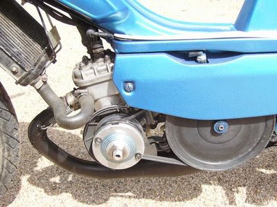

Mobylettes have tiny variators. That's why when you rev them the engine rocks backwards.
https://4.bp.blogspot.com/_l7298LIzt5Q/SYiJXkYryOI/AAAAAAAABqo/H3XaQnyirKo/s400/liquid.jpg
The front pulley is a variator. Ignore the fact that this one is liquid cooled Laughing

My mobylette didn't have a variator!!!
I know some did but mine wasn't one of them!!
