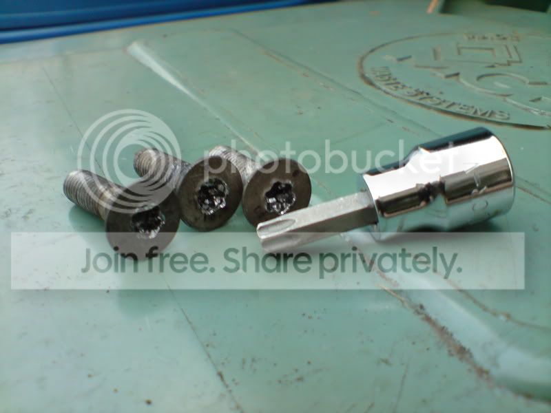

Halfords pro torx bits FTW Thumbs Up
Had same issue with some disc bolts...
