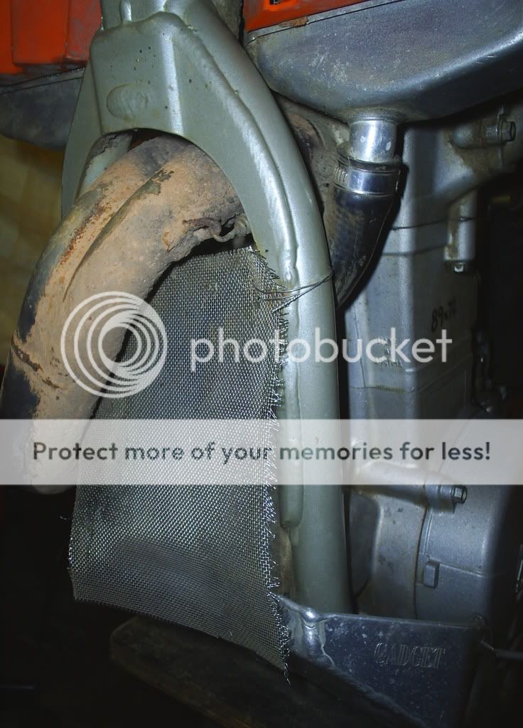

My KTM450RFS has twin exhaust ports
https://i666.photobucket.com/albums/vv23/WiNot_Rhencullen/Workshop/Picture212.jpg
but is joined at the nearest point to the cylinder head so that KTM were able to narrow the twin downtubes of the frame accordindgly.The older KTM400RFS bikes c.2002 had twin header pipes that joined just before the secondary length.I seem to remember reading that KTM found that twin downpipes had less gasflow than a single,hence the switch c.2004.
