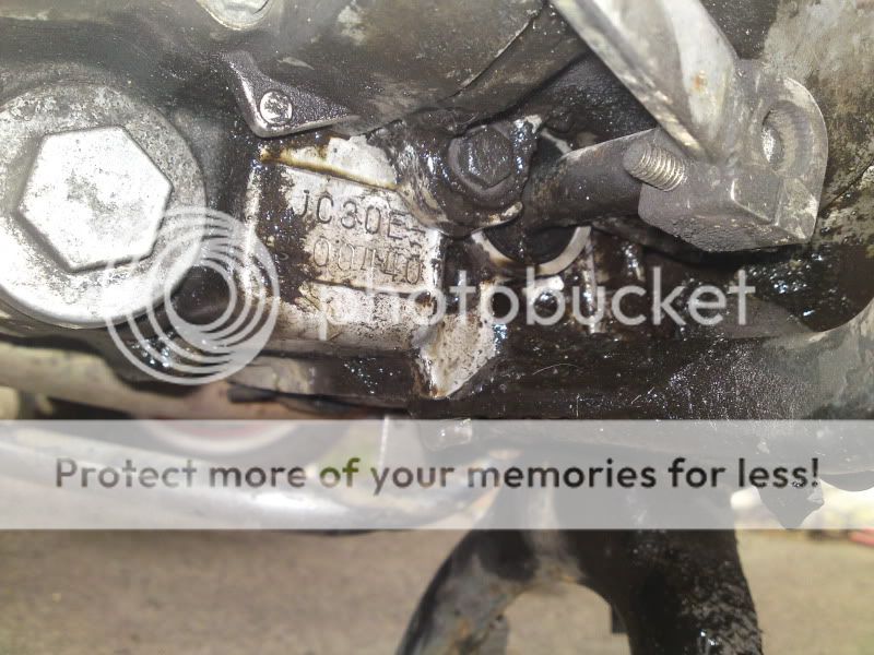

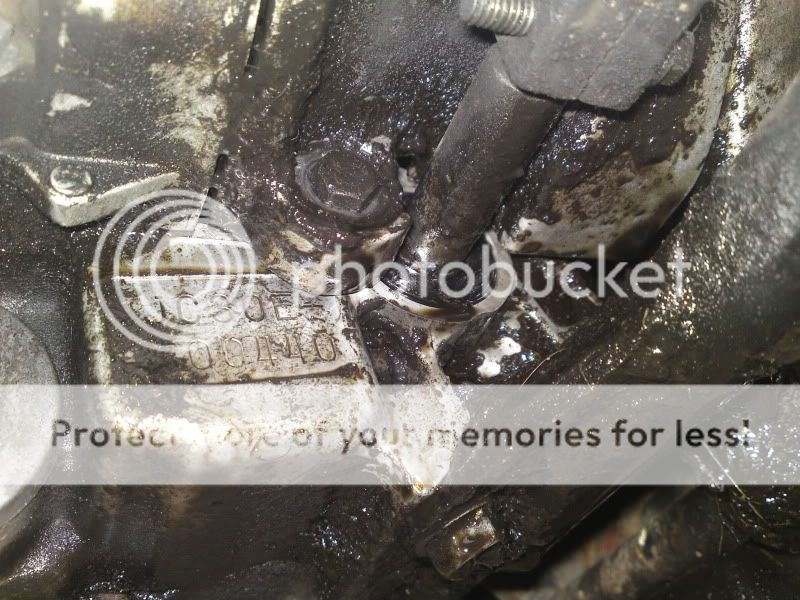

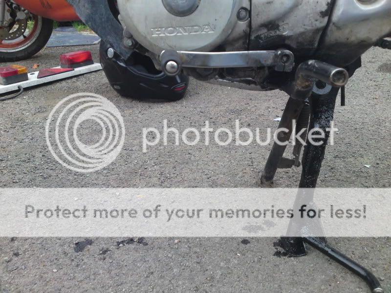

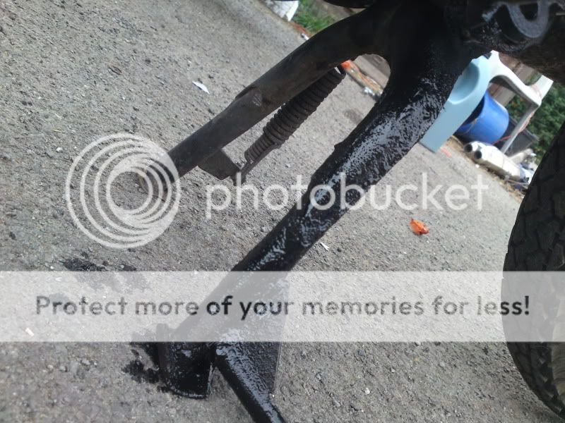

I think I have an oil leak... but I can't seen where it's coming from. It's basically been happening as long as I've owned the bike but when the engine reaches higher temperatures only then oil seems to start dripping down. It's incredibly slow but I don't know where it could be coming from.
https://i8.photobucket.com/albums/a27/alsweetex/DSC00257.jpg
https://i8.photobucket.com/albums/a27/alsweetex/DSC00258.jpg
https://i8.photobucket.com/albums/a27/alsweetex/DSC00259.jpg
https://i8.photobucket.com/albums/a27/alsweetex/DSC00260.jpg
Even while this is happening I only have to change the oil every 3000 miles or so.... so I'm wondering if it's just chain lube being thrown off the chain to eventually dribble down my center stand when this gunk is heated up?
And yes, I've tried cleaning this stuff up a couple times but it seems to come back Confused it was a lot worse behind that metal casing hiding the sprocket. I'm probably just not being observant enough to figure this one out.
Is it possible that my engine is leaking from the gear change lever or the front sprocket that drives the chain? That's where it seemed to be the messiest.

looka like it might be coming from the gear shaft seal...
am i alone in thinking that bike needs a f*cking good clean? lol

my money is on output shaft seal, not gear selector shaft.

lol, thanks guys. So most likely gear shaft seal or output shaft seal. It seems to be a slow leak but all the same, would I have to get someone to take apart the engine to find out which of these it is and replace the seal?
Personally I think it's the output shaft seal Sad

dont need the engine apart. just screw a woodscrew into the old seal and yank it out with pliars.
need to take off the sprocket first though.

I had a similar situation on my CG when I first got it, it was due to the type of lube being put on getting flung off the front sprocket, once I changed to a waxy lube I never saw those patches of oil again.
However, yours does look like a bit more than I had even though its in the same place so I would get it checked out anyway, hope it works out well for you Thumbs Up
