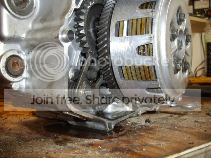

natural for the clutch plates rattling. On my DTR they put a damper ring on the 3rd plate. Oil choice is another factor. The silkoling light gearbox oils seem to be the best choice for me. Try a better oil in the box, see if it cures it..
https://i31.photobucket.com/albums/c357/satelliteone/DTR125_1990/IMGP2720.jpg
Other than that,u may have a bearing on its way out.
