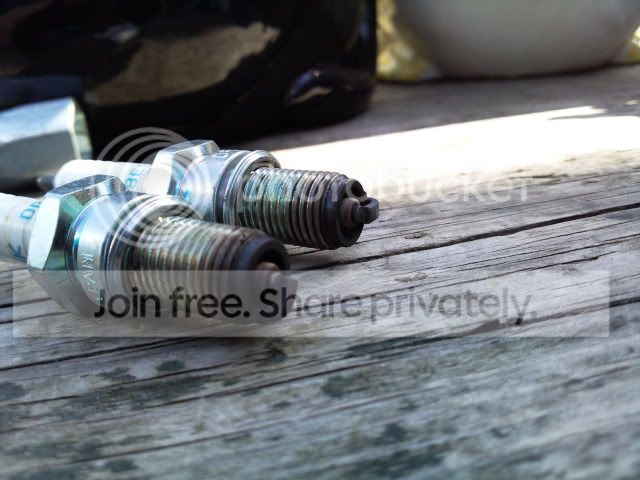

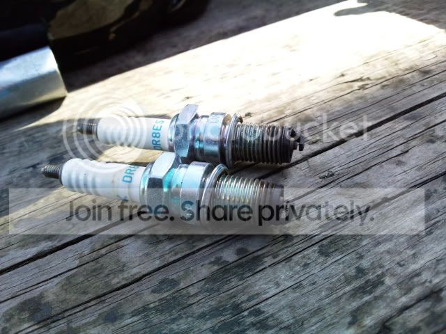

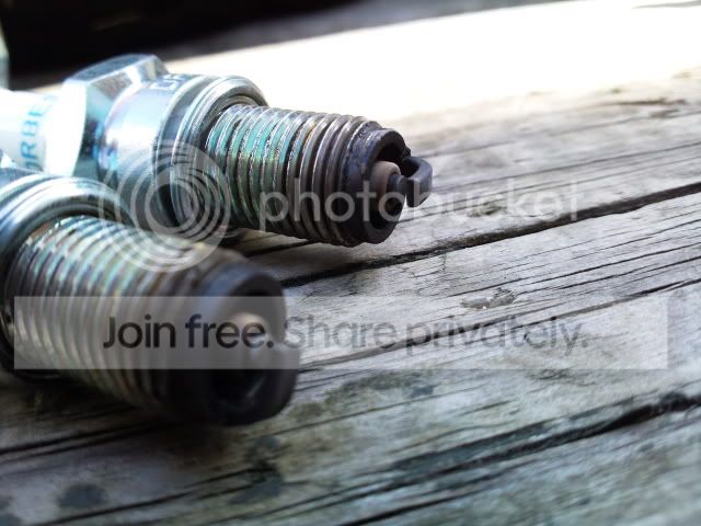

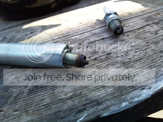

Hi,
These are the plugs out of my CB400N, i took them out and replaced them due to experiencing a 'lumpy' ride, it was lacking power and stuttering. Wouldnt rev up as easily and cleanly as before.
https://i101.photobucket.com/albums/m62/ant-147/Photo0285.jpg
https://i101.photobucket.com/albums/m62/ant-147/Photo0288.jpg
https://i101.photobucket.com/albums/m62/ant-147/Photo0289.jpg
https://i101.photobucket.com/albums/m62/ant-147/Photo0286.jpg
The bike would judder at low speeds and generally just feel 'off'.
The only things ive done recently were chain tension and ever-so-slightly lowered the idle speed as i felt it was just a tad too high, but i dont think that these are related to my problem.
So, just wondering if anything can be said from these snaps, although i appreciate the quality isnt the best and you should also note that the electrode colour is lighter in real life. It looks to be an off-white in real life.

They look fine to me although may be a little old/loose where the threads have discoloured.
PostPosted: 19:34 - 04 Sep 2009    Post subject: Reply with quote
the spacing seems alright, colour is waaaay clearer than mine and looks pretty good to me.
How old are they, could just be nearing the end of their life mate...for about a fiver, replacing them just to see isnt a bad loss!
My GS500 felt like it was limited at about 7000rpm, was just the plugs were damn old and pretty shit.
New set seemed to clear it up and runs sweet as a nut..until i blew fuses everywhere Razz
So how old are they?

Look fine to me too, possibly a little rich but nothing i would worry about.
Were they torqued up correctly?
lonner
Joined: 09 Jan 2009
PostPosted: 20:19 - 04 Sep 2009    Post subject: Reply with quote
they look slightly rich to me .
but in good condition.
if anything they look like they were a bit loose from the gasket compression and the blackening of the threads and would cause lack of power plus shitty running.
did you get a pit pit pit noise from the top of the motor as that would be the cause Thumbs Up

Plugs are fine, loosen the chain back, it is very easy to overtension and wreck a gearbox.
