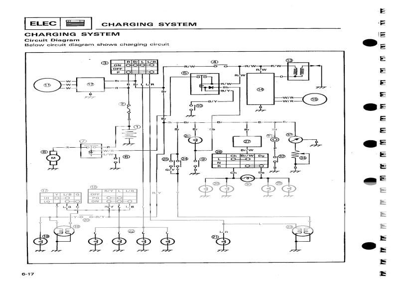

Ahh, now.
I seem to recall the SRX has an odd charging system. Possibly a field coil alternator.
If it does, be careful, they can put out enough power to give you a nasty shock if it comes through unregulated.
You got a copy of the wiring diagram?
deliriousthun...
Joined: 29 Mar 2008
PostPosted: 10:31 - 07 Sep 2009    Post subject: Reply with quote
I do, but I don't have any photo editing software installed just now so I'm afraid I had to copy paste from acrobat into paint, which seems to have streched the image..
Here it is anyway:
Number 11 is the Magneto, 12 is the reg/rec, and obviously 1 is the battery, 2 the main fuse..
https://i71.photobucket.com/albums/i126/deliriousthunder/chargingsystemcircuitdiagram.jpg
Tom
PostPosted: 13:41 - 07 Sep 2009    Post subject: Reply with quote
Fair enough, it's a normal charging system.
Unplug the rectifier box (12) and measure resistance between each pair of the white wires (you're not testing the box, test the wires as they come from the bike). It should be the same between each pair. There should be infinite resistance between each white wire and a frame earth.
If these are ok, your stator coils are pretty certain to be intact.
Measuring voltage between the red wire and earth, you should be getting battery voltage at all times. Between the brown wire and earth, you should get battery voltage only when the ignition is on. The black wire should be connected to earth.
That tests all the wiring to and from the reg/rec.
That leaves the reg/rec itself. You ought to be getting around 14V output when you measure between the two battery terminals.
By a process of elimination. If it is connected properly and the coils are intact and it still doesn't deliver charge to the battery, the reg/rec is dead.
Contrary to what dealers etc would have you believe, you can fit pretty much any reg/rec off a Japanese bike. The wire colours and terminal block shapes are different but the guts of the things do the same thing.
So, if you're happy to cut the terminal blocks off and replace them with seperate terminals, you can fit any old reg/rec. I'd suggest mid 1980's Honda ones as being among the best.

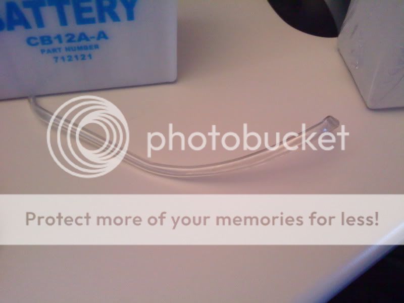

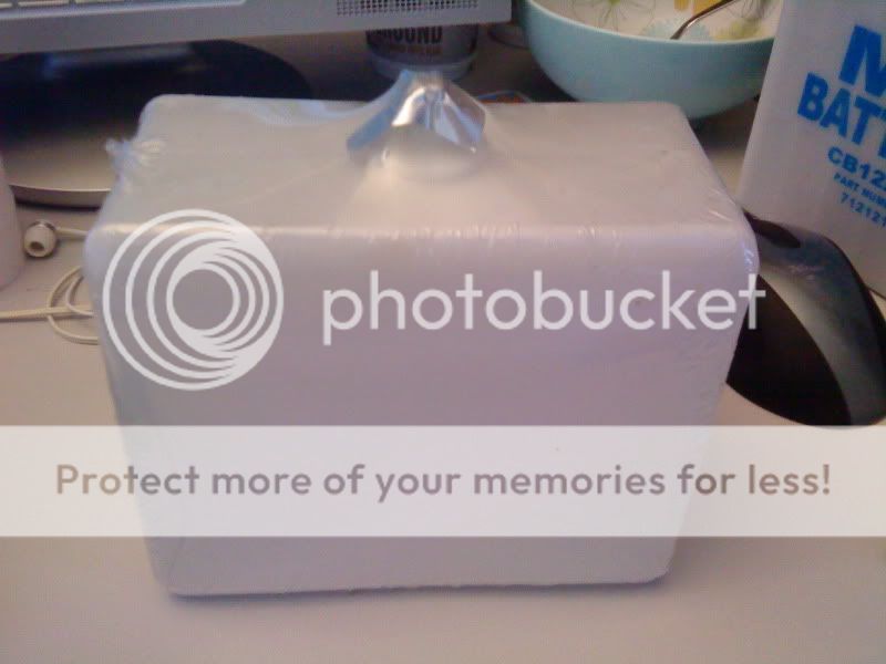

One more thing, any tips on getting this acid:
https://i71.photobucket.com/albums/i126/deliriousthunder/DSC00392.jpg
Into this battery:
https://i71.photobucket.com/albums/i126/deliriousthunder/DSC00395.jpg
And f.y.i, it came with this tube Question
https://i71.photobucket.com/albums/i126/deliriousthunder/DSC00394.jpg
Looks like it goes on the breather nozzle, but my bike has a breather hose to attach there anyway..
The only time I've put acid in a battery before, the acid came in a pack with 6 seperate compartments, each with their own outlet, I just clipped it onto the top of the battery, let it drain and charged the battery up...
This one looks like I'm going to have to fill each compartment individually Question
Can't see how to do that without getting acid everywhere Confused
Tom
PostPosted: 00:21 - 16 Sep 2009    Post subject: Reply with quote
My internet router is on the blink so I can't see your pictures but I presume you have a big bottle of acid and a hose. You cut the end off the spout bit on the bottle, put the hose on the end of it and fill each cell through its individual cap.
The answer to your question is "carefully, while wearing gloves and goggles.". I usually use a big syringe to do the job. You can also get a thing that looks very much like a turkey baster to do the same job. Obviously, don't do it on the carpet. Wash any spills with LOTS of water
