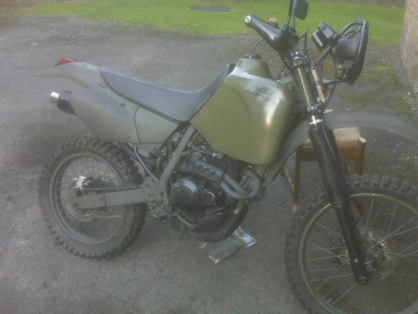

Do what I did, fit some lights of a XR Baja
https://bikechatforums.com/files/new_lights.jpg
https://bikechatforums.com/download.php?id=68329
https://bikechatforums.com/download.php?id=68328

Yep now I see, damn thats an ugly light! how effective is it out of interest?
eddclarke
Joined: 10 Jul 2006
PostPosted: 21:13 - 04 Oct 2009    Post subject: Reply with quote
Ugly? I love it, makes it look like some mad robot!
When the electrics are all sorted, they should be pretty bright, but I may need to upgrade the stator.
