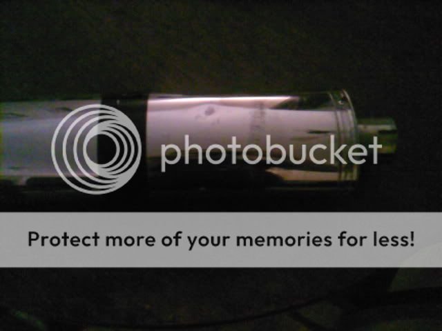

Almost done! Getting the spout end back on was a bit of a pain, was filing away thinking that would help me slip it back in so to speak. Well it didn't, but the hammer I used worked wonders Very Happy Just need to rivet it all back together, using aluminium rivets at the moment, cant find any better ones anywhere. I plan to upgrade them in the near future (unlikely!)
https://img.photobucket.com/albums/v690/kant_sk8/DSC_0163-1.jpg
