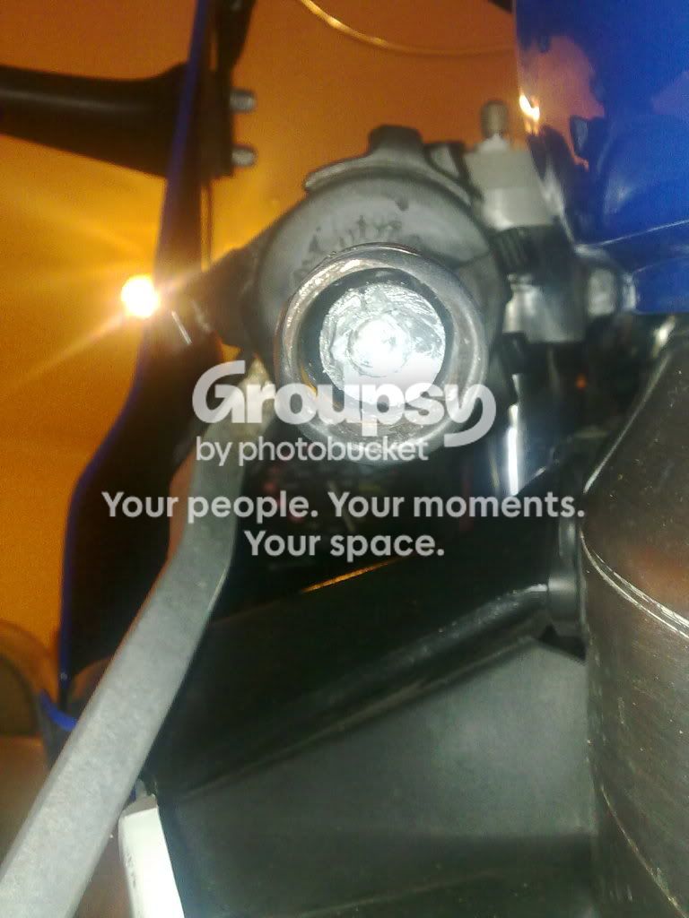

3. Bar ends. My left (clutch) side clip on has had the insides well and truly mashed, loks like someones tried to drill it out and failed, should I just replace the whole bar, or can I get the inside replaced? I can get the whole bar for £15 delivered so might just do it to save the hassle.

With the bar, take it to an small engineering shop and see if they can drill out the remains of the old bolt (assuming it is a bolt through the bar end weight).

the bar weight itself is ok, its the bit inside the bar that the weight screws into thats been mashed, i've tried unscrewing it, but it didnt seem to be coming out, so have bought another clip on for £10 Smile

Got a pic of the bar thats giving me grief. I sat with a pair of pliers and turned the bit inside for ages and made no progress at all Sad I've bought a second hand bar now, so should be ok Thumbs Up I also got a new set of bar ends because the L/H one had loads of electrical tape round it and they were Farbon Sick so got black anodised aluminium ones (they have got a strip of real carbon fibre though, but were the best there)
Here's the picture Smile
https://i207.photobucket.com/albums/bb73/sam_billing_91/14112009202.jpg
