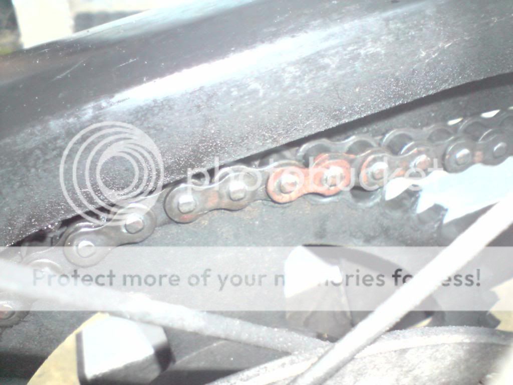

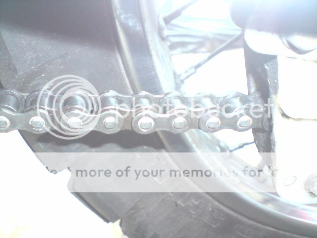

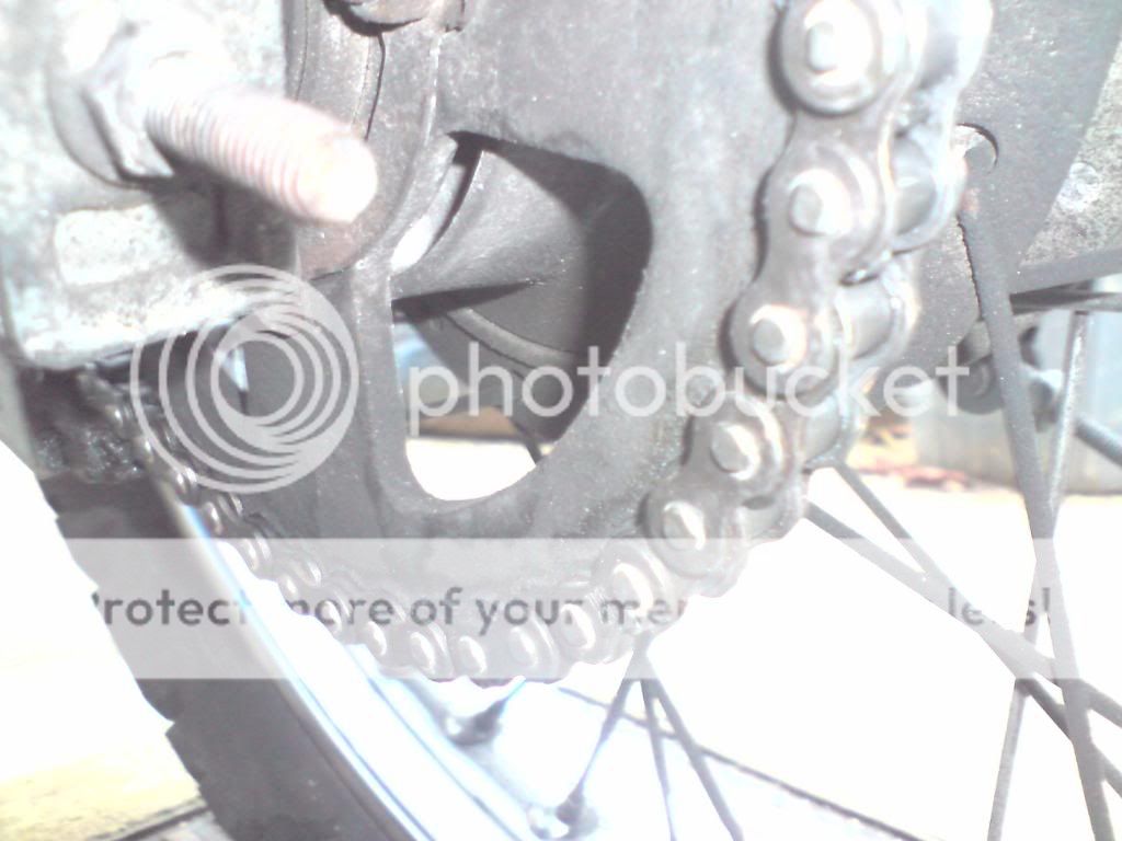

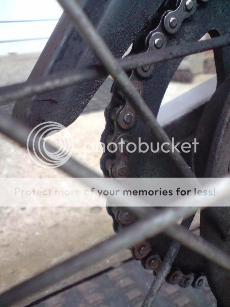

Right, i have some pictures, which should hopefully provide you with enough information to determine what i should do.
When i went to take these photos, i have to admit, it does appear to be surface rust.
My sprockets don't look that worn either, but that's my opinion, and i'm sure you guys will be able to tell.
Here are the photos:
https://i657.photobucket.com/albums/uu299/milkster125/P161209_1002.jpg
https://i657.photobucket.com/albums/uu299/milkster125/P161209_1003.jpg
https://i657.photobucket.com/albums/uu299/milkster125/P161209_1004.jpg
https://i657.photobucket.com/albums/uu299/milkster125/P161209_100601.jpg
As you can see, the wheel side of the chain is rusty, but there's not a single rusty link on the other side.
I appreciate the help guys Thumbs Up

+1 Sprokets do look worn in the picture, the chain itself looks good ( just normal wear and tear )

I think that picture of the sprockets is a bit deceiving, and the teeth do appear to be worn and pointy.
The thing is, i don't want to have to get new a new chain and sprockets, i really can't afford it at the moment. I no with some Muc Off Brake and Chain Cleaner, i can get a brush in there, and the rust will peel off and the chain will look as good as new Thumbs Up
The sprocket however does look worn, and i can't just buy a new sprocket, it will ruin my chain...
Mmmmmm, might have to keep the bike off the road for a bit until i get the money.
