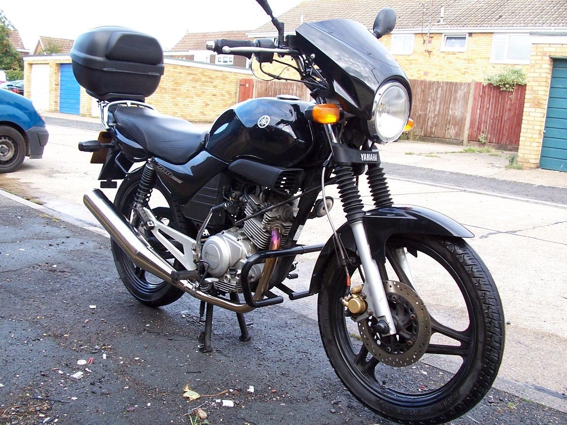

No point in using WD40, it just burns off with the heat. ACF50 is pretty good on the silencer (and the rest of the bike over winter - get some!) but burns off on the downpipe. They eventually eat themselves from the inside anyway, no matter how much you keep the outside clean.
After 2 and a half winters from me, my '05 YBR's original exhaust was a rust magnet, sections where I couldn't get the ACF50 on were blistering and rusting away. Under the chrome it's mild steel which corrodes quite quickly, especially in winter. The difference with the '07 YBR is that they painted the pipe and silencer with some kind of HT paint but I have seen rust getting through it pretty easily so I'm not sure if it's any better than the old chrome systems. You could repaint it and I'm sure someone more experienced than me will be along soon to share their experiences with the best paints suited for the job as well as the best methods of applying them. Certainly a cheaper long term option. As long as the system is still structurally sound, and has no nasty holes, it'll pass an MOT, despite it looking disgusting.
In my case, as I plan to keep the bike forever and have little time for things like this which will keep it off the road for a few days, I replaced my rusted exhaust with a Motad stainless steel kit that won't suffer the same fate - stainless steel corrodes very slowly, and the exhaust will probably outlast the entire bike. It does now retail at double the price of a standard system though, although you might be able to haggle them down (I got mine a month or so ago whilst it was hot off their shelves at half price because they wanted feedback on the installation etc).
Shameless photo whore:
https://www.bikechatforums.com/files/100_0623.jpg

Very nice shiny exhaust in the photo Smile. It's difficult to get a really good look of a bike from a photo but your bike looks almost pristine for 5 years old. Seen 2008's looking worse than that pic.
