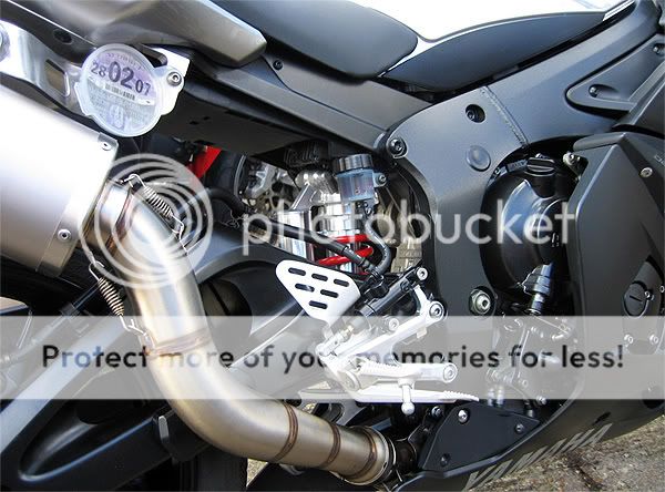

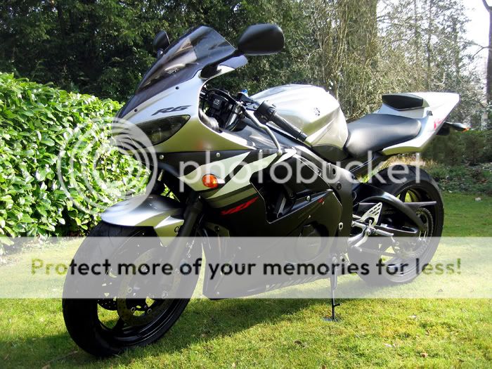

I swear by it.
Copied and pasted from another thread:
I have posted this a few times ... so apologies to those that are reading this mantra for the 17th time... but:
Prior to winter (now?):
1) Remove any fairings , rear pipe, general body work such as seat etc.
2) Clean bike thoroughly with a good detergent/bike cleaner ... use a toothbrush to get to those hard to reach places.
3) Thoroughly rinse the bike with clean water ... and ensure it dries fully (run it for a bit to make sure water is evaporated out of the nooks an crannies of the engine)
4) Get can of ACF50 and a clean rag .... start at one end of the bike .... spray ACF50 onto section of bike (swinging arm?) and rub over with rag.
5) The rag will eventually become saturated with acf50 ... and you can then simply spray onto the rag and keep wiping .. or spray in hard to reach places and wipe.
6) Dont worry about excess ... just wipe it up with the rag.
7) Use rag only for acf50 application (I keep mine in a plastic bag)
You will find that:
a) There is often enough on the rag to do lots of the bike (I am still on the same can of acf50 after 4 years)
b) Use it for plastics .. the lot .. the whole bike (NOT disks or tyres)
c) Takes half a day to clean and then acf50 the bike properly.
d) However, Once done you wont have to re-apply until after winter ... rain and crap doesnt remove it ... it bonds with the surface (to an extent) and is only removed by washing with detergent / scrubbing.
So its a twice year thing .... Once before winter... then after winter clean bike again and re-apply for the whole summer.
My R6 is run all through winter .... rain, salt, snow (ish), sleet .... and still looks like this:
https://i157.photobucket.com/albums/t69/silky666/Bike%20Stuff/afteracf50.jpg
https://i157.photobucket.com/albums/t69/silky666/Bike%20Stuff/r6bike2.jpg

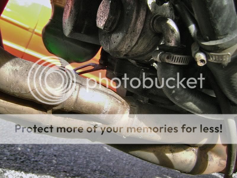

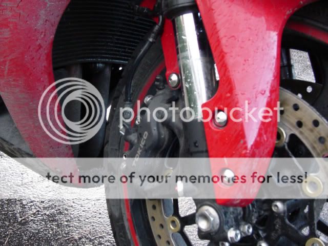

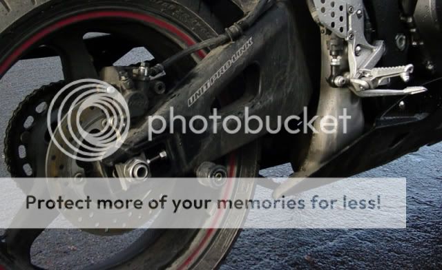

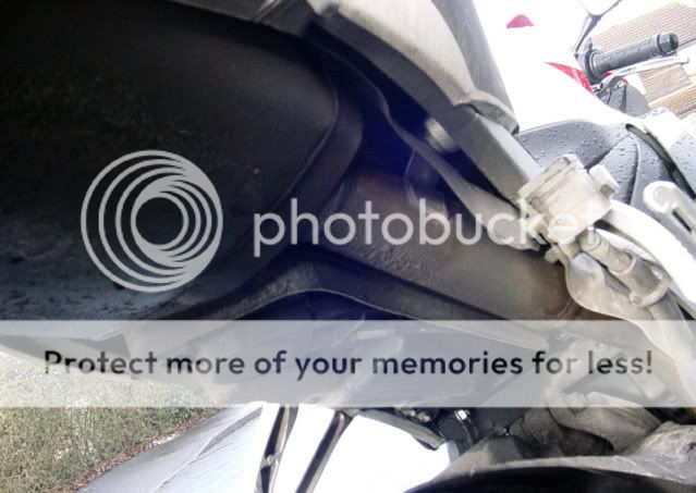

It's by no means a miracle cure. I wouldn't swear by it, it won't keep your bike showroom fresh without some post ride regular rinsing. In my opinion it's also pointless using it on plastic (other than a ridiculously expensive back-to-black)- plastic doesn't seem to corrode too much in winter salt in my opinion.
Also, a heck of a lot of protection is down to your bike's ease of clean/build quality in the first place. For example, my R6 suffered a lot less from winter corrosion by only using WD40, than my CBR did last year using doses of ACF50.
Even only after a week or so of winter commuting, my bikes tend to look like this, so a decent post-winter spring clean is usually needed to keep them looking fresh for the rest of the year:
https://i3.photobucket.com/albums/y51/whers84/Cleaning/DSC01425.jpg
https://i3.photobucket.com/albums/y51/whers84/Cleaning/DSC01420.jpg
https://i3.photobucket.com/albums/y51/whers84/Cleaning/DSC01421.jpg
https://i3.photobucket.com/albums/y51/whers84/Cleaning/DSC00068.jpg
No way would any of that dirt just 'bead off' despite the massive amounts of ACF50 used. It just gets blasted and then baked onto the surface within a matter of miles.
What ACF50 did do, was give it a layer of protection over the bike's poorly finished parts - which didn't save every single component from needing a scrub down ever again, but it did make things a lot easier to keep them looking fresh after winter.
