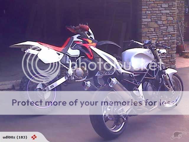

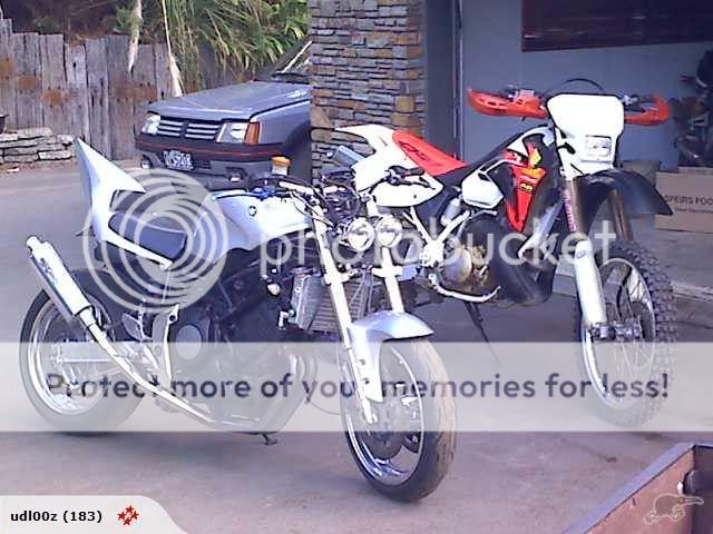

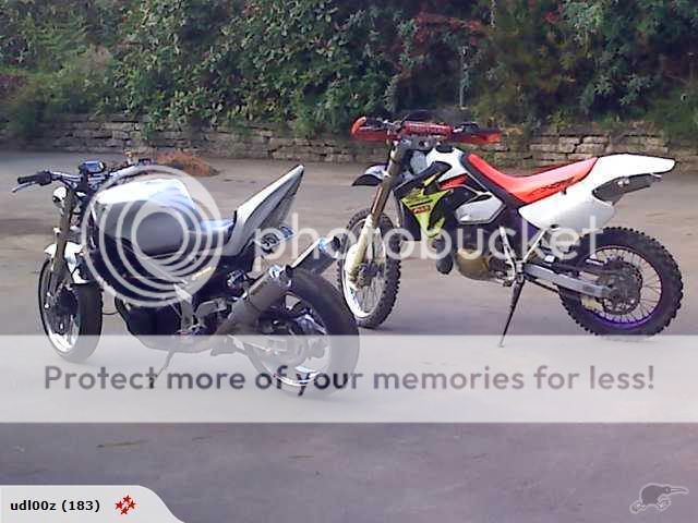

heres one for sale in new zealand at the moment,
its got all the bells and whistles, and according to a dyno print out its pushing 90hp which is pretty impressive
\im trying to swap my vf1000 for it, but im a little unsure if i want to get rid of it,
https://i58.photobucket.com/albums/g257/hmmmnz/108682588_full.jpg
https://i58.photobucket.com/albums/g257/hmmmnz/108682733_full.jpg
https://i58.photobucket.com/albums/g257/hmmmnz/108682459_full.jpg
apart from the twin headlights i really like it,
PostPosted: 08:08 - 04 Feb 2010    Post subject: Reply with quote
Sick the rear end is horrible
PostPosted: 08:39 - 04 Feb 2010    Post subject: Reply with quote
your rear end is horrible Mr. Green
yeah is not what i would have chosen, i think i would have gone for something a bit more subtle, but i kind of like it none the less,
and changing a tail, isnt really an issue, its a good base to start from.
