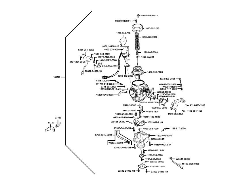

It took a while ago but i managed to track down the exact carb i have, hunted down an exploded view a while back when i was stripping it down but i cant seem to find it now...
I will pull it out in the morning and track it down again...
Interesting you suggest its a bit fast, i thought it was a bit high @ 4000 with the choke but its my first bike...
I remember when i stripped the carb down it all looked okay inside etc.
After a quick look around, this carb, although for a 250 scooter is pretty much identical to mine.
https://www.kymcopartsonline.com/catalog/diagrams/200903041943530.Grand_Vista_250_2008_Carburetor.JPG
All the diaphragms were intact and everything looked clear and good. Will get it off in the morning though.
Any suggestions as to what to look for?

i'd guess that the bits on the left with the electrical connectors relate to the auto choke.
They would be the bits to have a look at.

stirlinggaz
Joined: 22 Jul 2007
PostPosted: 20:40 - 09 Feb 2010    Post subject: Reply with quote
hi,
i had the very same carb on one of my previous chinky bikes.
i can practically guarantee that your issues are carb related +
the auto choke is known for failing.
iirc, in theory theres a pin thats eletrically controlled, that moves up + down the choke passage.
i think it can be tested off the bike with a 12v supply, + you should see the pin move.
theres no user serviceable parts in the auto choke though, its replaced as a unit.
might be worth sourcing another carb.
the guys over on the chinese bike forum will be able to tell you more,as that particular carb is fitted to umpteen chinky scoots + bikes.
but definately sounds like the carb is needing to be set up correctly + maybe needs the choke unit replacing.
the auto choke unit had stuck on mine before i got it, + the previous owner had fiddled about the carb settings (mixture & idle) to compensate for the dodgy choke. Shocked
i removed it with the intention of replacing it, but found that a good clean with cheap brake cleaner freed of the pin in the auto choke. Very Happy
then once it was put back on, i had to return the carb to stock settings.(got these off a guy in the chinky bike forum)

Ps, Nope, its a CVK carb...
temeluchus
Joined: 01 Oct 2008
PostPosted: 01:36 - 11 Feb 2010    Post subject: Reply with quote
https://cgi.ebay.co.uk/GY6-24MM-ATV-MOPED-SCOOTER-GOKART-CARBURETTOR-CARB-NEW_W0QQitemZ190318443885QQcmdZViewItemQQptZUK_Motorcycle_Parts?hash=item2c4fdcfd6d
looks like the same carb.
0l0dom0l0
Joined: 21 Oct 2009
PostPosted: 23:12 - 11 Feb 2010    Post subject: Reply with quote
from all the symptoms and the sound clips, that thing is running horriby rich. auto choke = failed.
just dismantle the whole auto choke unit and seewhat that brings. worst case is you have t buy a new one. im sure thats the problem though. (as everyone else says)
hope this helps
