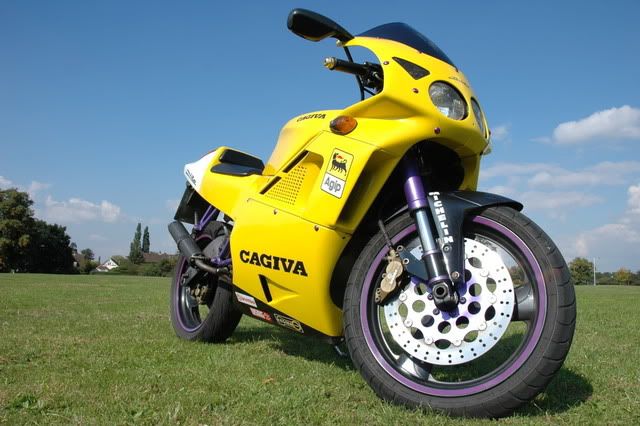

Adrian89
Joined: 12 Feb 2008
PostPosted: 14:16 - 01 Mar 2010    Post subject: Reply with quote
Those are standard mk2 forks and thats a standard mk2 calliper, although usually they are painted gold.
I suggest you contact mmemotorcycles in london for parts, they literally have everything new or second hand in whats seems like an Alladins cave of Mito bits. He's a real mechanic too that isnt out to rip anyone off, he charged me £10 all in to remove a snapped exhaust stud from my NC23 and a snapped jet from a carb (both required drilling and werent easy).
Heres the website:
https://www.mmemotorcycles.co.uk/index.html
Heres a picture of my old bike, I painted the forks, but before this they were exactly the same colour as the ones you have, you can clearly see the calliper is also a 4 pot brembo like the one you have which is standard:
https://i195.photobucket.com/albums/z115/adrianwest1989/My%20bike/DSC_0097.jpg

PostPosted: 14:59 - 01 Mar 2010    Post subject: Reply with quote
Heres the website:
Aside from the purple that looks really nice. Thumbs Up
