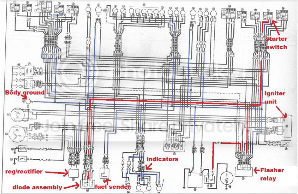

https://i187.photobucket.com/albums/x13/fronterapics/fz6wiring.jpg
In the above pic the L/W (marked in red) wire is the white/blue shown on the starter relay a few posts up.The wires i have marked in blue are actually black.
The white/blue goes through the flasher relay Question - into the diode assembly Question and into the starter button on the bars.
The black wire (earth i'm assuming) goes through pretty much everything Laughing

PostPosted: 10:21 - 17 Aug 2009    Post subject: Reply with quote
Think it isn't just a flasher unit. It is a box of various relays, but probably also controls the cutout to prevent you starting it in gear.

This black wire goes straight to the starter button on the bars via an earth which doesn't look original.
The blue/white wire goes into the flasher relay (it's not just a flasher relay) then onto the second terminal of the starter button.
So basically,i run the blue/white wire directly to the + from the battery and if the selanoid works the bike will start. No start = fooked selanoid ?
