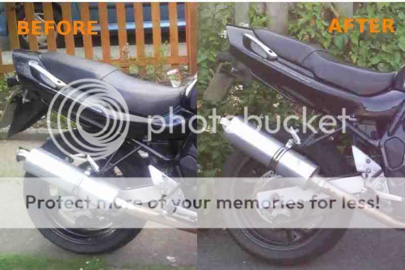

Kirky
Joined: 21 Dec 2009
PostPosted: 11:45 - 11 Mar 2010    Post subject: Reply with quote
Yeah mine looks like the pic on the right.
But I’m not sure what size dog bones I should order, the ones on the bike are 120mm long.
There are 2 kits I can find to lower the bike by 25mm or 45mm.
I don’t want to order the same ones that are all ready on the bike.
