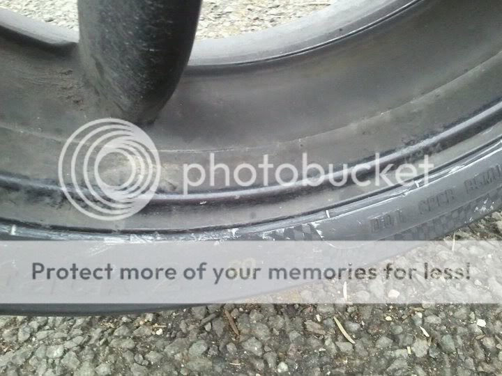

Well I'm taking the wheel back to be rebalanced after work but i was just wondering if the yellow '05' stamped on the tyre wall was anything to do with light or heavy spots as it seems to be bang on opposite the valve....

salty21 wrote:
DonnyBrago wrote:
Balancing isn't just about the valve etc, tyres have heavy spots too (usually marked with a paint blob)
the paint spots are usually fitted in the same position as the valve so i would have thought they marked a light spot.
There are normally a few dots. Can't remember exactly what each means but one (think yellow) is a light/heavy spot and the other is a high spot of the tyre iirc (possibly red). Thinking about it, it would make more sense to mark a light spot to position next to the valve rather than mark the heavy spot to position opposite the valve.
Whenever I have had tyres mounted recently though it seems the techs have proably ignored the dots anyway when using balancing machines.
salty21
Joined: 07 Jun 2006
PostPosted: 18:30 - 04 Feb 2011    Post subject: Reply with quote
on pirelli's there are 2 red dots next to each other about an inch apart. you should line the valve up between those dot's.
