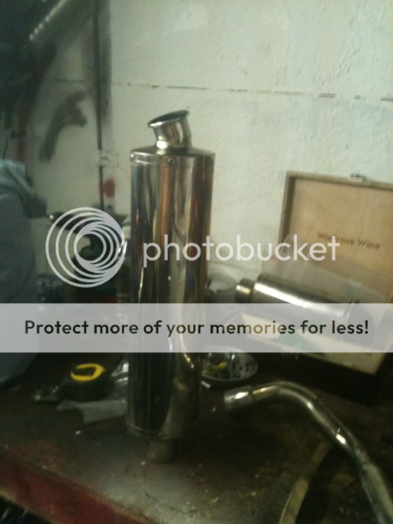

https://i770.photobucket.com/albums/xx346/ThatHornet/4f172120.jpg
This is what it was like, as you can see it looks like i stole a cannon off the set of Pirates of the Caribbean.

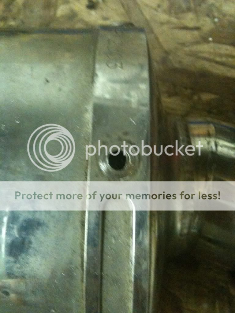

1st job is to drill out the rivets, Taking my time not to snap the bits.
https://i770.photobucket.com/albums/xx346/ThatHornet/6d43d859.jpg
(Photobucket wont rotate this Mad)
https://i770.photobucket.com/albums/xx346/ThatHornet/1d108ec5.jpg
Once the straps removed i can pull the casing off and the inner falls out.

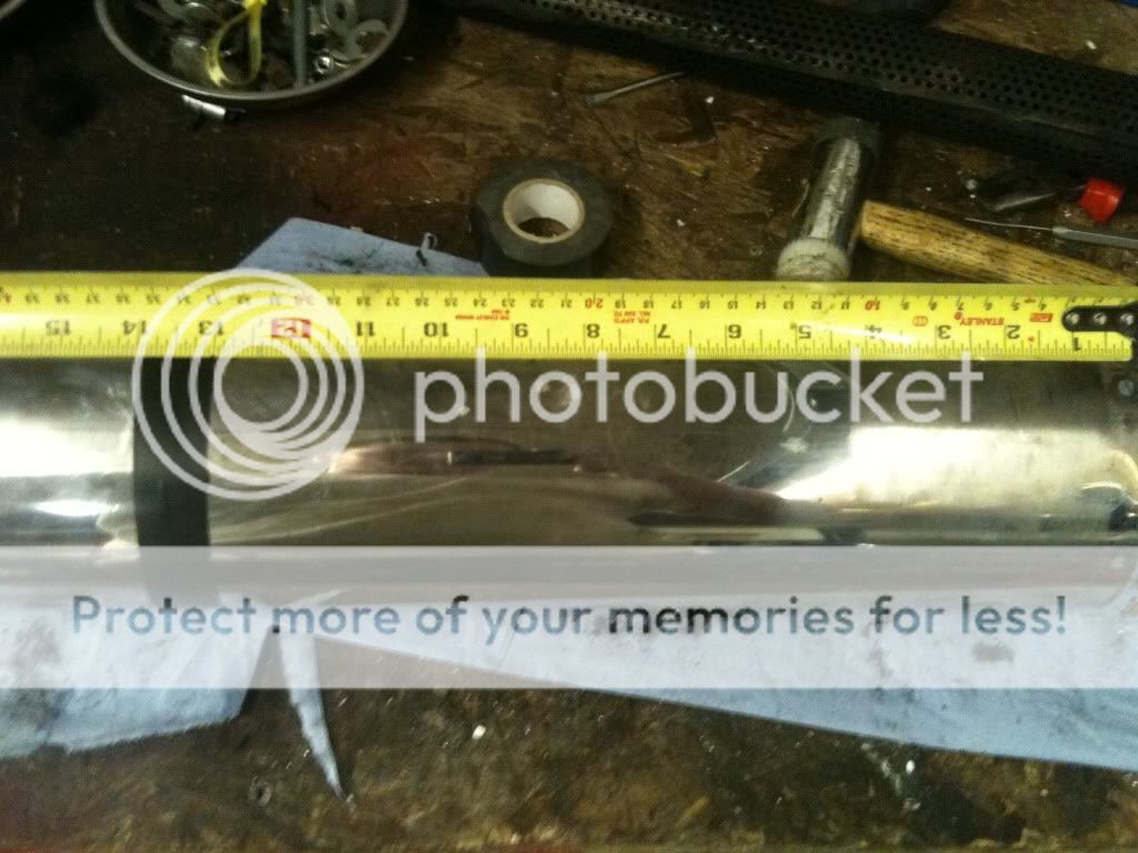

Mark how much i want to cut off, I want 13" so mark it all around with a sharpie then tape to get a half decent line. Making sure to measure 3 time just to check. Thumbs Up
https://i770.photobucket.com/albums/xx346/ThatHornet/2e773f41.jpg

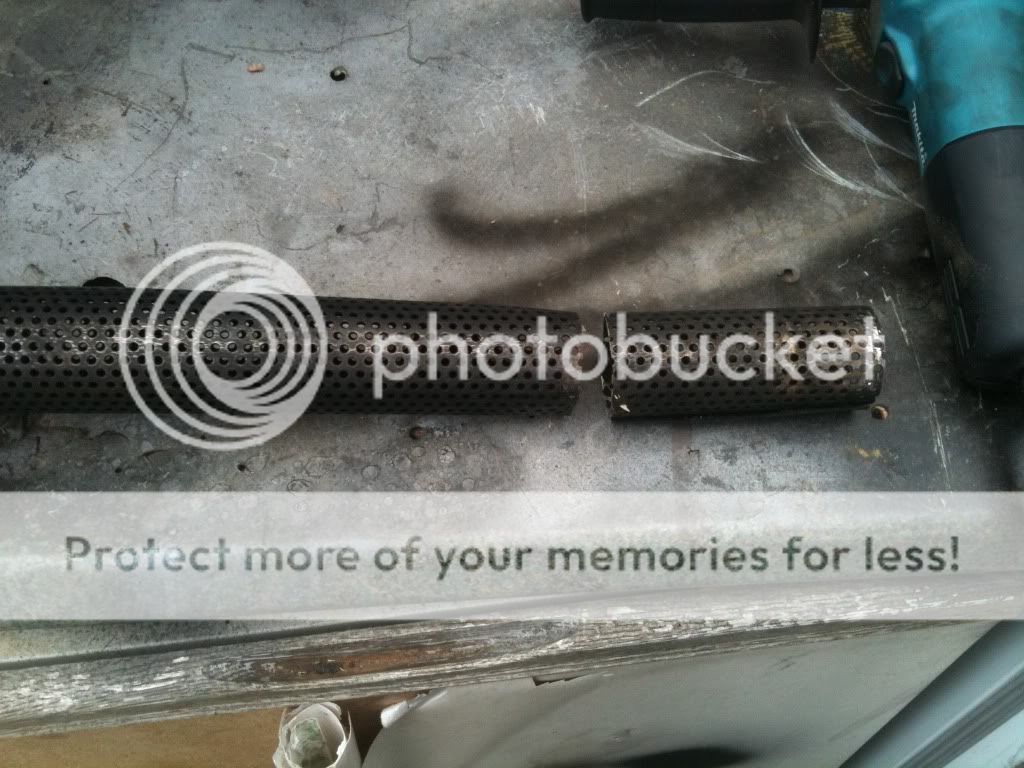

Cut with a mini grinder with a very fine blade.
https://i770.photobucket.com/albums/xx346/ThatHornet/e5f5f1db.jpg
Then cut the baffle to match.

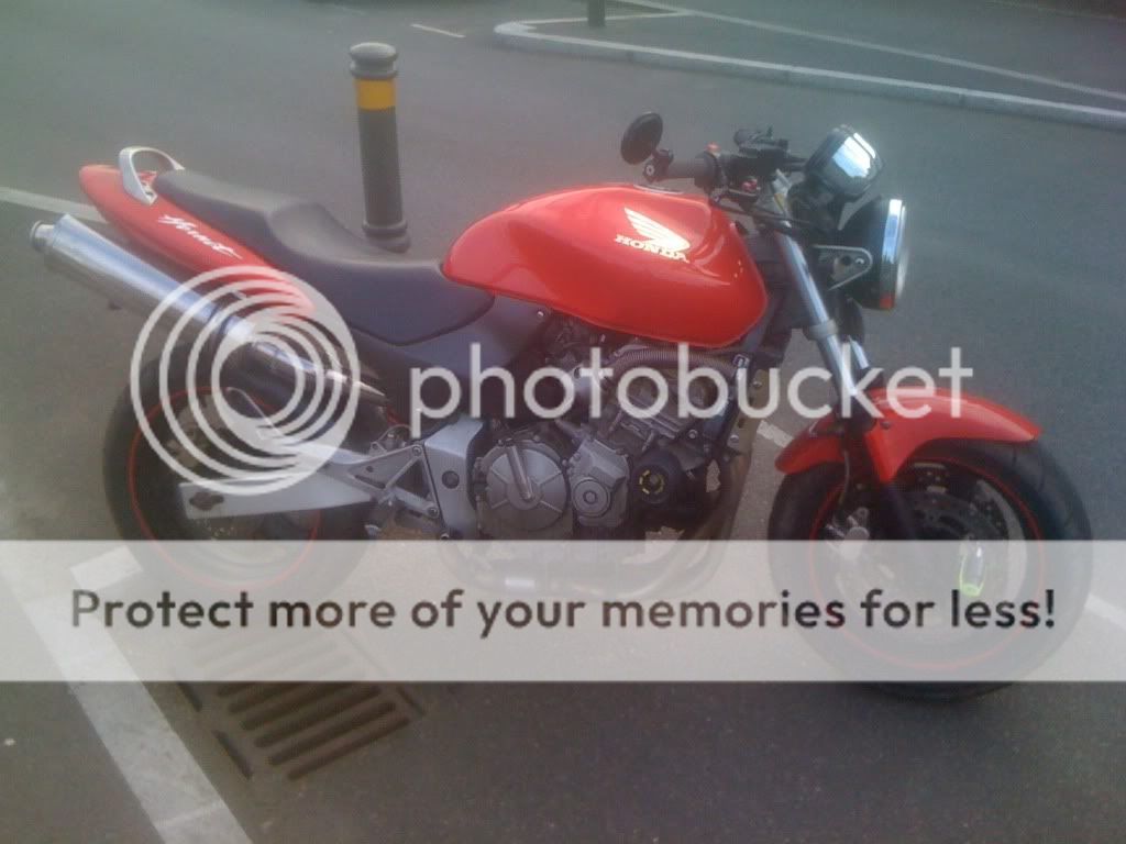

All back together and waiting to fit. Should look much better.
https://i770.photobucket.com/albums/xx346/ThatHornet/7caf1585.jpg
All in it didn't take too long, about 3 hours with tea brakes and talking to friends who came over to drop stuff off. And with no prior riveting experience i think i did quite well.

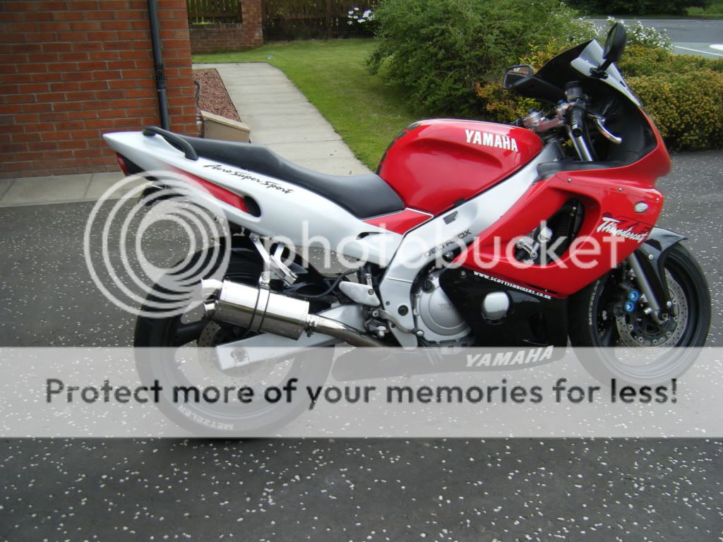

sweet! stubbys look great on hornets Smile#
this is what mine looked like
https://i281.photobucket.com/albums/kk229/ShoKzjA/snippit.jpg
and now one on my thundercat
https://i281.photobucket.com/albums/kk229/ShoKzjA/DSCF0822.jpg
Stubby exhausts ftw

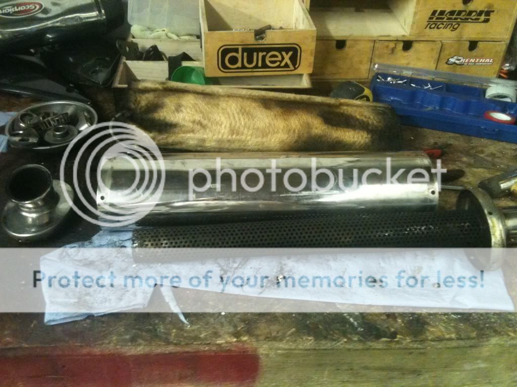

Good job. Did you purposely focus the camera on "Durex" or was it an accident Laughing
Current Bike - 2013 Triumph Daytona 675R
That_Hornet
Joined: 23 Apr 2009
PostPosted: 19:16 - 20 Jun 2010    Post subject: Reply with quote
Part of a sticker kit from ages ago. lol
Their all over the place. Mr. Green Thumbs Up

Looks good. Could you give some tips on how to take the rivets out as i need to repack my can.
Cheers.
Carlos.
That_Hornet
Joined: 23 Apr 2009
PostPosted: 21:17 - 20 Jun 2010    Post subject: Reply with quote
I used bosh drill bits and a 12v cordless and drilled out the middle. Then if theres a bit still left in, I punched it out with a punch. Thumbs Up
