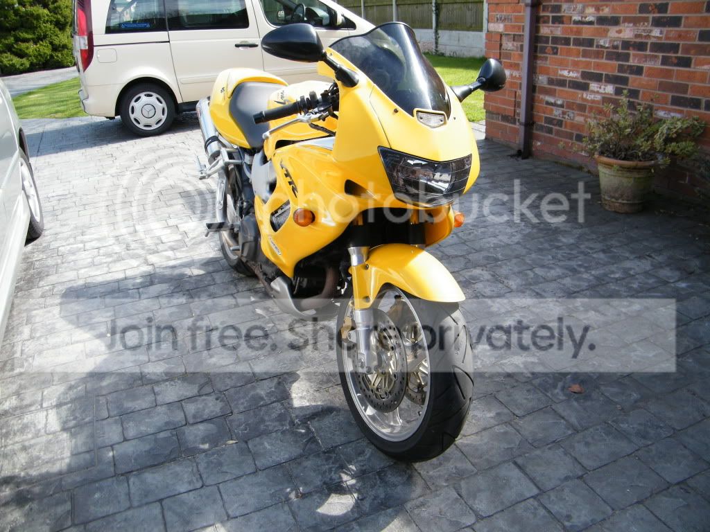

https://i907.photobucket.com/albums/ac278/IXITUGIXI/DSCF0051.jpg
https://i907.photobucket.com/albums/ac278/IXITUGIXI/DSCF0055.jpg
I jizzed.... alot. Laughing

nice Thumbs Up

Best make a list of petrol stations every 90 or so miles Laughing

So i've been told! Laughing I think the fuelling on this one needs some attention, he was telling me one can is blacker than the other like its running rich, shouldnt be a problem for me, like to think of carbs as my 'nack'.

nice Thumbs Up

Gorgeous. Dream bike that is and love the colour!

Looking good. Thumbs Up
Nice colour. Very Happy

Well today i noticed it was not running right and my ears were confirmed correct by my mates Ste and Mich saying "oooo nice VTR500", Yep thats right sports fans! Upon closer inspection found the front cylinder running 50% cooler than the rear one, so that in mind removed the plug to find it was coked up and the plug cap was broken, then the mixture screws were out, out of balance and the choke plunger on the front carb seized. Laughing
All fixed now, but as of yet i need, a honda plug cap, and cush drives.
Could do with a service soon too, hmmmm.
