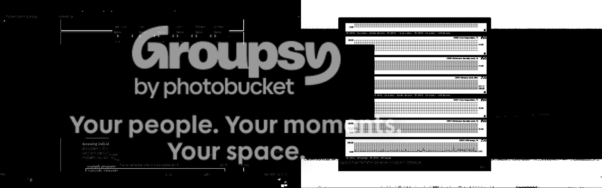

Tried taking screenshots but they were all scrambled like below.
It shut off AVG and my web browsers but I was still able to run Spybot to get rid of some of it and return the computer to almost regular functionality.
I also suspended the process ave.exe which stopped the defender pro popups, false alarms and stopped browsers crashing.
Ran ComboFix, it deleted some stuff.
Malwarebytes detected and deleted some adware and a trojan.
Registry Keys Infected:
HKEY_CLASSES_ROOT\dlp.dlpobj (Adware.WebDir) -> Quarantined and deleted successfully.
HKEY_CLASSES_ROOT\dlp.dlpobj.1 (Adware.WebDir) -> Quarantined and deleted successfully.
HKEY_CLASSES_ROOT\Interface\{b1e22eb8-2ae8-4e8e-96ae-74f2a1764533} (Adware.WebDir) -> Quarantined and deleted successfully.
HKEY_CLASSES_ROOT\Typelib\{bdbebf18-7615-4971-9ac3-bd6ffb7ad6c1} (Adware.WebDir) -> Quarantined and deleted successfully.
HKEY_CLASSES_ROOT\AppID\{bdbebf18-7615-4971-9ac3-bd6ffb7ad6c1} (Adware.WebDir) -> Quarantined and deleted successfully.
HKEY_CLASSES_ROOT\AppID\DLP.DLL (Trojan.BHO) -> Quarantined and deleted successfully.
AVG detected another Rootkit omlvhiel which I have no doubt is a randomly generated name.
I recommend you update and scan everything.
https://img.photobucket.com/albums/v612/SoND/XPSecurityToolHax.jpg
