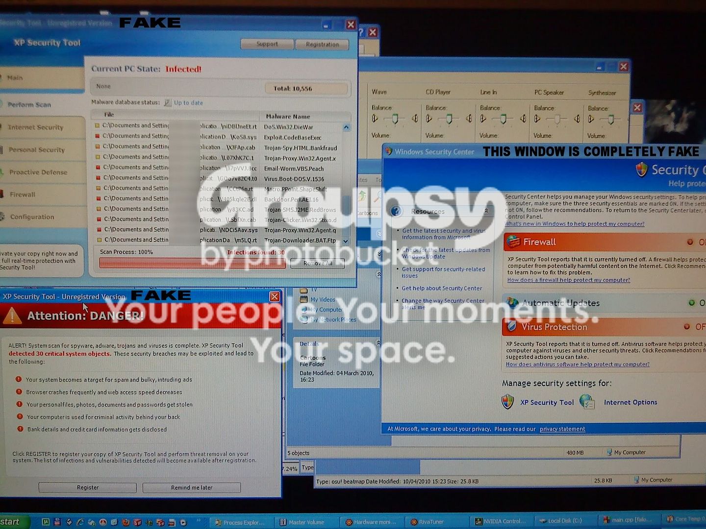

All hell has broke loose. Notice the very convincing Windows Security Alert window, it's fake. My settings are not set like that so it stands out but apart from that it's almost impossible to tell the difference from the legit window.
https://img.photobucket.com/albums/v612/SoND/VUNDO1.jpg

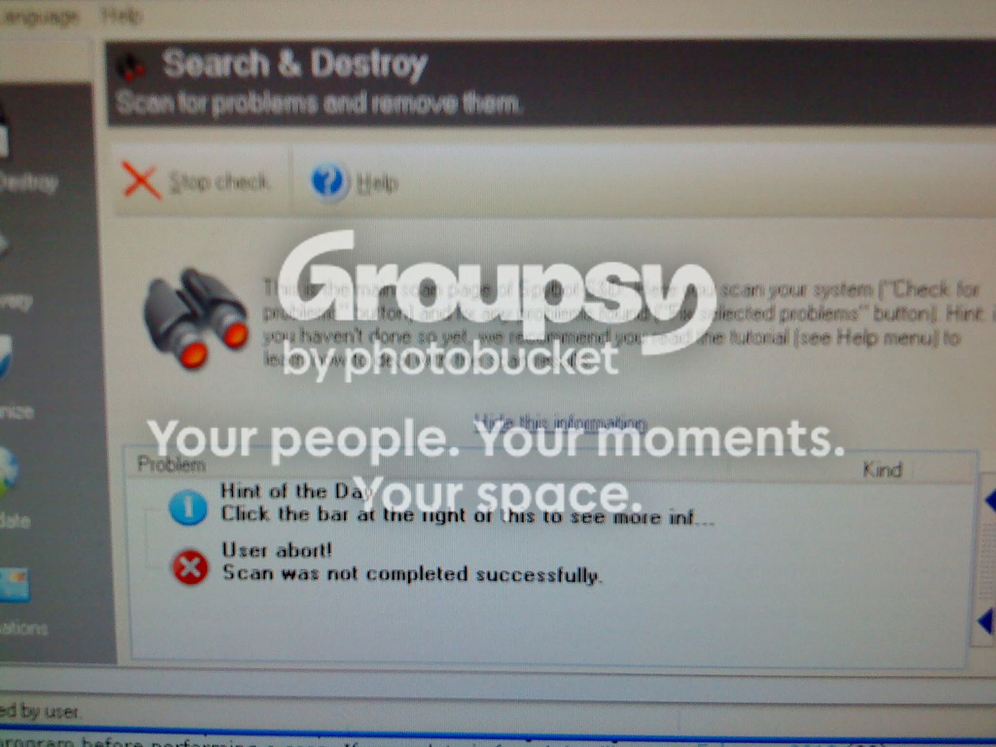

Sometimes you will be able to start a scan but it is able to abort it on you. Where Spybot failed AVG was able to catch it. It ground the computer to near a halt while scanning, almost looking like it was froze at points. Best not to touch anything while it's working.
https://img.photobucket.com/albums/v612/SoND/ABORTION.jpg
Successful Spybot run
https://img.photobucket.com/albums/v612/SoND/SPYBOT.jpg

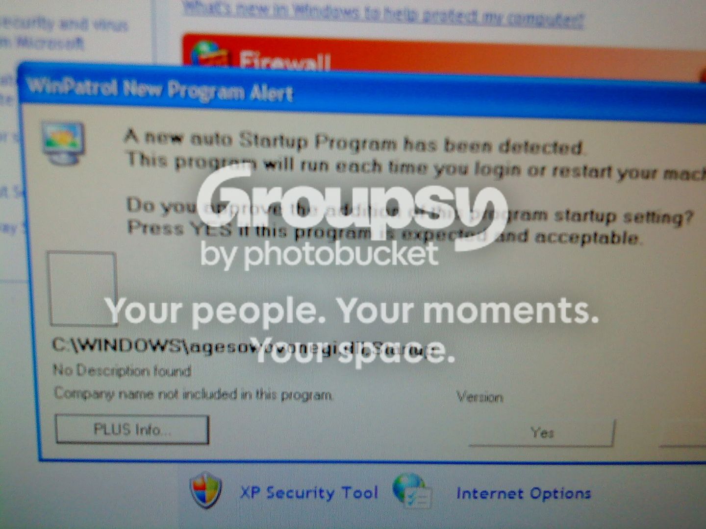

It's trying to get into my startup. Always say no.
https://img.photobucket.com/albums/v612/SoND/STARTUPALERT.jpg

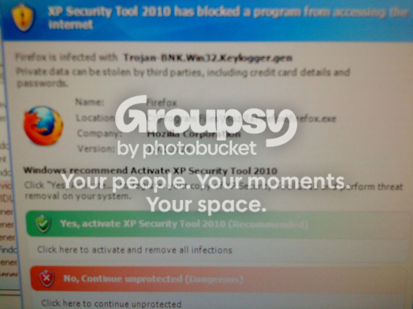

False alert when trying to open firefox. I closed the process (ave.exe) rather than touching any of the buttons it provided and tried a different browser, it could be trying to do anything here.
https://img.photobucket.com/albums/v612/SoND/FIREFOX.jpg
